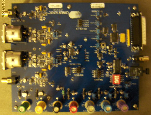

what do you think of CS8416 and CS4398, used in Chinese DAC, eg DAC in box?
Personally I prefer the cs4398, it's a higher performing chip. The actual implementation makes a big diffrence. Design short-cuts for price reasons and PCB layout makes a hugh difference. Just the layout alone can make a great chip sound average. All of the Chinese DAC's I've heard are not the best implementations. Again this is my personal experience.
If you're into DIY and really like the CS4398, consider getting a Cirrus cs4398 eval board.
Below is a pic of my cs4398 eval board. Just add the required PSU's.
-David
