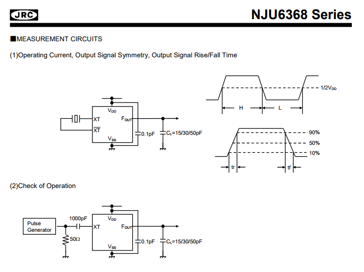

http://www.njr.com/semicon/PDF/NJU6368series_E.pdfI never tried this, but I've seen some design based on NJU6368. I guess you may be interested.
The NJU6368 is an interesting part. It's "Oscillation Capacitors" Cg and Cg and load resistor are on-die. With the TI driver, these passives have to be added by user.
The TI driver's datasheet has an original copyright date of 2004. So it has been around a while.
Unfortunately, both the NJR and TI parts are SOT23 size. Too small to work with w/o an adapter (or custom PCB, if you want to go that far!).
External passives are likely to be better quality than on-chip devices. The design aim of that device is small size and convenience. This is implied by the fact that the datasheet makes no mention at all of oscillator quality (e.g. stability, noise, jitter).
