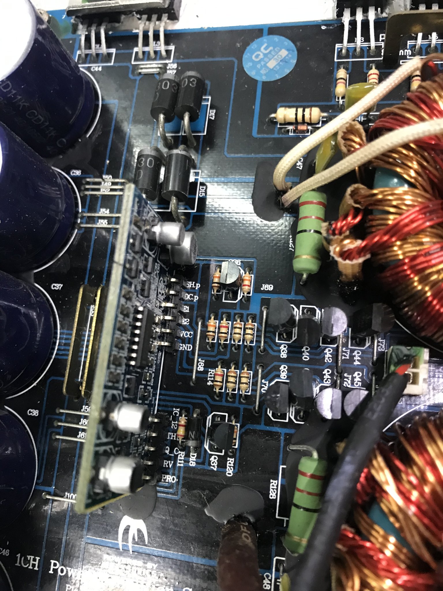

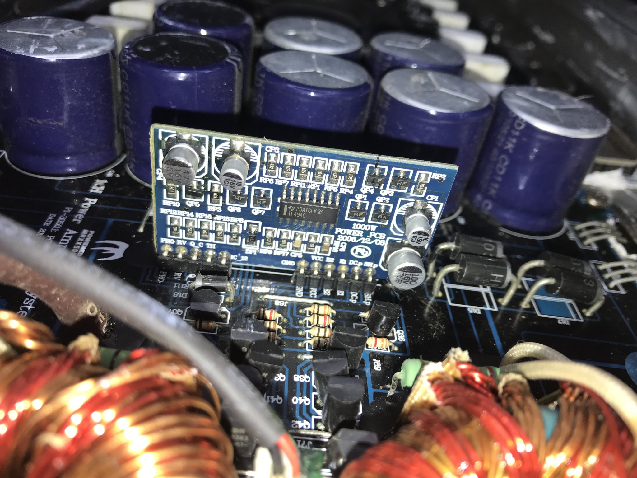

When the amp powers up, will it play normally up to full power?
How long do you have to leave the amp powered down before it will power up again?
Which terminals of the TL494 have significantly different voltage when the amp powers up and when it won't power up (remote applied)?
