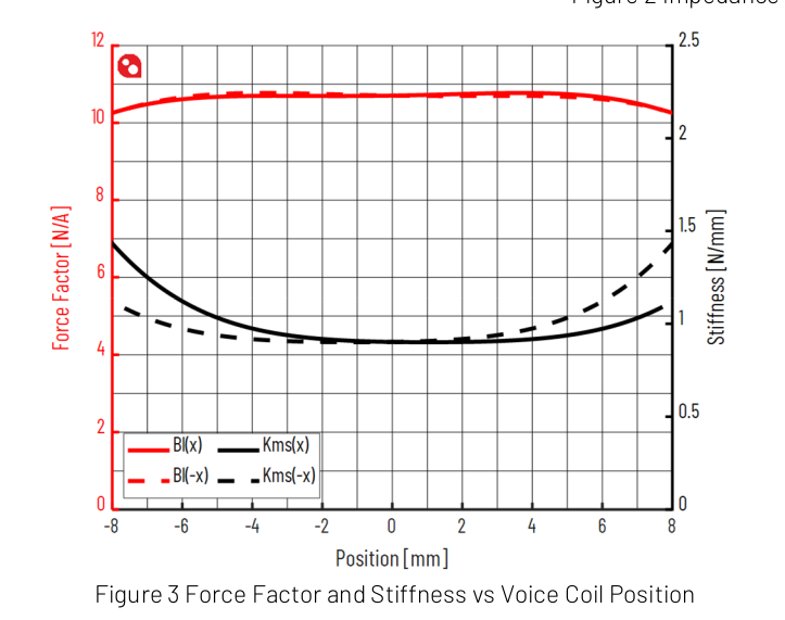

Where to find drivers like this Beyma 5M30?

Looks like I was wrong in comparing the 5m30 with wf146.

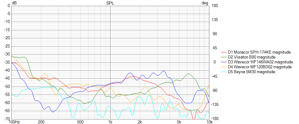

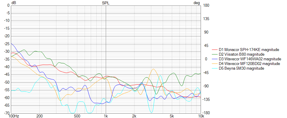

All these number and graphs in different styles are difficult to interpret correctly. As can be seen in the following diagrams, I've tried to put some of those mids together using
a) old K+T measurements for the monacor, the wf146 and the visaton. The data was given as linear percentages for 85dB and 95dB, which I mixed using VirtuixCad calculation tool's average function (appeared like it was a dB-average, but not yet sure)
b) a current hooby-hifi measurement for the mr120
c) the beyma datasheet already linked above using the finite volume standard backcap result
All using the SPL reading tool from virtuixCad, which required a lot of manual correction, and since I'm new to using that tool, expect a lot of bugs!
Given that the clear winner in those HD diagram is the Beyma, which seems to be out of production, or isn't mentioned on the Beyma website, I searched hifi-compass for similar distortion class speakers.
