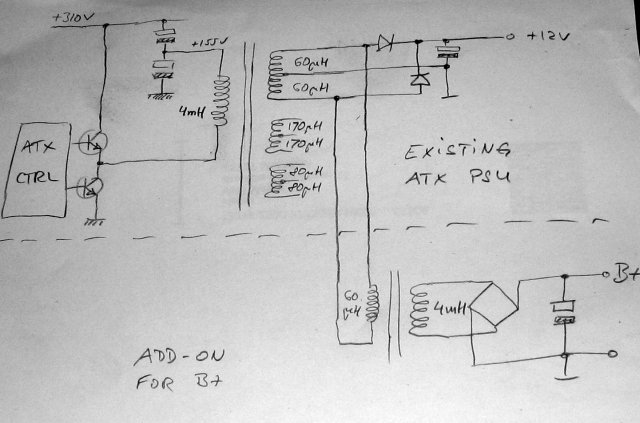

I measured one of the salvaged transformers for inductance and came up with 4mH on the primary and 60uH center tapped for 12v secondary (170uH for 5v).
This is about consistent with what I found here: http://danyk.cz/s_atx01u.png.
Assuming I connected an identical transformer backwards like in the attached drawing I should be back to 300v ... or maybe not ?
The turns ratio is sqrt(4000uH/60uH) = 8 which may not be enough.
This is why I connect across the center tap of the 12v output.
Before I try that I would appreciate some opinion whether it is worth doing and whether there might be any adverse effects on the PSU itself ?

Please don't forget the half bridge configuration of the primary side of the power transformer. This means that the voltage across it is, at it's best, 300 Vpp! So you'll need a voltage doubler.
Best regards!
I didn't. Thats why I connected the additional trafo across both halves of the original center tapped.
4mH -> 120uH (60+60) -> 60uH -> 4mH . I guess thats a doubler in winding ratios already. Actually I would be happy with 250v.

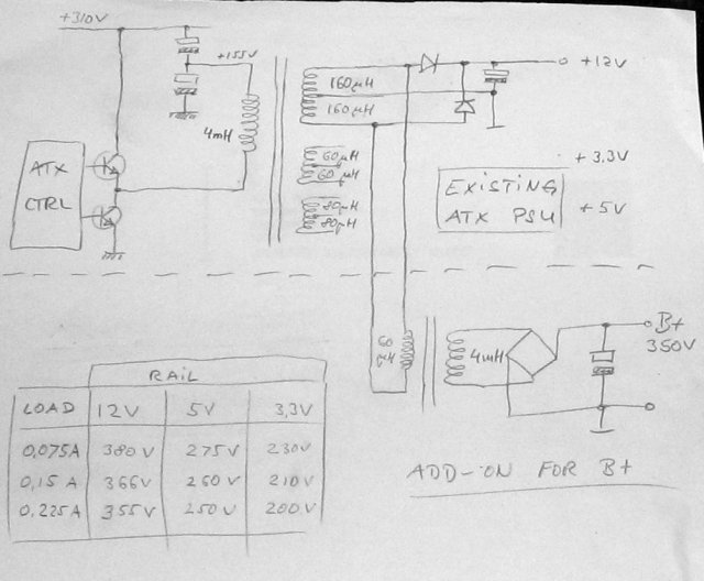

Did the experiment today - it works ! surprisingly well !
355 V @ 225 mA / 80 W when hooked up to the 12V AC rail
and regulation is not poor either, 366v @ 150mA, 380v @ 75mA
other voltages are also possible, 250v on the 5V rail, 200v on the 3.3v rail
I'd call that a success ... 🙂
Another good thing: the B+ can be floating and who says I cannot hook up 4 transformers for the 4 floating PSs for a classic circlotron 😉

So, without even touching the primary side of the PSU this simple add-on to the secondary side works ! surprisingly well !
and regulation is not so poor as I expected either, 366v @ 150mA, 380v @ 75mA

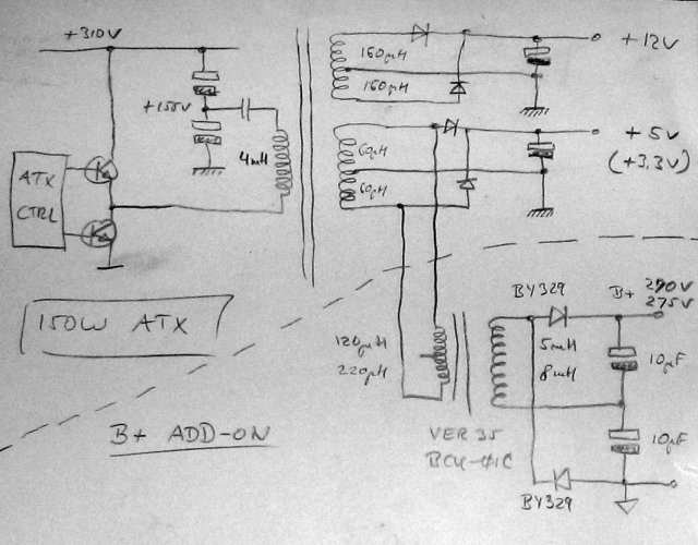

Add-on to produce B+ voltage for tube from PC ATX PSU secondary
there were a couple of small problems which are fixed now, I think
my target is more like 250V and there was unnecessary heat produced in trafo and diodes
Preliminary final status:
- additional transformer hooked up to 5V secondary AC rail now
- used more of the windings available on the additional trafo
- which requires simple 2-diode doubler to get the target voltage
- tested with two slightly different trafos
- both run simultaneously currently producing 275v and 265v at 120mA each (65W total)
two words of caution though:
although this method is only dealing with the secondary isolated part of the PSU there are life parts in the box which must not be touched nor modified !
the temperature sensor for the PSU fan is usually attached to the heat spreader of the rectifiers which are the hottest spot under normal use; since the power for the add-on is taken from the secondary AC side of the PSU, it does not run thru these rectifier diodes; they stay cold therefore; the power switch transistors however do get hot depending on power drawn but they usually don't have a sensor; which means that the fan speed would not be adequate to sufficiently cool the switches; because the switches are on the mains life side, one cannot safely move the sensors to the heat spreader of these switchers;
so it is required to find a better albeit safe place for the sensor or wire the fan directly to the 12v rail so that it stays permanently on !
