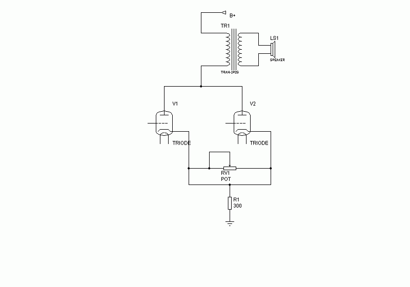

In fact there are several resistive ways to do this:
G must decide whether all the cathode resistance is to be bypassed. Not bypassing even a small amount of resistance will cause a considerable increase in Ra. This will lead to higher distortion, which will only be partly offset by the small amount of feedback produced by the cathode degenerative process.
To achieve this, it is probably best to split the cathode bypass cap into 2 parts.
Of course if the design calls for some unbypassed resistance, then the designer has probably taken this into account.

pros and cons
Nice thought G. As the tubes age, and they seem to age differently, one could balance the tubes. This would only be a static balance, but maybe better than nothing. With only one resistor, the value is half of that used if two resistors were used (and no balancing pot). This will keep Ra down.
On the other hand, the concept of two tubes would mean twice the output capacitance (and input capacitance). Be interesting to see how the extra capacitance would affect HF response, and any resonance problems with the OPT and with the driver tube response.
10 ohm or even 1 ohm resistors are good for measuring individual tubes. One could argue they will affect sonics, so I would be careful what brand you use.
Hi Steve,
The driver for these two tubes would be running at about 20mA so I don't think the extra input capacitance would be too much of a problem but my footing is not too firm with those calculations yet so that is not a definative answer. This is probably going to be one of those "let's build it and see what happens" projects that probably won't take place for some time. I'm just in the planning stages. Thanks for the input.
G
G
