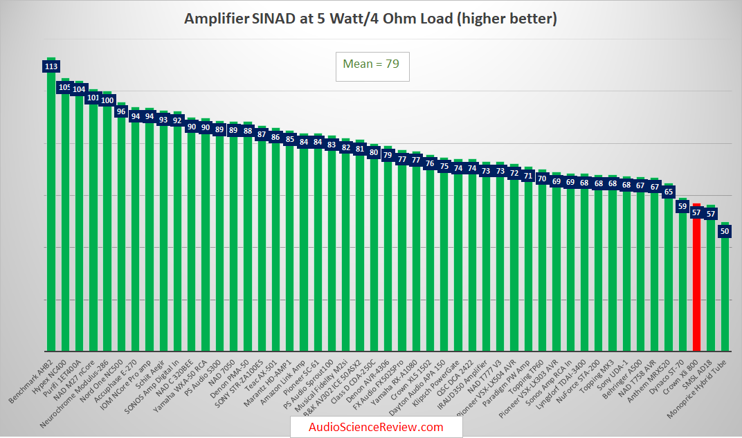

Yes the XLi 800 is good for sub amp but it's distortion gets worse with higher frequencies. I have seen some videos etc and the little more expensive Crown XLS 1502 and it's smaller sibling the 1002 rate highly for home use with much lower distortion
The 1502 has less distortion than the Pioneer, NAD and Klipsch amps tested (see pic just below midway on graph). Although in this review it still says it is not suitable for HI Fi because of bandwidth and resolution. I don't understand what that means.
