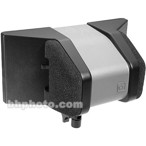

If I'm not mistaken aren't cardiods typically used for ORTF and wide separation with omnis? MA recordings for a commercial example. An exception is when the mic array itself provides acoustic shadowing, a good example Crown's PZM based SASS system.

Both the ORTF technique using cardioid mics and the Crown SASS stereo mic make use of the amplitude difference between channels in addition to arrival time difference to establish the stereo image. My recording only uses the arrival time difference, as the PZM mics are omnis.

While ORTF does leverage spacing amplitude differences it's greatly augmented by the falling off axis amplitude of a cardiod, not available with omnis. The Crown SASS gets around this by using omni elements in a housing that modifies their directivity as frequency rises to partially emulate a human head as per spec sheet below.

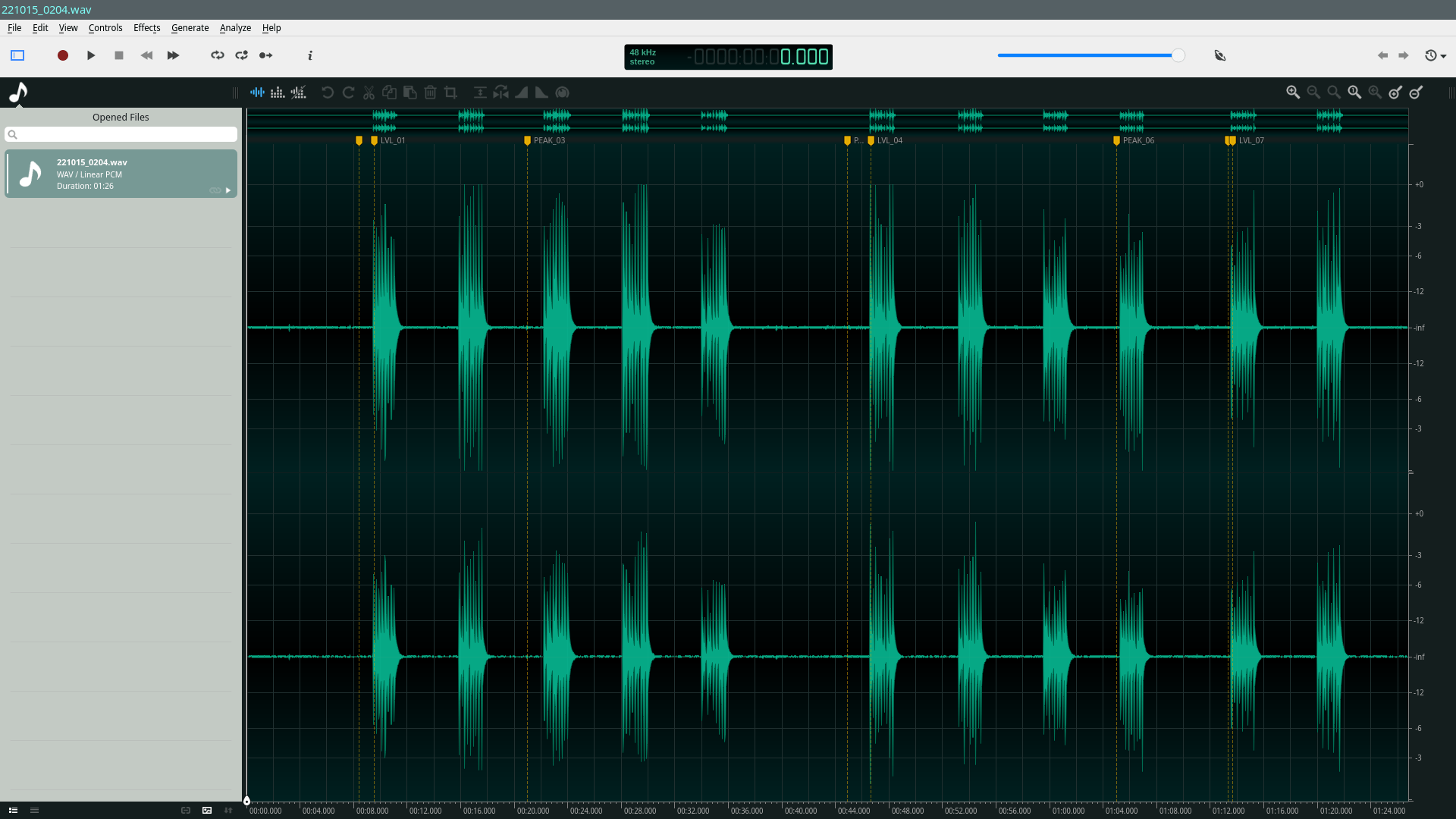

Initially the same behaviour on my speakers. The drum had no sense of being right of centre until reflections behind the listening position were suppressed with window blinds. It was still subtle. The inter-channel amplitude variations are minimal.

Thanks for showing us that the amplitude between the two channels in the test clip are very close.
But I was referring to my own speakers having different acoustic output when driven by the same signal. I can go back to using the analog feed into them and drive that with a preamp that has a balance control.
I can also bring the speakers outdoors and play the same clip. If that still doesn't work, then it'll be an interesting thing to report for sure.
