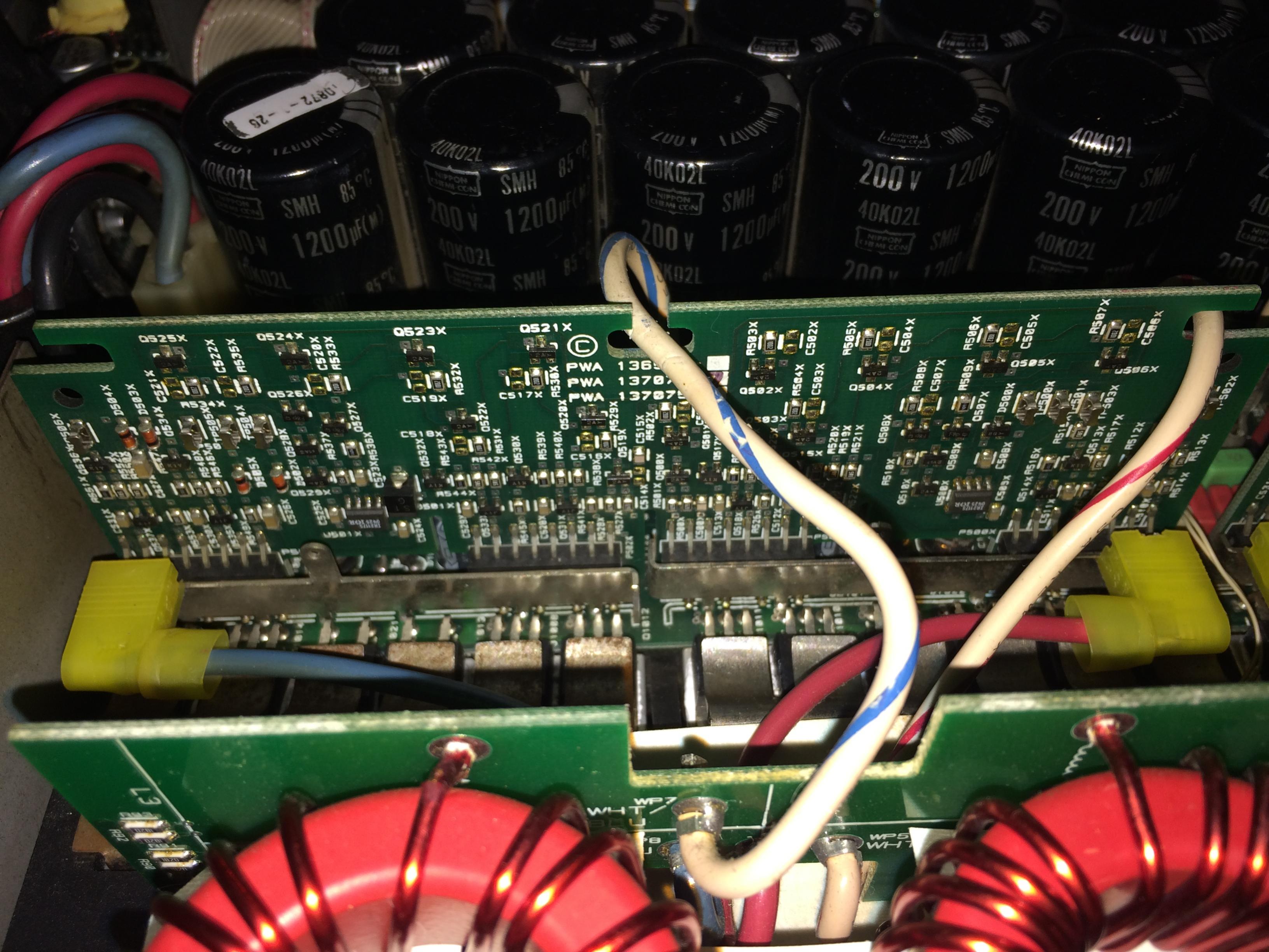

The gate drive is the old one with ceramics. I attached a picture bellow. You think I should try to update it and replace the ceramics with some good polypropylene?

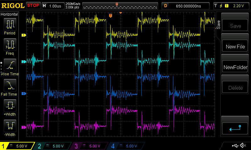

Checked all power diodes and are good. Measured the output of front-end modulators and to me looks ok. (attached pic bellow. oscilloscope channel order is the following: CH1 - VP + DRV | | CH2 - VP - DRV | | CH3 - VN + DRV | | CH4 - VN - DRV)

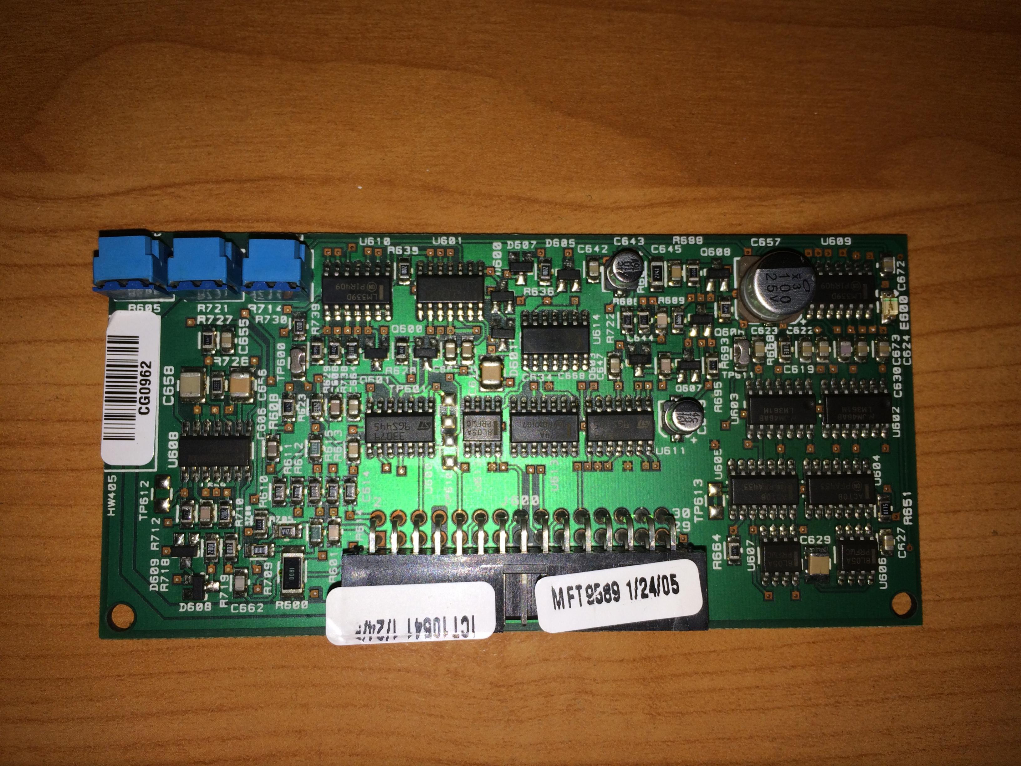

@Tom the front-end is the PCB in photo bellow. It handles modulation, feedback, DC detect, I monitor, IOC, temp monitoring
