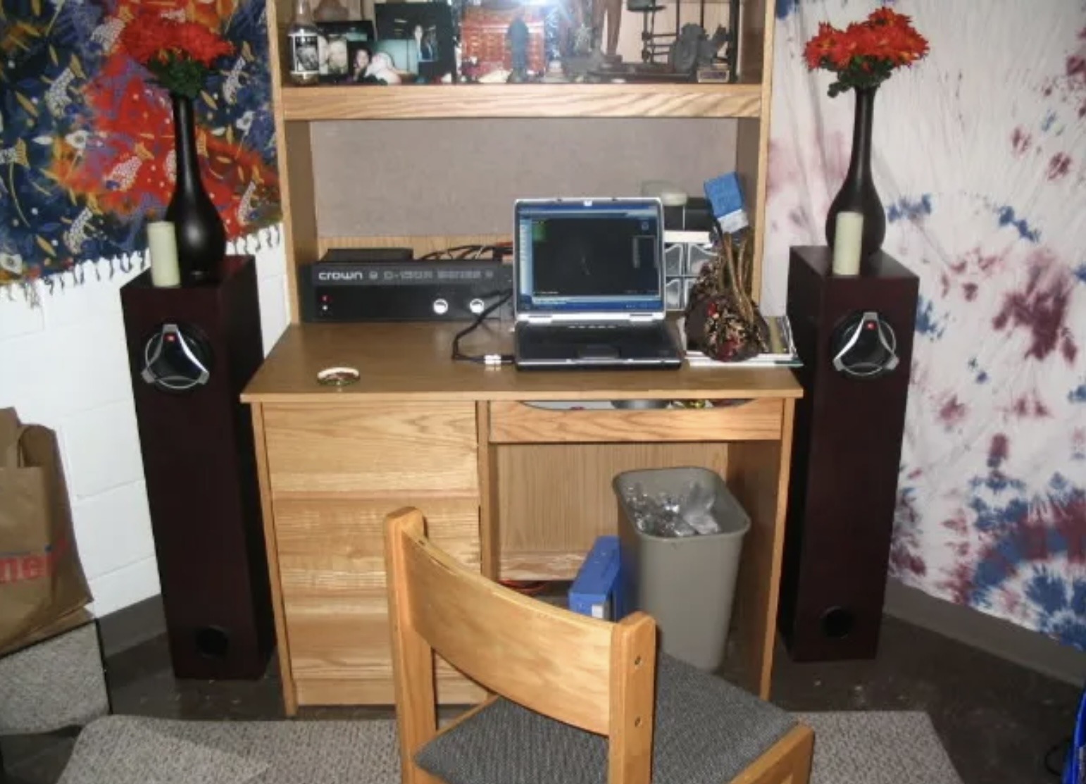

I have been a hardware developer for a lifetime and my impression from professional repair guys is that their knowledge often is quite limited so they do not understand all the details of the circuits they try ro repair. (Anatech excluded whom I think is really competent). But the vast majority has some experience, are unwilling to learn more and without deep insight things are fixed in a poor manner. And this is independent of the equipment they use. My point is that you need a ton of knowledge and this enables you to fix appropriately without a ton of sophisticated equipment.
this is not technical, but my daughter and I built these speakers for her dorm room when she went off to college. If you notice, they are driven by your same amp. It sounded great.
