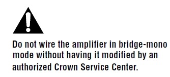

Look at the schematic! Bridging is done with a resistor and jumper from the ch1 output to the power amp negative feedback on ch2. The XLR input has NOTHING to do with bridging. The ch2 input MUST be unconnected for bridging.
Granted, if you do not set the internal bridging jumper, you could drive ch2 inverted using the XLR inputs.
