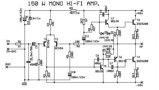

Ua739 is NOT a standard op-amp. It is an old design that used external compensation, in this case tuned to be part of the power-amp. An op-amp like 5532 has internal compensation designed for unity gain by itself, and not well suited to be part of a power amp. It may be possible to modify the circuit to work with 5532 etc, but expect to fight with stability problems. This is an old question. See https://www.diyaudio.com/community/threads/ua739-op-amp-replacement.86796/

Power rails are +-45 vdc. There is no DC on speaker protection, and there are output offset pots which are a known failure point if the pot wiper loses contact. I'd salvage the power supply heat sinks & fan, ditch the boards. There appear to be a single pair of output transistors quasicomp. The schematic says the crown has motorola 2n5631 outputs which was really along time ago.
Diyaudio honeybadger is +-60. Those boards are kind of big even if it would work. Triple parallel output transistors.
Single IC amp ST TDA7294 could work. See if you can buy it with a board. Specified for maximum +- 50 vdc.
Here is a quasicomp 2sc5200 single output amp schematic somebody posted years ago. You already have the output transistors on the heatsink. Don't believe the 150 w title out of a pair of 2sc5200. For 10 seconds maybe. The crown already has the output inductor parallel a 2 w resistor to keep AM/CB/police/fire radio from feeding back from the speaker wires. The 2sc5200 schematic doesn't have speaker ringing back diodes across the output transistors, add them. No, 1n4148 and 1n4003 aren't big enough. Use 3 amp or bigger anti-ring diodes.
