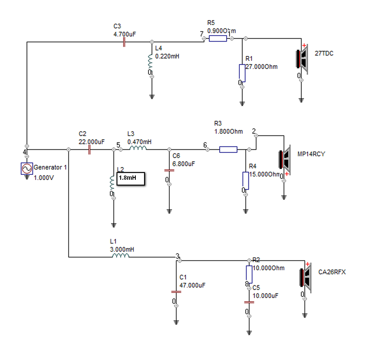

Ok. What would really help me out is this
If somebody could circle out and label for me which parts are the impedence correction circets, that would be a good start for my ground up design. as the drivers are the same and the tweeter re is the same, this will save me alot of time working that bt out.
marking the parts that alter the xover frequencys would also be useful. even more ideally a labeled diagram explaining each part would be perfect for a newbie such as myself....
here is the origional scemetic , feel free to draw on it so i know whats what. thanks
Thanks for that information Sreten.
The xover was from a project with the same drivers as mine, with simular tweeter, as formentioned. i think t was a german builder, he had a build thread on a german site, and im sure he also posted his final project on here. i am trying hard to find it now
been googling round in circles for a hour or so. cannot find it anywhere, have to rethink this.

See the FRDtools links in the list I posted for alternative tools.
There are several descriptions of using them effectively in the links.
I don't know boxsim, but with the right drivers files it should work.
Poor Man' is worth looking at.
The way to be confident with a simulator is simulate a well documented
design, e.g. one of Zaphs designs and get your results to agree with it.
You can't use that 3-way calculator, if you read the above
you will realise what a dreadfully misleading useless tool it is.
rgds, sreten.

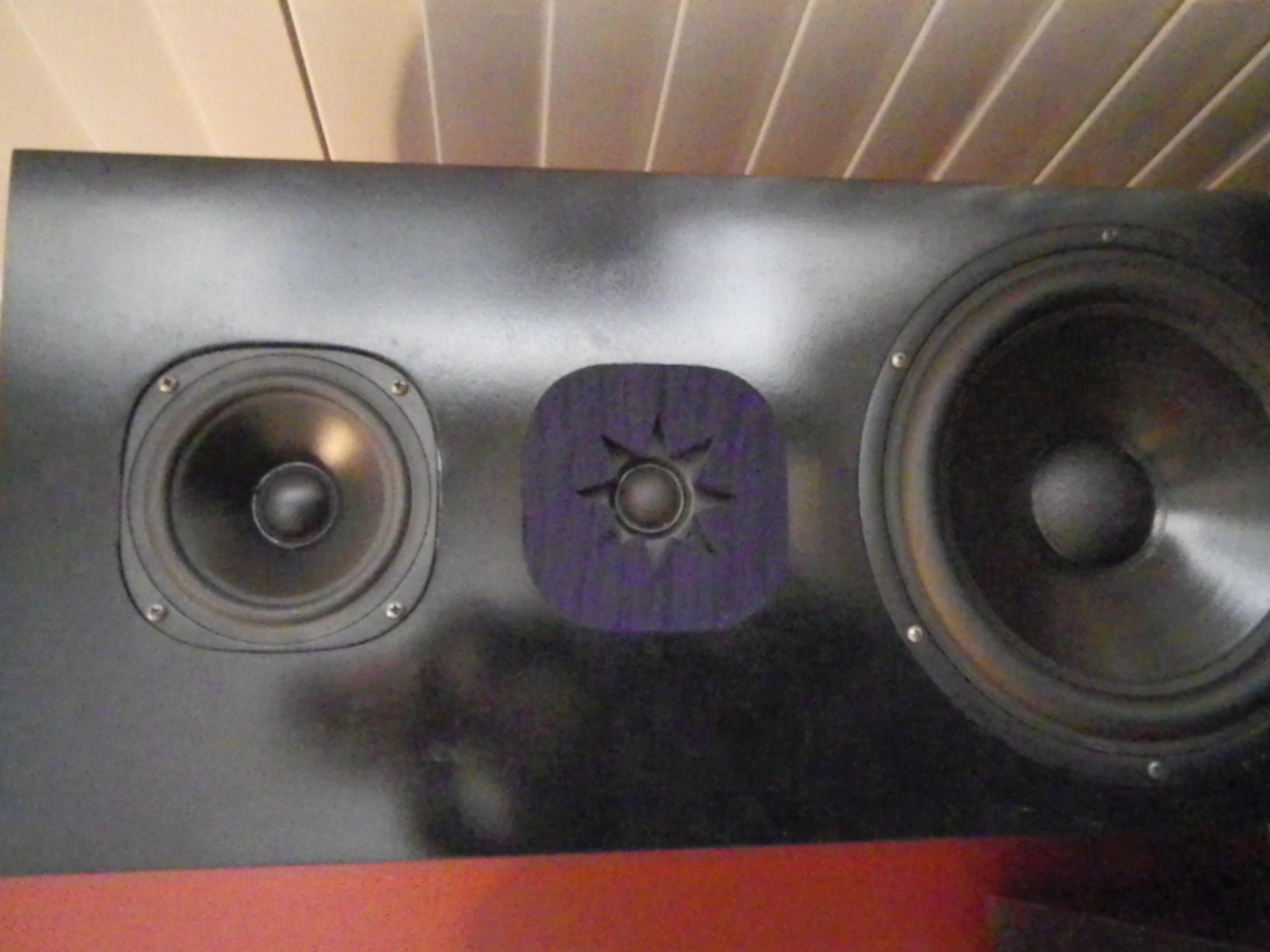

Hi Waveinform
I've made some 3way seas speakers before as well. using 27tdc, mp14rcy mid and ca26rfx bass drivers. The midrange is an older type with rounded corners but I think the crossover may be of help still. I have padded the mid and treble a little as I like a little more bass trailing off slightly as it gets into the higher frequencies.
Regards
Simon

here is my "schemetic"..
the parts shown in green are a possably and will be attatched to the sides of the mid/tweeter boxes, and will be anguler or curved.
so the baffle will be slight slimmer than the pms, the distance between mid and twee will be close to the same. and the distance between woofer and mid will be slightly less, but as its a larger driver, this is marginal.
drivers distances. tweetr mid gap 25mm approx. mid cassis to top of woofer cassis 10cm approx (by eye). if you need me to be more accurate i can draw a proper schemetic
my testing showed the tweeter to need more attuention than 2db, and the mid sounded fine as it was, but i would like to have the parts to hand to experement.
which resisters in the diagram are the ones i would need to alter the values of to altar attuetion? i want to be able to easly play with the attuention amounts with my test crossover
is a varable resister (lpad) a viable option? as levels seem to change atot depending on room and listening distance
OK your baffle should not have major diffraction issues.
As I remember this schematic does not work well with LPAD 😱
You should increase/decrease the value of R1011 ... You can go as high as 6.8 ohms with R1011 to adjust the tweeter level.
Be careful with the BR box of the CA26, it must be correctly tune.
