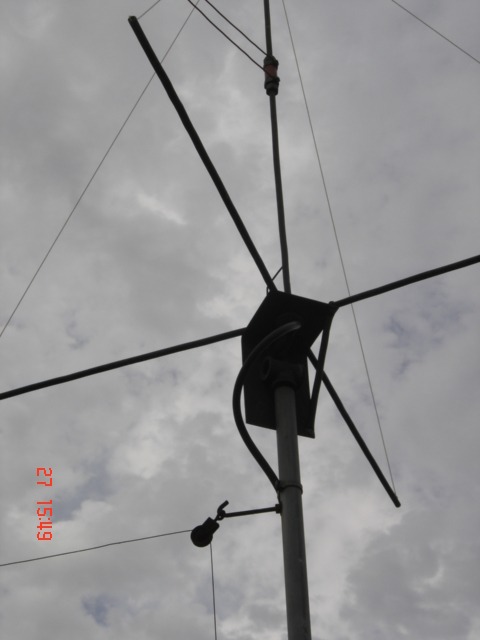

In a wire, Eddy currents (and eventually proxi effect) are surface related effects that restrict the main current flow to the surface of the wire. If the oxide layer is mediocre conductor (there was copper oxide rectifiers used in VOM's) and copper oxide isn't progressive as iron oxide does, once the oxide layer is stablished, it doesn't future upgrade. Thus current will tend to flow in the immediate vicinity of the interface between copper and oxide, but as copper has less DCR, the main flow will be in the copper side.
If your theory was correct, thus power lines with oxidized wires and heavy currents in them, must create still more distortion of the per se distorted AC wave. Similarly my ham radio aerials made of copper tubbing must be a big source of interferences to any kind and in fact I didn't received any alarm from neighbours. And they operate at 5W @150MHz where Eddy are much more pronounced than in audio freq.
Nobody said anything about a big source of distortion, nor said that the net effect is some kind of distortion. To the contrary, if there are many small and relatively independent distorters then the central limit theorem might suggest that some kind of low-level yet in some cases audible signal-correlated excess-noise could be the result.

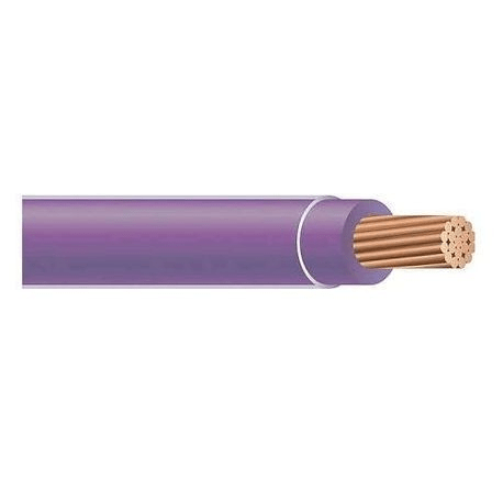

The wire I use for internal speaker cabinet wiring is multi-strand THHN wire
The strands are thicker /fewer than multistrand machine tool wire or appliance cord wire. This makes it easier to route the wire inside the cabinet, and I can bend the wire into a shape and it will hold the shape. But it is not so stiff that it puts a lot of load on the speaker terminals (like solid core wire). The biggest negative sound impact of wire is a rattling wire inside a cabinet... not saying there are not other negative sonic impacts, but if you have a rattling wires any time 75-80 Hz signal content is present, nothing else really matters.
I find that very fine strand wire is hard to work with.
