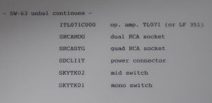

Chaps,
I have a crossover which is around 25 years old, it cannot be retrofitted to current models. I was thinking of upgrading it. It has a TL071 op amp and I think that the Opa 134 is a better sounding op amp. It is also possible that the electrolytic caps are loosing value after all these years so it would be worth checking and replacing them. Maybe even a bit higher values.
I wonder what else should be replaced.
Any suggestions?
