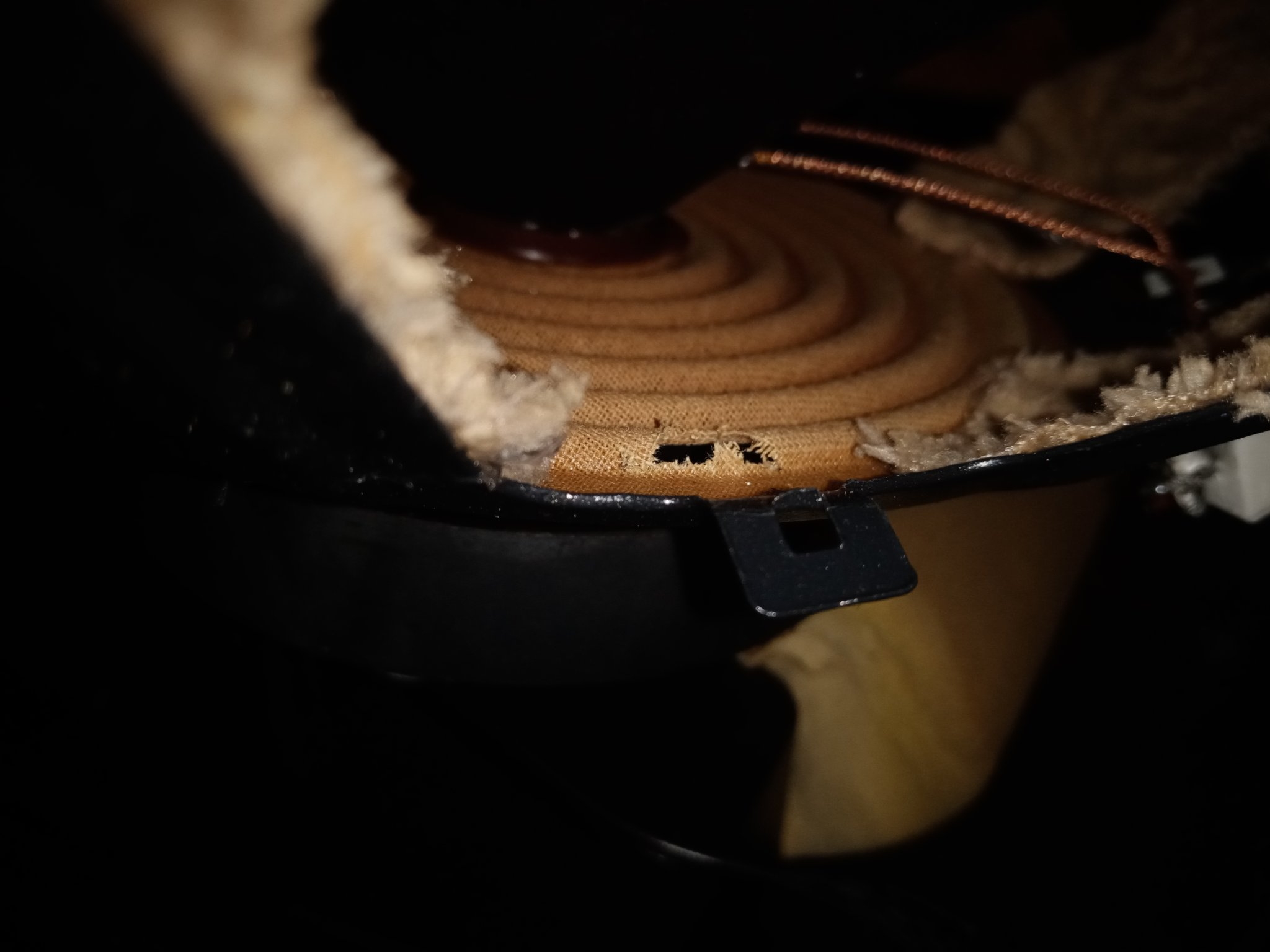

Try this tweak, making damping better can bring more resolution to the sound:
Glue a sheet of egg crate foam like 20cm x 20cm, 5cm thick with (removable) silicone to the back of the driver magnet, omitting a ventilation opening if it exists.
This adds damping in the middle of the box. Reducing standing waves. Veery effective acoustically.
I won't touch the crossover due to its quality components.
But if there is a resistor in line to the tweeter try putting 0.47 uF across it extending the tweeter more to 20khz. If its too much add some resistance in line with the cap.
Try this tweak:
damping the metal basket of the driver on the inside.
You see no change in frequency response but you get more detailed sound, make it removable if you don't like it.
