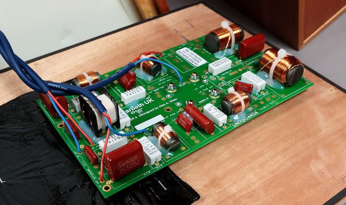

I've got a pair of harbeth speakers that belonged to my father that I'd potentially like to upgrade, if feasible. From what I understand, the newer version of the speaker is more contemporary sounding and probably more to my taste and I'd like to hang on to them. From what I could read online, the bulk of the change is from the crossover, there's some extra dampening too around port.
I've found pictures online of the old and new crossover. I'd likely get someone with the knowhow and capabilities to do the work, if at all feasible. The PCB seems to be the exact same.
So, can this be done? Or is it a silly proposition?

If you know the part changes, you could apply them directly.
Otherwise, making any tonal changes to it would be difficult to do right without a thorough analysis. Meaning individual driver measurements, and crossover simulation.
However, You may have some fun inexpensively by replacing some of the caps that go to the tweeter and midrange. Depends on how well you can trace the schematic.

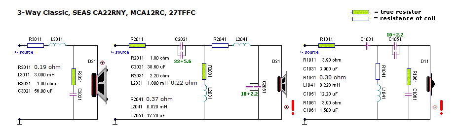

You don't tell us what model this Harbeth speaker is. I guess a 3 way. The MKII might well have different drivers from the MkI. Hence one reason for a new crossover.
Most three ways look like this Troels Gravesen SEAS 3-way classic:
643092d1509415123-suppose-shallow-vs-steep-argument-troels-3-classic-circuit-png
643093d1509415123-suppose-shallow-vs-steep-argument-troels-3-classic-jpg
I counted SIX coils, so clearly a bit more going on with Harbeth.

The model is the SHL5, the newer one being the SHL5 plus. My thinking was seeing as the PCB were the same (both have the same version number indicated on them), component values will maybe be printed on board and then it's a matter of getting them and copying the new crossover. Indeed, I thought many were the same but in a different layout, but like I said, I'm totally new to this. The fact it isn't that straightforward doesn't come as a surprise! Some more reading seems to say that a lot the components are custome values?
The driver and both tweeters are the same. There is apparently a new formulation used on the driver surround due to some manufacturing requirement, however their response is apparently the same. So, it seemed to me the crossover and dampening was what needed to be changed.
As for the sound change, apparently bass is tauter and speaker placement is easier as a result, also presentation was said to be ever so slightly more hifi (I'm guessing less monitor-like maybe here).

Obvious potential fix here is replacing the wet blue electrolytic with a new one to fix potential ageing.
Mundorf Electrolytic ECap Capacitors
Also loosen and retighten the 4 nuts on the speaker connection for unoxidised metal.
I don't know if Harbeth use crimp connectors to the speakers, but the wires can oxidise too. You could strip them back to fresh metal and recrimp, possibly with the wires doubled back for more contact. A trick a pro electrician taught me.
