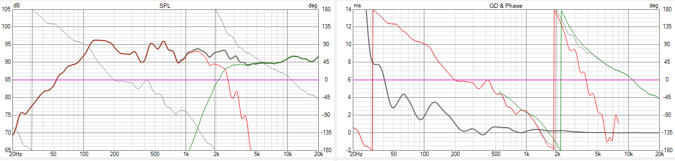

Hi All,
My first post here (other than my intro)!
I have spent the better part of the past few days going through the internet for crossover design tips and it seems as if it is a little bit of a dark art.
I've prototyped a speaker based on my requirements, built the boxes, got the drivers in and used a MiniDSP to try and find the sound of the type of crossover I am after. This lead me to settle on a 3rd order at 2.2k for both drivers, tweeter down 4db. It seems to give me the power handling I need for the tweeter because of the steeper slope and tames some of the breakup in the 10 inch driver I am trying to cross over (I know - a tricky task!).
Very quickly I have learned that I can't just plug those values into a crossover calculator and so have spent some time learning to use VituixCAD whilst using those calculator results as a jumping off point.
I have managed to get to a point where I am happy with the frequency response plot. The tweeter looks excellent, but the woofer is a bit wobbly - I think that is alright though, it sounds nice in real life.
I'm now at a point where I am on to the phase relationship and how a 3rd order can sometimes be tricky to wrangle.
I suddenly have realised that the phase does not line up properly, especially at the point where it seems to flip.
It looks as if I am about 30 degrees out at the crossover point.
My question is, how important is this in the reality of creating a crossover? Presumably as soon as you move off axis this phase response will change (which brings in a whole new dimension)?
My model is using actual values of components I can order so there isn't a massive amount of wiggle room.
Also as a bonus question, I'm guessing that moving the phase around is more than just about shifting component values until they are ideal? If I change the values of the components, I can never quite get it to show a frequency response I would like - it does shift quite a lot!
I know that the ideal situation is to buy lots of bits and try them out, but I am trying to get it as good as I can the first time round so that I don't have to reorder a whole bunch of stuff - but I do know that with time I'll have more of an inventory at my disposal!

I am trying to get as close as possible in a simulated environment before committing to buying the components needed. I'll definitely be measuring after the build but am more just looking for advice to point out if there is anything inherently (or sound ruiningly!) wrong with what I have so far so that I will need tweaks rather than a total overhaul.
I know unpredictability is part of the crossover design process but hopefully with the right design it will iron out any major creases!
I've measured in a DSP environment, but I'm guessing that won't mean much as electrical components will behave differently?
what crossover? i.e. what is your acoustic target?
I'm not sure I quite understand what you mean by acoustic target - other than just a general sound signature?
I'm happy with the measurements I've taken using an active DSP and essentially want to translate this to a passive crossover (or at least as close as I can)
So I guess my target is the same as that - 3rd order xover at 2.2k, tweeter at -4db. My question is not really so much to do with the frequency response, but more to do with whether the phase shift exhibited in the screenshot would in reality be problematic (assuming in reality it were to match that response).
I'm expecting to have to do some tweaking but am wondering if by these graphs it looks as if there is something inherently wrong in the design, or whether this is within tolerances of what would generally be considered to be a good performance
When you said that you have measured, do you mean measured each speaker response (frequency/phase) with a calibrated mic? And did you measure the impedance of each speaker as well? Are these measurements being used in Vituix?
More information is needed.
Measured woofer, tweeter, and sum, with the electronic x-over.
Measured woofer and tweeter raw.
Details of the passive x-over sim.
Details of active delays, or EQ.
Details of measurement setup.
The sim graph itself looks like it's OK, but details could affect the accuracy of the sim.
I would only trust gated measurements myself, but with the right setup, it doesn't matter.
The measurements I have are from the active setup using a calibrated mic and REW - just for frequency response.
In terms of the actual speakers, I am using the manufacturers' spec sheets traced in VituixCAD - I know these can be suboptimal, but I don't have a DATS system or equivalent so I'll have to trust them for the time being!
I can take individual measurements of the drivers themselves in situ - the frequency response plot is similar to that in the image I attached, quite flat and then a roll off for the treble. The phase seems alright too - I do have a cap in front of the tweeter for protection which has seemed to introduce a bit of shift - I had to reverse polarity to avoid a null at the xover point.
There are no active delays - just a very basic xover. These are speakers that will be ideally used not for critical listening but in a more ambient format so off axis response is tricky.
Measurement setup is a UMIK1 and REW for the time being - nothing to measure the drivers electrically as mentioned above
I'm trying to get most of the way there through the sim and then tweak if I need to at the end - mostly if I can actually hear any audible problems. I am comparing in a room with a system that comprises of Qual ESL2905s with a pair of REL stadium subs, and also a pair of Tannoy IIILZs as the B setup. I also have a smaller system of a pair of Focal Solo 6s and a homemade sub. I feel I have enough high quality real world varied reference points in those to get something together?

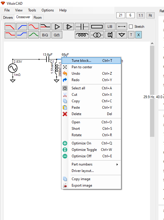

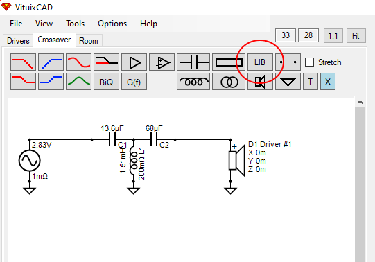

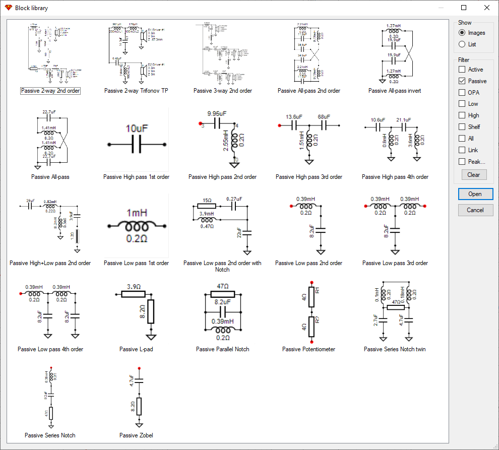

that Vituix has a library of filters
If you want to start using the digital theoretical filters you can go back later and fit a circuit around it.
click library tap
select passive for collection of passive filter blocks
Once you paste in the filter you want to work with.

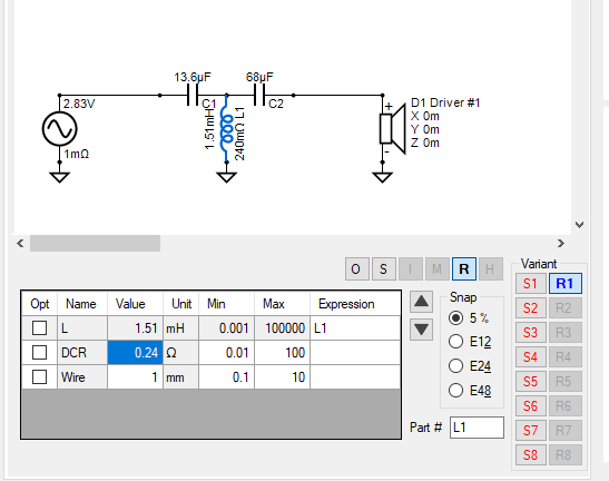

Right click any component in that block and select tune block or ctrl T
Window will open you can change values by high lighting in blue
and adjust values with mouse scroll.
Z does not have to remain " 8 ohms" or the driver impedance
crossover points are often much different and the overall impedance
can be fine tuned likewise. Snap for values can be set to 20%
or once you get the filter you like, use real components close to the value.
Then of course can rebuild the filter with individual components
and match the values of series resistance according to manufactures data sheet.
Of the real components you plan on buying
You can click on components in the block and set values to snap to common ratings
and also for say a inductor set the DCR to what the manufacture lists in datasheet.
Use arrow keys to change values
Reactions: hifijim

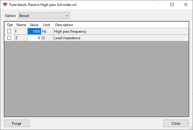

Using the blocks will automatically maintain correct inductor values to maintain a Butterworth or Bessel filter
according to the impedance.
