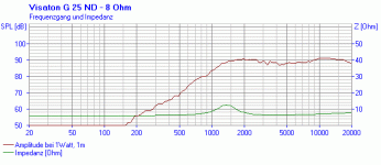

Tweeter - Visaton G25ND
Specs are attached

first crossover design
Here is my attempt at designing a crossover for the drivers above. Any comments would be greatly appreciated.

It’s difficult to decide without having modeled driver curves-phases. It looks a good start. I believe the upper cross freq. will be at about 2K which is perhaps too low for the tweeter – 3K would be better. Phase should probably look ok, and impedance would look relatively smooth as well.
Thalis
I did a quick model of these drivers. It’s not precise: The real boxes and baffles are evidently not modeled. Drivers are modeled in the same vertical plane, mid acoustical center 1cm behind the tweeter and woofer 2,5 cm behind. Midrange is modeled in a big closed enclosure (>6 litter), Woofer’s model doesn’t matter significantly for these crossover points. I also decreased a little some cone breakups since they will get somewhat smoothed in a real enclosure.
SPL magnitude of the circuitry looks like this:
Imp magnitude:
If woofer and tweeter are positively connected and the mid inverted, SPl mag will look like this:
I changed a little some values in your circuitry:
I worked things out for some baffle correction, making some assumptions regarding your baffle according to the volume you stated. So, in the next frequency responses you should consider that beyond 400-500 Hz the real loudspeaker output will be less, hopefully at about the same order with the rest frequencies (if baffle step, woofers placement and room gain come into the equation together).
So, here is the SPL mag:
And impedance will be like this:
I also worked a slightly different circuitry, adding 2 values:
With these you get this SPL response
and this impedance curve
Normaly, these two are a good starting point. In reality you shouldn’t get considerably different responses. Nevertheless you should work your enclosures, measure your drivers in them, and then some improvements could be made.
Thalis

Forget the 1% tolerance - tolerance is used in this program for some sort of analysis – I just chose the 1% figure in the end because without any tolerance all values are written with two decimal zeros which are some times distracting.
I didn’t see your note about the 1litter enclosure, so I modeled the mid in a big one. There will be no phase differences in the crossover point with this change, only a minor magnitude difference in the 100-300 Hz region were the mid contributes a little only – in any case it is not significant. 1 litter is a very small place for the mid to play really good though and you should place a lot of stuffing inside.
I think that the second proposal should be fine, but I also suggest you get some basic measurement software and a basic mic to perform some measurements with these drivers in their box. It is possible that frequency curves given by the manufacturers (especially for the tweeter) are not precise and that my assumptions are not perfect and this could possibly end up with magnitude differences and phase dif. as well.
