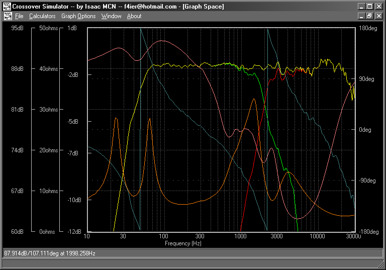

If anyone is interested, a partially-functional, beta, version of Crossover Simulator is now available. The current build is capable of simultaneously simulating multiple projects of up to 6-way parallel/series-type systems.
I'd like to finish it asap, but I can only work on it in between school work 😀 I hope you find it useful in your DIY projects 🙂

I haven't yet download it but is it possible to use a mixed filter order design instead of using the same filter for both the woofer and tweeter in your program.

Yes, it's possible to use mixed-order filters. You can use the sipmlest of all filters, or you may go all out super complex 🙂 So far, I haven't encountered a passive filter that it cannot simulate.

Unfortunately, it's not that simple. Your FRD/ZMA files must come from your driver's actual measurements (to get accurate results). If you just want to investigate filter bahaviour with different FRD/ZMA datasets, you could use Subwoofer Simulator to write simulated FRD/ZMA files.
To make modeled FRD/ZMA files from SubSim, simply:
--> Set SubSim's upper frequency graph limit to about 20kHz or 30kHz
--> maximize SubSim to get more datapoints into the FRD files.
--> For your Woofer(s)
---- Enter your woofer's Thiele-Small data
---- Design your box (sealed, vented or what)
---- Write the FRD files
--> For your Tweeter(s)
---- Enter your tweeter's Thiele-Small data
---- Use the Sealed-Box model, set box volume to something very large -- something like 1e12.
Here is a screenshot of FRD/ZMA files made from Subwoofer Simulator.
Again, you really should use measured instead of modeled data. If you're comfortable with a soldering iron, try Speaker Workshop. It has a measurement function (and a filter simulator as well).
