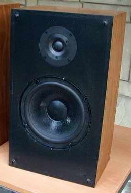

What's the secret of Snell speakers? Well 4 ohm high Qms bass with foam surround really. Big baffle too. Quite a low second order crossover around 2.7kHz. Robust tweeters like the Vifa D20 or Hiquphon OW1. And ferrofluid can rescue you from power handling problems with tweeters, because Snell did stress tweeters.
The Snell K III seems to be a specialist polypropylene cone 8" bass. Can't be much different from a Snell K II. Maybe it's some 4 ohm variant on the Vifa P21WO:
Snell Type K/II loudspeaker | Stereophile.com
I'm winging bit a bit here, but I think you should try some trusty high Qms German Visaton paper drivers, like the 4 ohm Visaton W200S 4 ohm in a 30L closed box. After all, Snell used paper and reed cones too. Rubber surround shouldn't be a deal-breaker, DeVore uses it in the Orangutan 96.

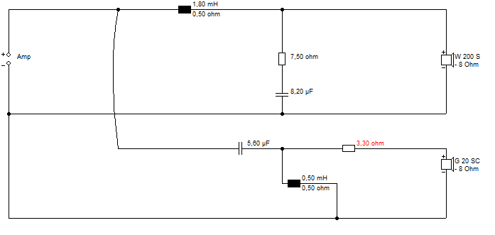

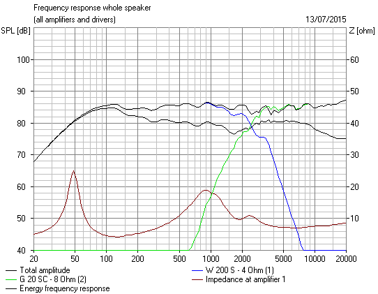

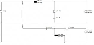

Anyway here's where I got with Boxsim simulation with a Snell-type crossover. I used a 56cm x 26cm baffle on closed box and that dull looking Visaton G20SC. It all looks quite reasonable. It works with the 8 ohm woofer too. 🙂

You seem to be missing the point:
Any change in the drivers or cabinet will require a different network.
Also, Snell hand tuned each speaker prior to shipment, about 20 minutes were allowed for this, depending on the model.
I'm not sure which Snell you are showing, it looks nothing like the model K's that I have had on my bench for repair.
"you're a fat lot of help in this thread"
You still don't get it, do you?
If you expect good results, everything must be designed as a whole, by someone who has test equipment, and knows what they are doing.
My advice: build a proven design, from a proven designer.

Here you are, supposedly, with a Snell K speaker on your bench for repair. But with your huge alleged competence, you can't measure some simple coils and caps. 😕
You say simply leave it to the experts. Well who are they? Is a six element second order crossover that hard? I don't think so. 🙄
Snell speakers were admirably based on efficient drivers. As was my modelling with Visaton drivers.

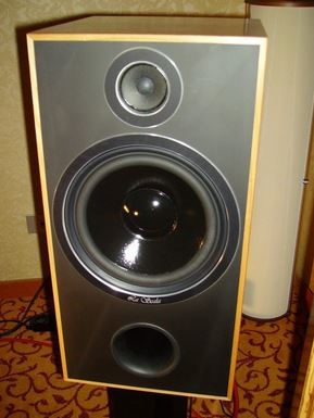

A homage to Snell in the high efficiency direction, maybe not exact in all respects, but something that will satisfy.
Troles Gravesen follows that high Qms 8" plus tweeter muse: TQWT-
I like the cheap as chips 30L Visaton W200S-4 and TW70 idea: 6moons audio reviews: WLM La Scala.
Because you can always hear the transition from 8" bass to 1" tweeter as a sort of irritating extreme brightness in the power at the top from the soft dome. Closed box or reflex is up to you. But the filters are simple, especially with 4 ohm bass.
