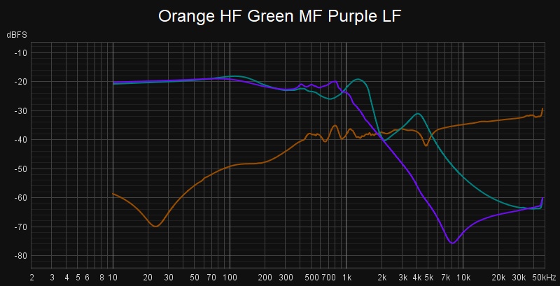

Ok guys did the measurements. Fortunately the Bryston survived the fake transistors, It was an easy fix. Obviously calibrated it for DC Offset and Bias prior to testing with the original transistors it had before.
Fed by TC interface. 700mV
Goes to Bryston Left CH.
REW using calibration file for the actual inputs and outputs loop, including the Bryston 4B NPB.
Level on the Bryston is set so output voltage is around 700mV as well.
Speakers are connected as per the manual.

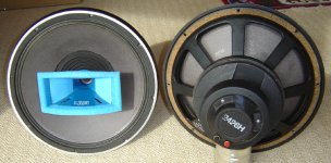

I'm sure that JBL was trying to improve something from previous 813 /604 versions.

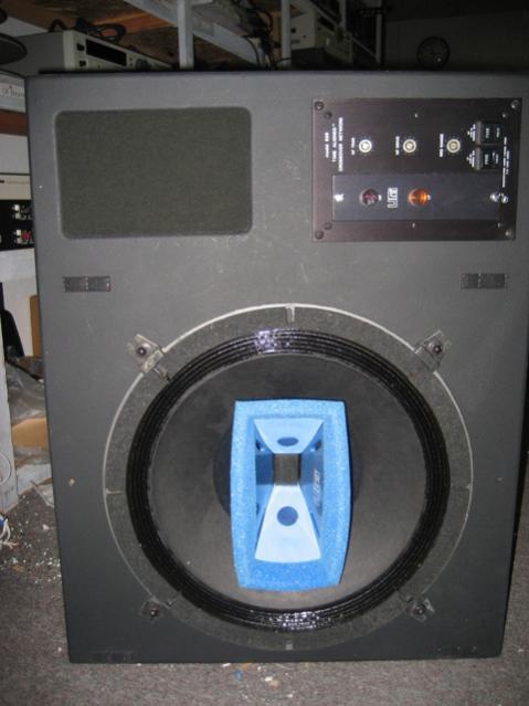

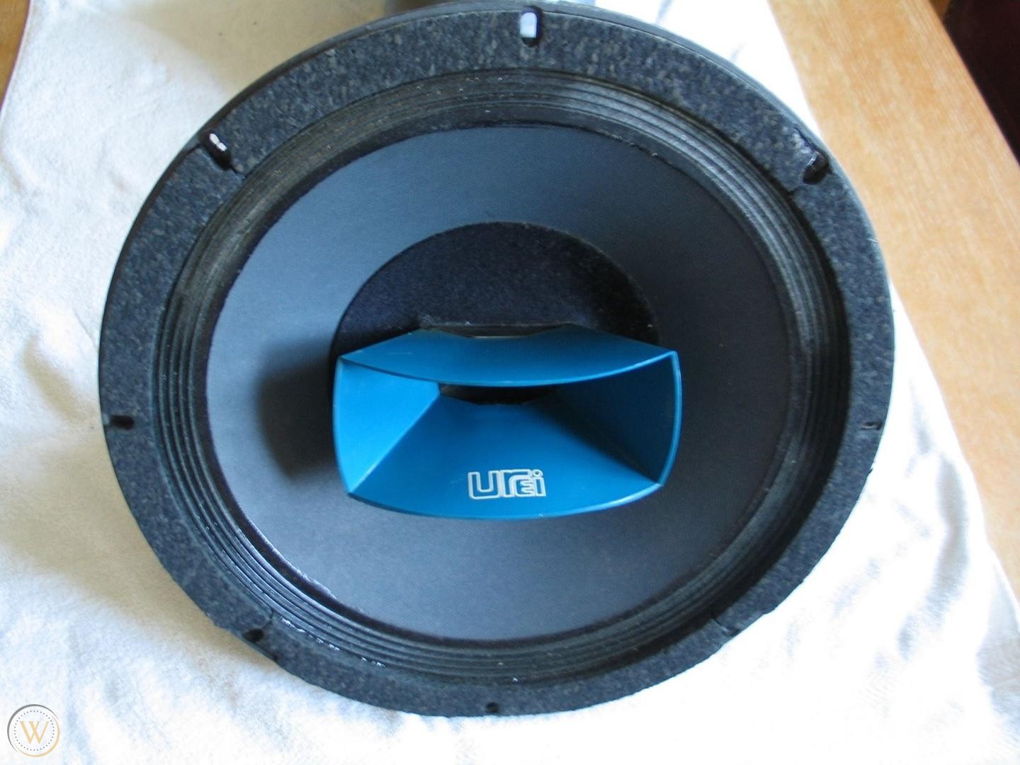

Hello Plasnu
That I have no doubt! It's interesting to see how those Urei horns evolved over time. I used an 811C clone for my center channel for years and loved it! The vocal clarity on axis was excellent. If I ever get a chance to grab a pair of 811C's for a stereo set-up I would be very tempted.
Rob🙂
