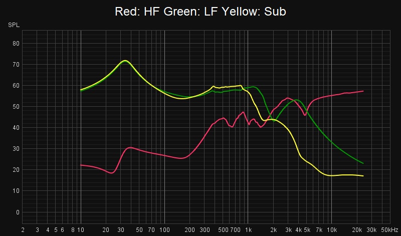

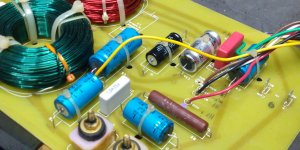

I got some pretty emblematic studio speakers some time ago but never hooked them up. So first they needed some love, cleaning and such. They are 3-way, massive speakers, Urei 813C. So before connecting them to the Bryston 4B NPB, I decided to check the crossovers, look for leaky caps and such. I certainly did not find any clear offender by inspection or individual component testing, so decided to fire them up. The sound was pretty midrangy. The manual did say that the speakers are really sensitive to installation position, that is something to have in mind.
So decided to run a REW test, with the speakers connected, to see what type of curves they have. I am just tapping into the speaker terminals with a sweep. The results are attached. Some wacky curves going on. Tested the second one. Almost the exact same curves.
So questions have arisen: (bear in mind I am just starting to learn about speakers)
First, I suspect my measurement procedure is terribly flawed but,
If not that bad, then:
Are maybe those bumps trying to correct speakers?
Are those bumps normal if a crossover is measured like that?
Maybe crossover health is not that good?
Attached are pics and manuals.
Thank you all!

I'm not entirely sure what your measurement is showing. Is that supposed to be an SPL plot? Because it sort-of looks like an impedance sweep. Which microphone are you using?
Chris
I did not change the units, sorry about that. It is just dB measured as a function of voltage at speaker outputs. Curves are the same in REW, no matter what units I choose. Just a different scale. No mic involved. I have successfully used this method to measure equalizers before, to incredible accuracy. Since the crossover is, in essence, a filter, such as equalizers are, I thought it could be a good idea.

Please describe your measurement procedure .
Ok so REW sends an output sweep and gets it back as a voltage reading. Mic not needed if you want to measure an EQ. I have measured RIAA filters before and westrex cutting systems with the expected curves to +-1dB. What makes me think I could be flawed is that I am not measuring the speakers in the box and the fact that they are old. I think resonances, phase and a bunch of other things may work differently in this. Please correct me if wrong.
Cabinet and passive crossover designers freely flip wiring phase to drivers to suit other imperatives. If you're sharing the ground between stimulus and measuring, it could explain the unusual similarity between woof and mid.

Yes, with drivers attached, measuring the voltage at terminals. Speakers in free air. Tiny signal of 1V.
My objective is to determine if the crossovers are working like they are supposed to do.

You need to measure the performance of the speakers with a calibrated microphone to determine if there are components needing replacement (including the drivers themselves!). I'd certainly lean towards replacing the capacitors, and I'd use bipolars if possible.
What he is measuring is called a V-plot. It is the transfer function of the crossover network with the actual driver loads connected to it. It is the first measurement that should be taken when evaluating any speaker system. It shows you how well or badly the crossovers are functioning. When dealing with older studio monitors and PA systems, they usually perform quite poorly.
Definitely don't take this measurement unless all crossover outputs are loaded. It may help to have the actual drivers connected, but normally an 8ohm resistor will work ok. In some cases, without the output loaded with the actual driver, the filter will ring.
This crossover has six inductors all oriented to maximize coupling between them. Four of them are very close to each other. I would start by fixing that and see how much the out of band filter responses improve. The HP filter on the tweeter section of this system is almost worthless. Major improves could be made in the system response.
If you go on to measure the acoustic outputs of each driver and its crossover section, you must cut some traces on the PCB to do this. Make sure that only the crossover components on the driver you are taking an acoustic measurement of are connected to the amplifier.
That's what it would be telling us, if a voltage source were in use. It appears that the speaker is being driven with the output of a soundcard, meaning there might be 600R in series with the whole shebang.
Using a power amplifier will allow the transcription of the crossover's slopes etc, but even then I'd suggest that's of limited use: crossovers are designed to work with specific drivers, and without knowing the acoustic response of such, the transfer function of the crossover is academic.

It's not clear to me if there is or is not an amplifier between the soundcard and the crossover. Obviously there needs to be one or the measurements are junk.
Yes, properly designed crossovers are setup to work with the actual driver impedances connected to them. With resistors as loads on the crossover output, the V-plots would be meaningless.
Having V-plots of the actual system tells you a lot about the system behavior which is really important. In certain ways you can tell a junk design at that point without looking at any acoustic behavior. In my experience only around 25% of the professionals in this field understand how to take accurate acoustic measurements, having a nearly purely electrical measurement with no reflection sources to start with is very important.

I don't mind much what the impedance curves of the drivers are - measuring the crossover in this way takes all that into account when the drivers are connected.
My point was more that taking the transfer function of the crossover tells only a part of the story: when you combine that with the raw acoustic transfer function of each driver, then we know how the speaker as a whole will work.
So, having a 3-way crossover where the mid output is 20dB down on the LF and HF might look very weird, but if the mid is a high-efficiency 6" unit mounted to a horn, combined with a 85dB@1w woofer and tweeter, then it's probably about right.
The LF bump in the measurements suggest to me that the crossover is being driven by a non-zero source impedance, and as you've noted, that would make the measurements taken so far essentially worthless.

I am using the headphone amp in a TC Electronic Konnekt audio interface. The amp goes up to 3.5VRMS so 1V well within spec. Output impedance should be low enough as well. I could hook up the Bryston, if you guys think it would make a difference. When I tested the westrex 1700 cutting lathe EQs, an amp between the TC and the EQs did not improve things so that is why I did not use one here. Do crossovers react differently if fed by a larger voltage?
I have taken measurements of studios before with a calibrated mic, to create filters for room correction, with success. However, due to the speakers wanting to be soffit mounted, I expect some error. The plots in the manual do cover free space mount, which I suppose is just not soffit (they call in PI STERADIAN) with reduced bass response, tho. Anyways, they should still be quite flat to 100Hz in any case so, not reason to sound mid-heavy, if those plots are correct.
I do not think that if the crossovers were very out of spec, they would match so close in the plots as they do. But this is only a supposition. So more questions to the table.

I tested all the caps by removing them from one of the boards and testing them with an LCR meter. Values are alright. However, Is it possible that even if values are ok, sound is not?
