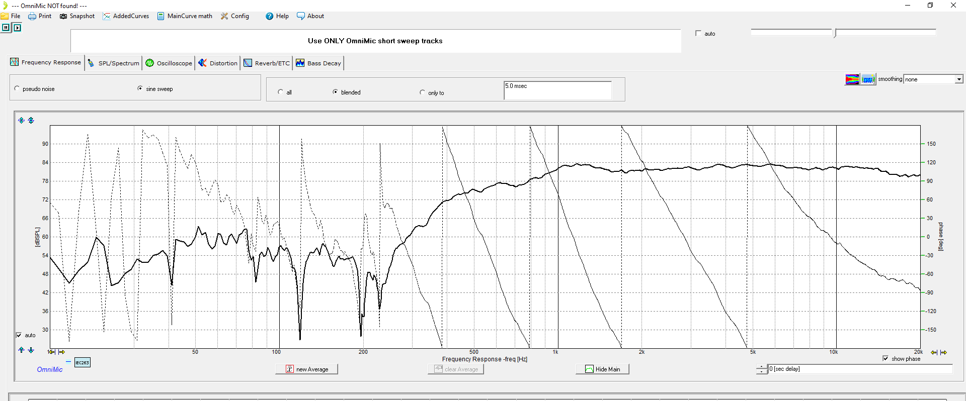

The first FR curve is of a tweeter i recently measured. The FR response goes down below 20 Hz, which is nonsense... the mic was picking up ambient noise of course. If I view the FRD file in notepad, I see the first entry is 4.39 Hz. None of this would seem to matter, but it results in the phase wraping over and over again, which seems odd.

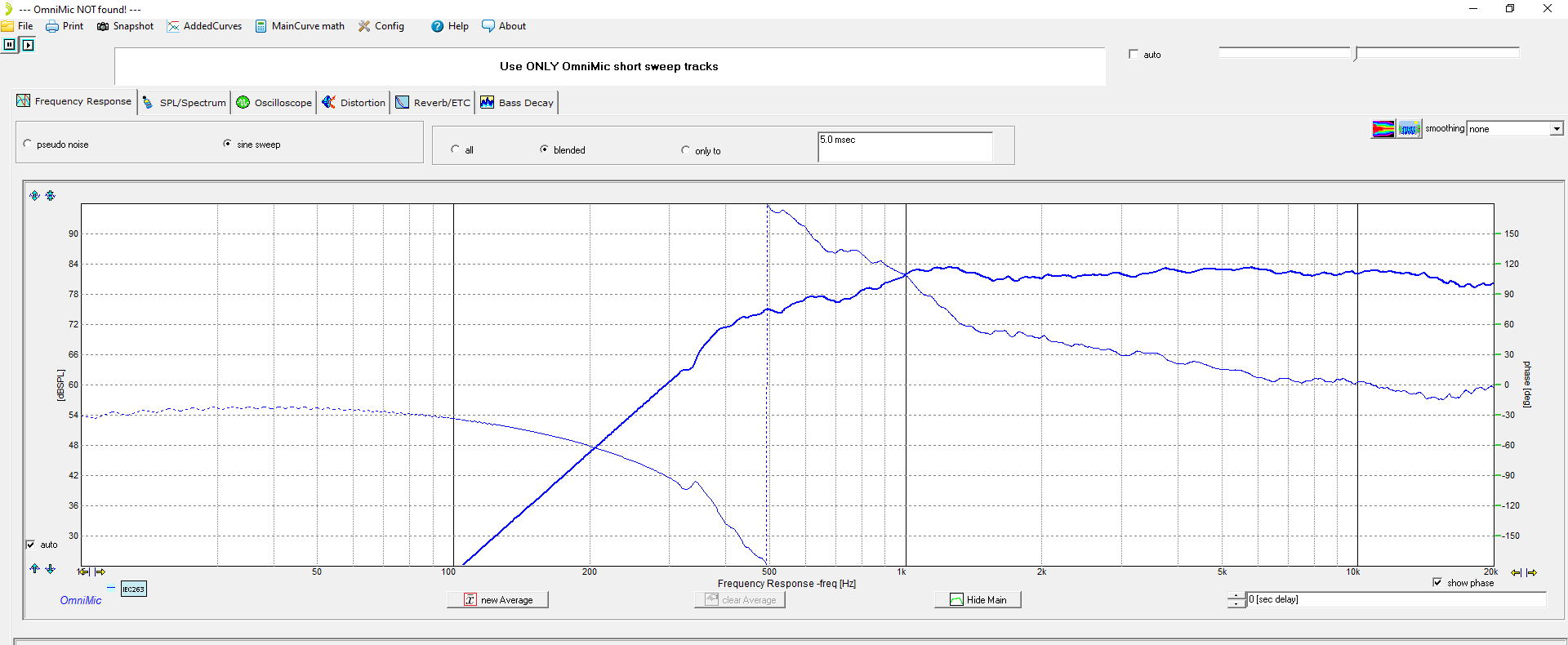

The next FR curve has been "phase restored" by the Omnimic software. I cut off the response at 300 Hz, and forced the response along an assumed 12 dB/octave roll off (which matches the OEM curve). When I do this, the phase data "resets". To my limited understanding, it seems the phase data in the first curve was pegged (or linked) to 4.39 Hz, and the phase data in the second curve is pegged to 300 Hz. The phase plot seems much more useable now, and more meaningful.
When I designed a pair of passive 2-ways over the summer, I confirmed to myself that Xsim produced the same simulation whether I used the "as measured" phase, or the corrected phase. And this makes sense, because in my simplistic understanding, phase is just the relative time delay between two frequencies expressed as a phase angle instead of microseconds. The time delay is not changing, just the frequency we are pegging to.
So when I use the "phase restore" feature of Omnimic, am I extracting minimum phase?

The term "extract minimum phase" is an anomaly, and has no real meaning. It was started by the DIY speaker crowd. A web search for the term in quotes should demonstrate that.
I suppose in my case I am primarily interested in active speaker design with DSP filtering. The DSP software I use explicitly requires the z-offset delay values for each driver.
Whether you wind it back yourself until it looks free of delay, or you wind it until your acoustic result looks useable, all you are doing is adjusting delay. Provided you have a reason for doing that it is a valid method.

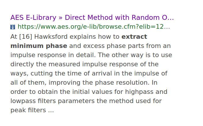

Among the search results, here is one from the Audio Engineering Society from 2004, which I would expect to be reasonable. It talks about separating minimum phase from excess phase components in an impulse response. The author displays an understanding.
Note that close to nobody here does that, for any reason at any time. This has become conflated with the process of deriving phase from a response plot based on the assumption it applies as minimum phase. Its first incorrect use seems to be with one of the old FRD tools, from where it filtered down to audio amateurs.

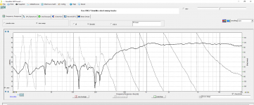

Earlier you said that you were adjusting delay for a 'best fit' against a measurement. You are adjusting normal delay, because your signal is delayed more than you require (the word excess can't be used here because it is a reserved word).
