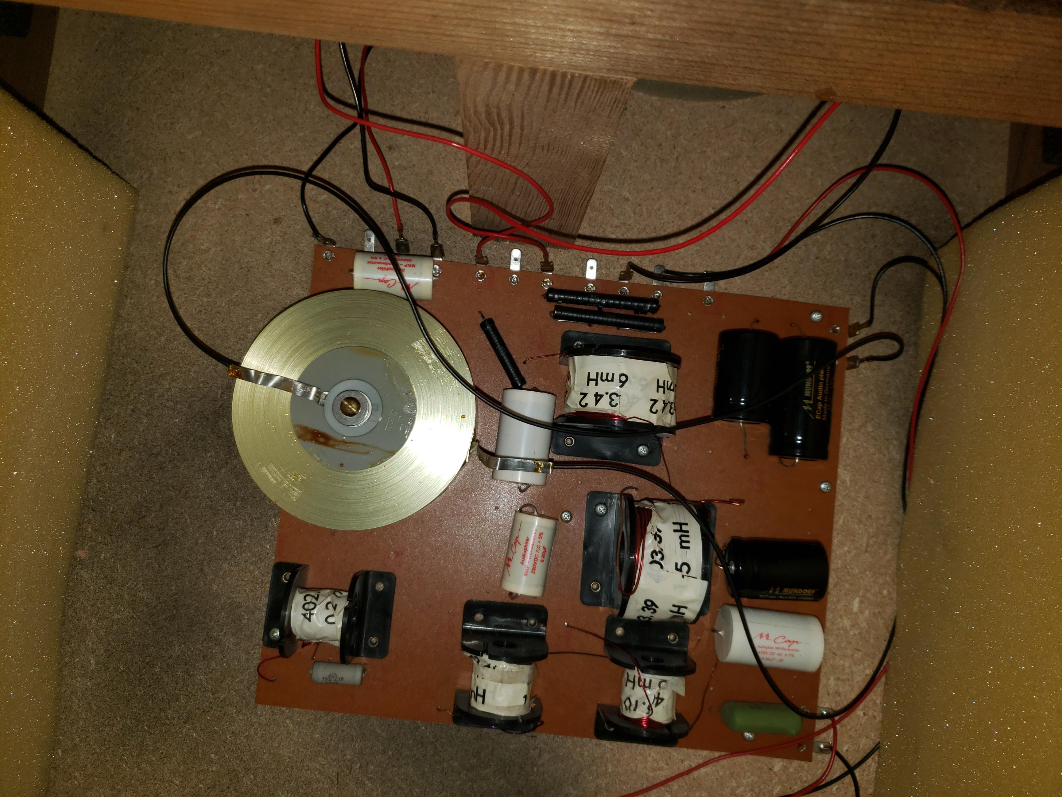

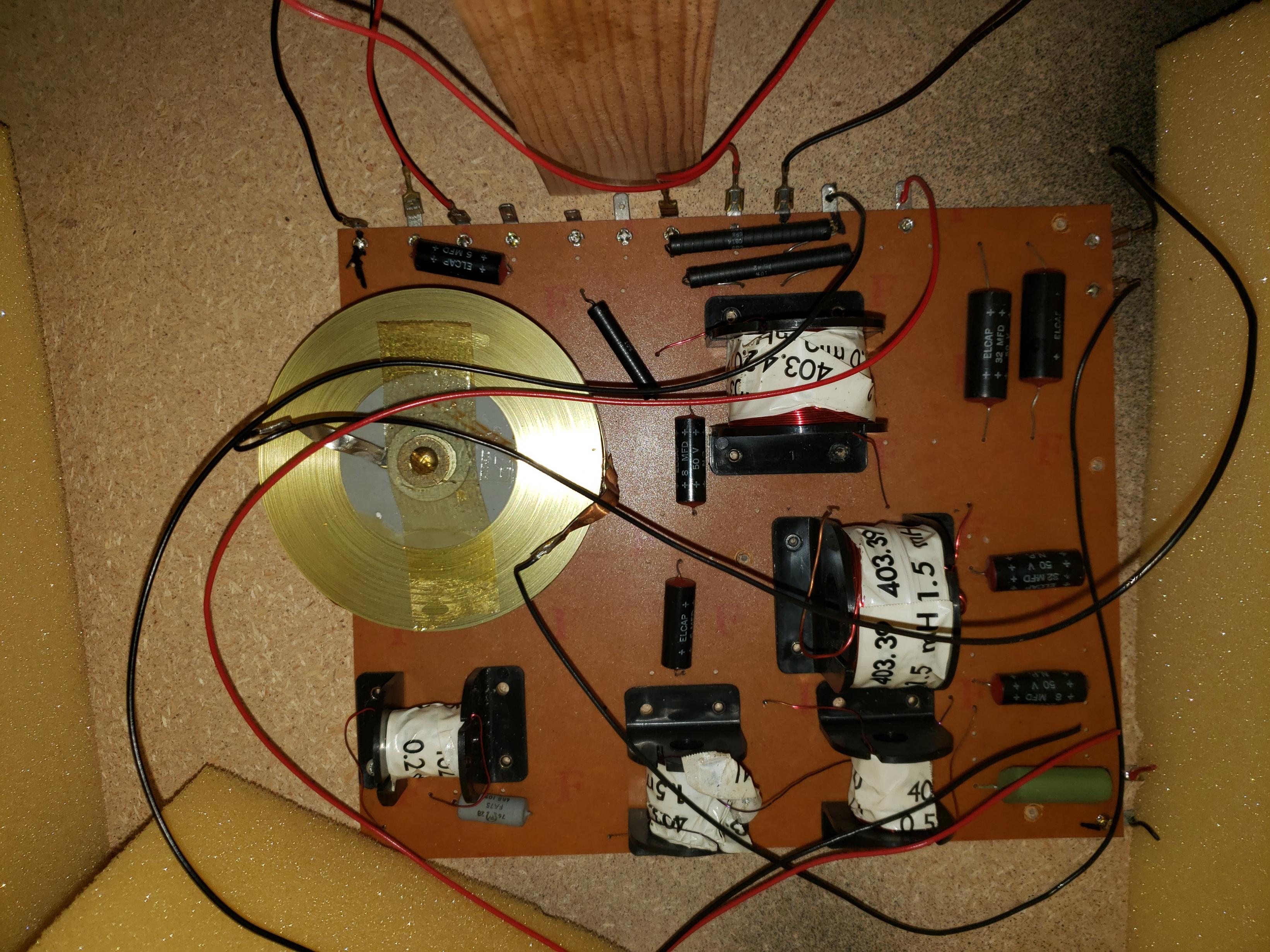

I'm doing a cap replacement on 4 wharfedale airedale sp speaker crossovers.
I would like to change all the caps with film caps.there are 7 caps per board and I don't want to go broke or over spend on the quality.I hope you can give me a little guidance and tell me if I should change the resistors as well. thank you for any help. Scott

Hi Scott!
The capacitors fitted are ELCAP bipolar electrolytic capacitors (as in attached image).
These do not age well and should be replaced as a matter of course.
To preserve the original character of the loudspeakers, you may wish to consider replacing them with modern bipolar (NP) electrolytic capacitors like the ones linked to here: Mundorf Electrolytic ECap Capacitors
Fitting seven, much larger film capacitors onto the crossover board may be problematical, so check their dimensions carefully before ordering film types.

P.S. It is not necessary to change the resistors unless they show signs of overheating. You can check their resistances are OK using a multimeter.
On the other hand, there's nothing to stop you doing so provided you take the physical size of the replacements into account.
Good matching!
The modern values are within the tolerance range of the original ELCAPs.
Your Airedale's will be revitalised to such an extent that you can expect an improved tonal balance, to which you may need a short time to adapt.
Wish I could listen to them!
well job completed and the difference is huge.I also found that my right mid speaker was not connected properly.go figure. anyway I'm listening to a couple of hundred flac songs I have and the quality makes me want to keep listening..a very good sign.thank you for all the advice...Scott
