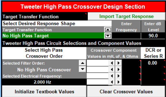

There is a simple enough of a way to examine that. Get a tracing software (fprawn labs) to create a .frd file of the FR unit, load it to a Passive Crossover Designer under tweeter and adjust the target transfer function (frequency and level) until you get two of these responses to align as good as you can. While you are there, click target button on the tweeter and high pass response window.
