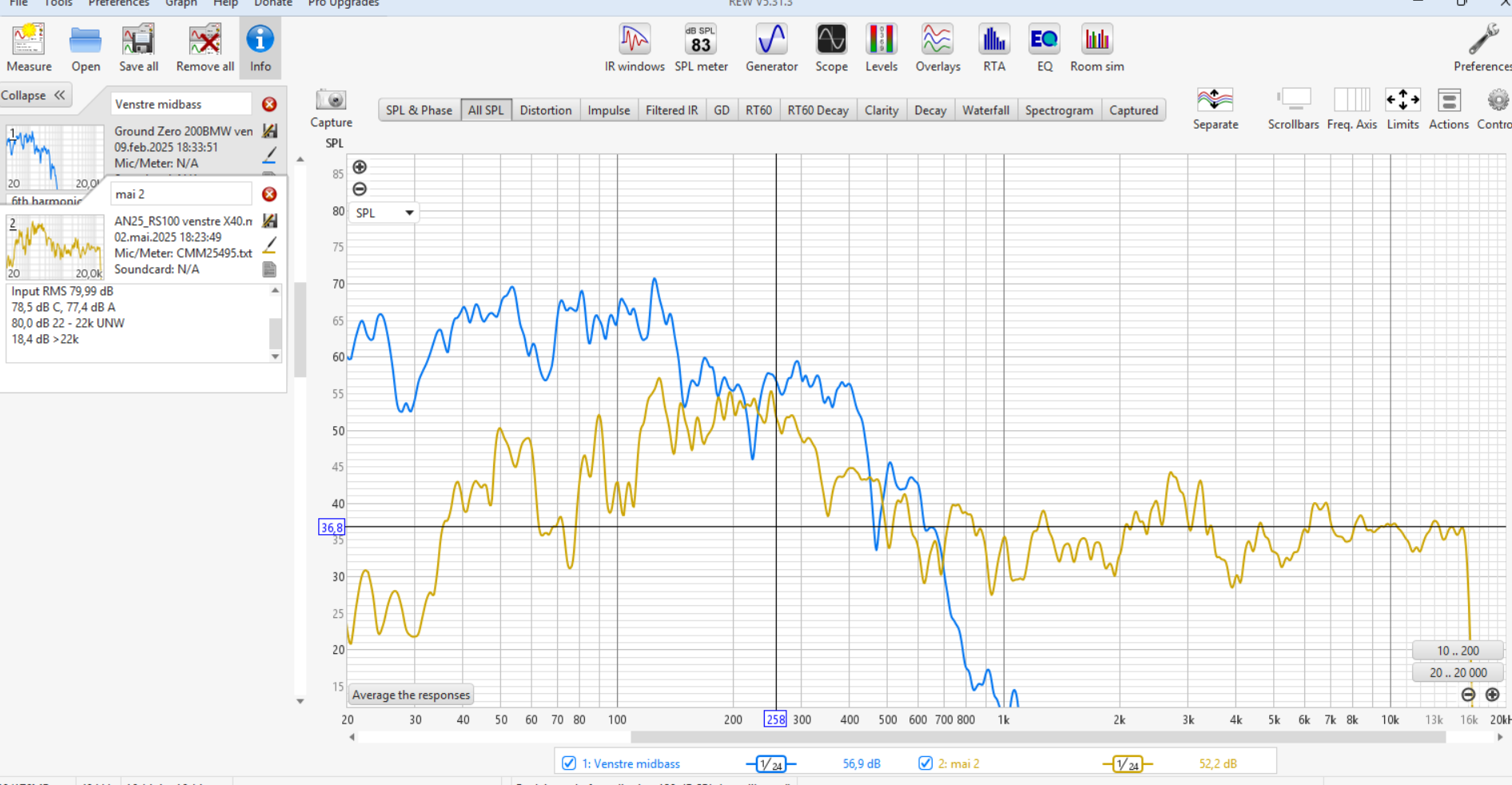

Mounted some Dayton Audio AN25 and RS100 in my F20 BMW where I have the Ground Zero underseat midbass already monted. Went from a Ground Zero car-specific speakers in the doors (mid and tweeter). First impression is that the Dayton sounded more mellow, GZ sounded a bit harsch, but louder. Maybe it has to do with the new drivers beeing brand new. Did a quick measurement and imported measurement from the Ground Zero underseat;
Smoothing is at 1/48 and the crossover on the Ground Zero is just set at 300Hz. Where would you set the crossover on the Dayton and GZ?
And I bought a cheap passive Alixpress crossover (set at 2800Hz) that I just on the Dayton Audio.
Is it okey that the two overlap eachother? In my car I need som extra "umf" in the low mid and bass area otherwise it sound tame.

Where would you set the crossover on the Dayton and GZ? - depends what do you want from the drivers, how loud you are going to play them, etc.
And I bought a cheap passive Alixpress crossover (set at 2800Hz) that I just on the Dayton Audio. - facepalm, passive crossovers are tailor made per specific driver and needs/wants....you cannot just slap some and expected any result. I would go active, not passive.
Is it okey that the two overlap eachother? - depends on the target curves You want to follow, polarity, phase,x-over points, etc, etc...

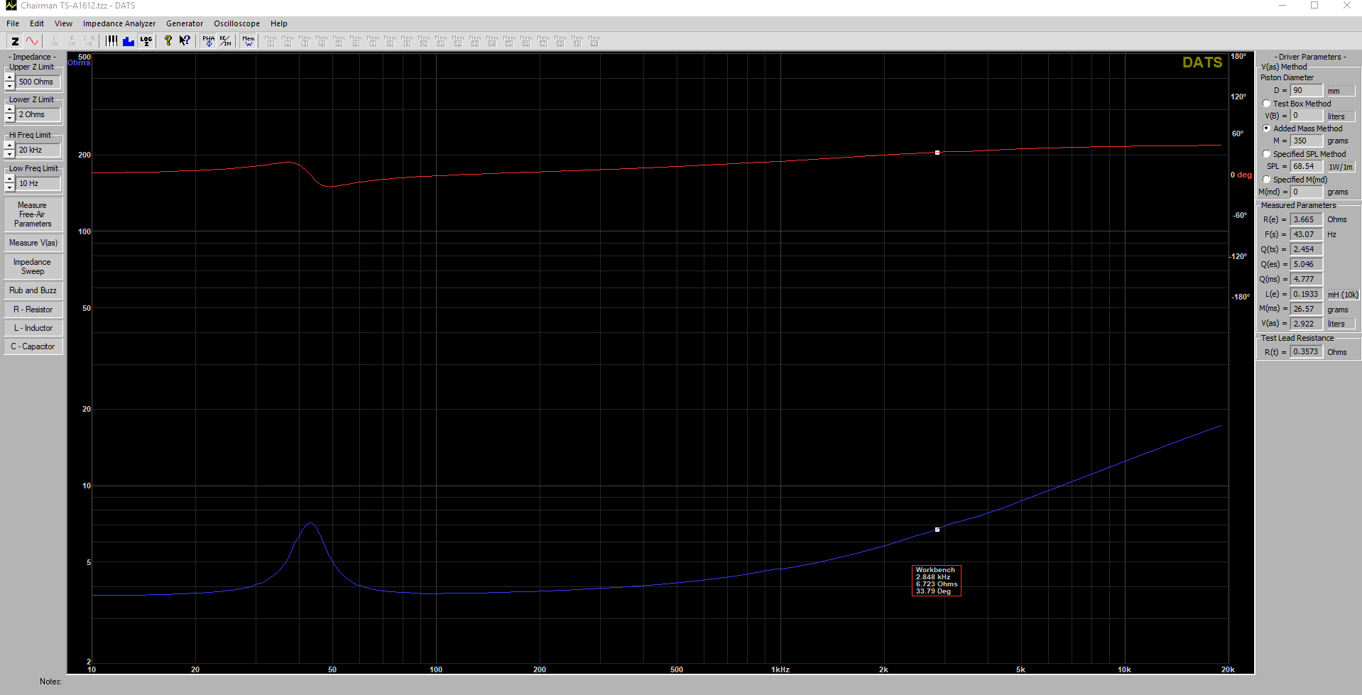

There is point doing all of the EQ of course, but what i would is: do first this (before having to brute force any EQ), switching the polarity of the mid or the high or both, just play around and see how that changes the amplitude-frequency curve. Choose the one that gives you the flattest response. Then go for the EQ. Same applies for sub, any speaker. If You go active, again try different Xover points and slopes, with no EQ. Once you are happy then proceed with EQ.
The crossover has a slope of 18db on the crossover between the mids and tweeter, and crossover frequency is at 2800Hz by the way. - this is in theory according to the Z of 4 ohms (Z = impedance). But if you impedance measure your drivers with DATS, as an example, you would see that at 2800hz neither the tweeter or the midbass are 4 ohms exactly....they are different values, that's why it's called a impedance curve, because speakers are reactive components (frequency dependant) not a resistive one as a static 4 ohm resistor which never changes it's resistance no matter the frequency.
So i'm inclined to believe that's not the crossover point at all. How far is it from 2800hz....depends on the impedance curve of your drivers.
This is just a random 4 ohm driver below i've measured in the past....check that at 2800hz it's not a 4ohm....it's almost 7ohms and there is some phase shift....a specific passive filter would be all adjusted for this....generic one would not.
