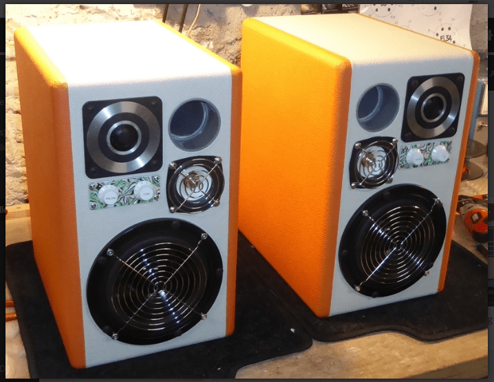

I have accumulated drivers from ebay and new, and I do wonder what I'll do with the finished experiments.
I know they'll sell for less than the sum of the parts - and I bought all the bits for a RS225/B80 FAST from a guy on that basis recently - all still boxed and cabinets too. And crossover components.
I know in my mind - if not heart - that if I build the speakers I have drivers for, I'll basically have to scrap them. After all, who else will want boxes with drivers set up for external active crossovers? And what do DIY speakers sell for on eBay?
But really - I hope I never have a room that looks like that. Surely if we went to a hifi dealer and it looked like that we'd be 'WTF?'.
Maybe I'll try giving them to local schools for 'educational purposes'.

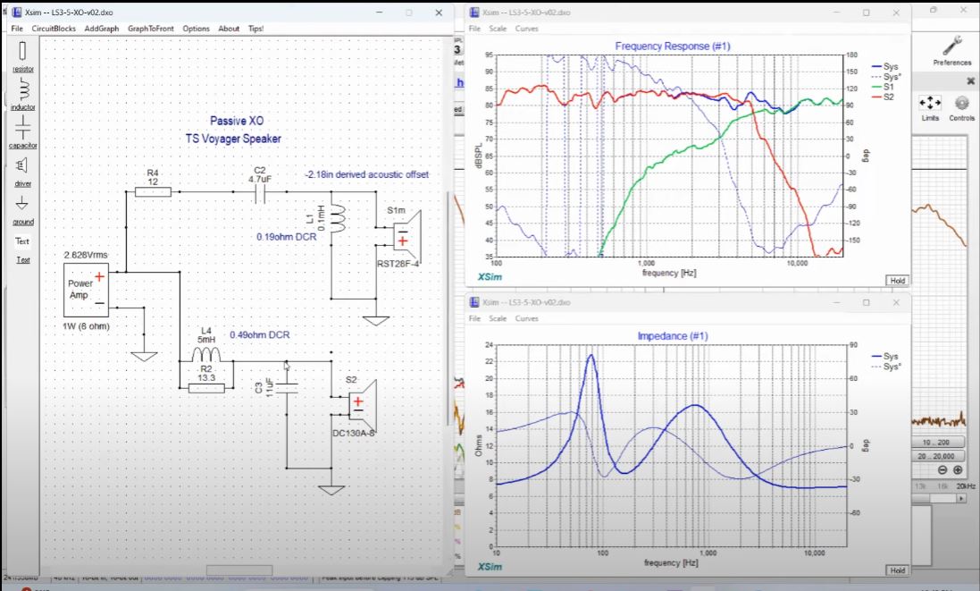

If the measurement of the speaker is done at the tweeter axis but the offset is done on the tweeter, is that even correct?
I believe its the Graham Chartwell LS3/5A, Xrk shared a pic with both side by side in the Vanguard speaker thread.Looking into the video, they show regular LS3/5A frequency response as a sort of a vague reference (there are dozens subtly different kinds of 3/5A), which is not that linear, but in general is OK.
And you would be correct. ASR had measured the speaker here and the members of the forum called it "garbage". Xrk mentioned that the unit probably had off spec drivers and offered another unit to be re-measured but Amir ended up not doing it since its too much work for a not "common product" .I guess 8 dB broad hump centered on 1 kHz fits their definition of "extremely musical". Politely speaking, this speaker is voiced for a certain 'refined' taste, but some folks at ASR would be compelled to call it garbage.
That's a conflating of two different things.If the measurement of the speaker is done at the tweeter axis but the offset is done on the tweeter, is that even correct?
The designer meanders all over the place with his description. Way too much hand-waving regarding phase coherence. 🙂
It's a really simple design that should sound pretty decent.

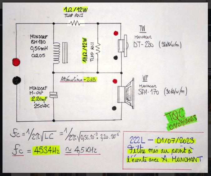

I'd like to return to my original question which was not actually 'Is this the best thing since sliced bread' but rather:
Its clearly a tradeoff between:
It might be that the trade works only in near-field (or borderline near field). But I find it interesting.
I don't think anyone suggesting that there are better designs has addressed that aspect - let alone whether any better designs use such affordable drivers and crossover topologies: but the absolute value for DIY was not my interest, rather the reasoning behind crossong quite high for a 5". Its arguably high for a 4" if you really care about radiation pattern - but who uses a 3" midrange?
