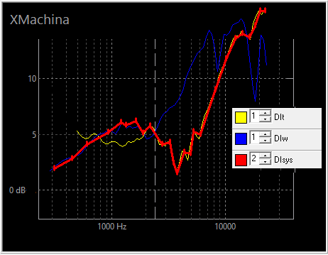

Some time ago I tried to combine a regular dome tweeter (no WG) with a 13 cm midwoofer. The goal was to obtain linear SPL and Power Response characteristics. Attempts with a crossover frequency at 2-3kHz were unsuccessful. I was achieving either linear SPL either linear PR, but never both at the same time.The designer is clearly no idiot, and identifies why he's crossed rather high.
But that must result in a directivity mismatch and like many I suspect I'd have gone for an LR at 2.5-3k.
Any thoughts? Is it contributing to the sound signature described?

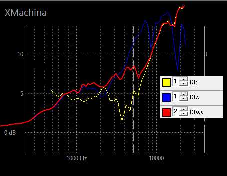

I was somewhat surprised to discover that there is a way to achieve my goal but i had to raise the crossover frequency to 5kHz. The reason turned out to be that it's easier to match drivers directivity at a high frequency than at low.
Following is resultant directivity graph (red) for a low crossover frequency (c.a. 2.5kHz). Midwoofer directivity is blue and the tweeter's is yellow.
Now similar graph for the same drivers but the crossover frequency is high (c.a. 5kHz):
Assume that system SPL is approximately constant. SPL, PR and directivity are described by the formula
PR=SPL-directivity
which implicates that if SPL and PR have to be linear, then directivity must also be linear. Looking at the graphs above, for 2.5 kHz it won't be possible, but for 5 kHz it was achieved to some extent.

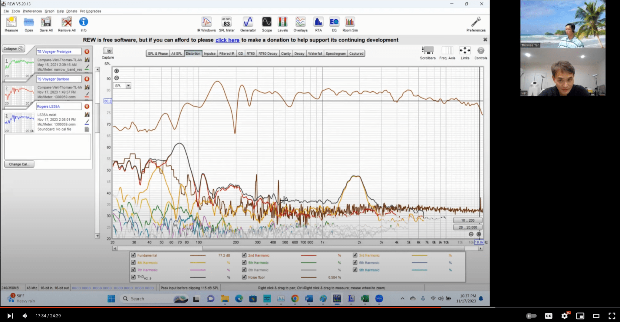

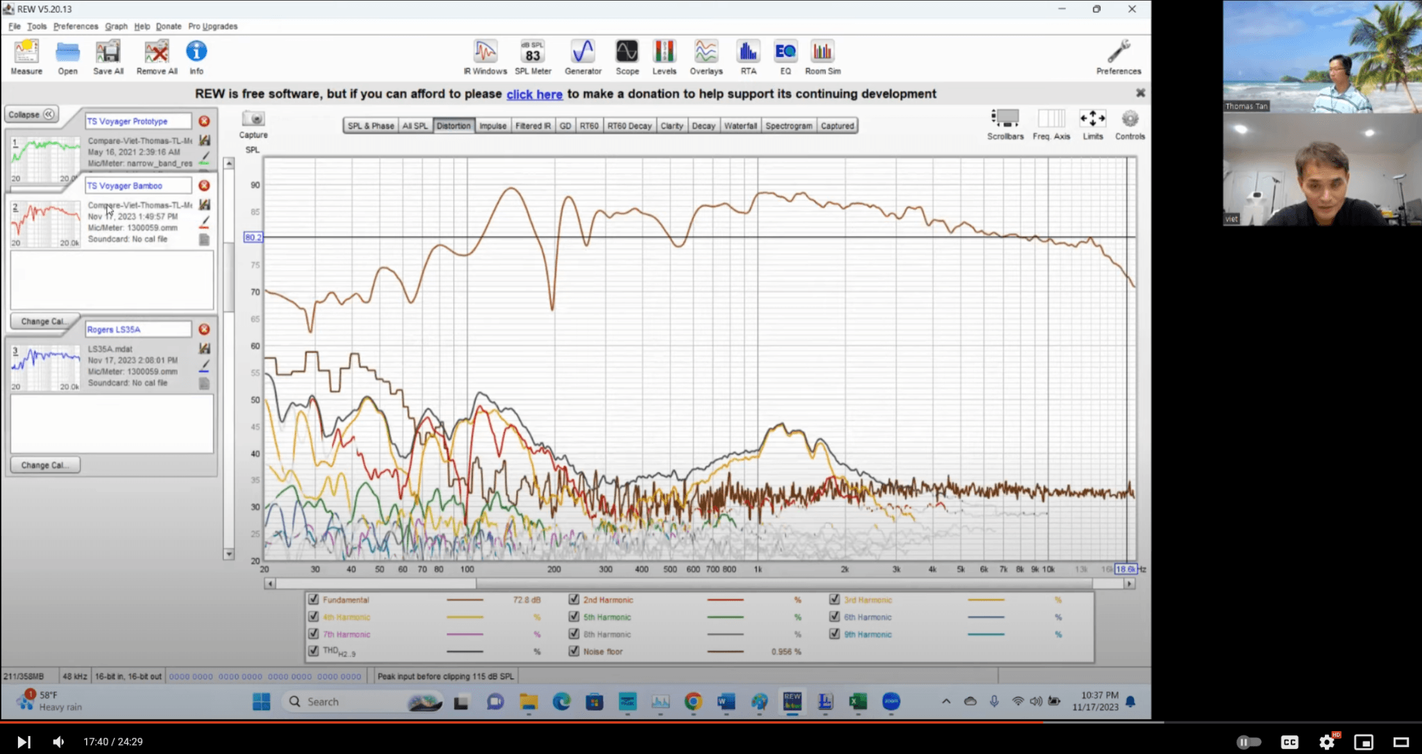

Looking into the video, they show regular LS3/5A frequency response as a sort of a vague reference (there are dozens subtly different kinds of 3/5A), which is not that linear, but in general is OK.
Next is TS Voyager Bamboo, which I suppose is production version.
I guess 8 dB broad hump centered on 1 kHz fits their definition of "extremely musical". Politely speaking, this speaker is voiced for a certain 'refined' taste, but some folks at ASR would be compelled to call it garbage. There is also the prototype, which seems to be somewhat closer to LS3/5A, including 4 khz notch/bump.
