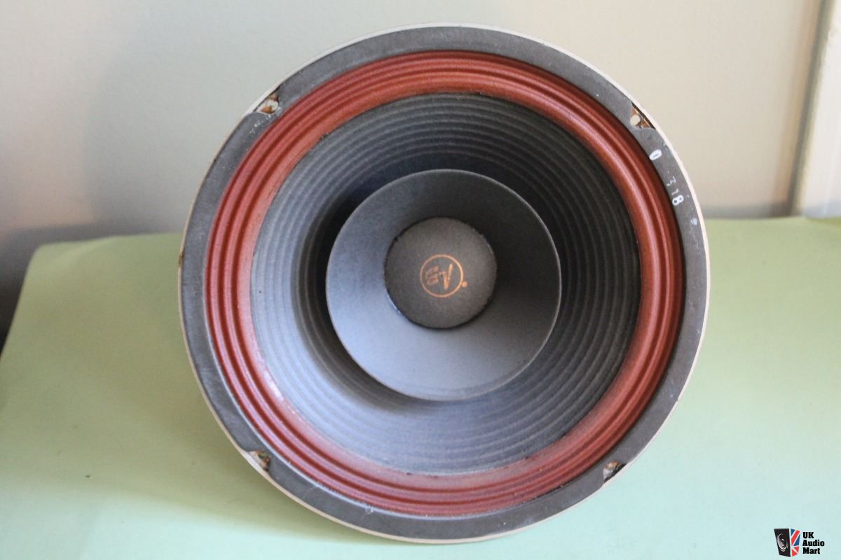

My vintage EV speaker project is starting to look similar to an Econowave, which is really a fabulous idea. I need help with crossover issues in order to take the next step.
This is a 1966 vintage speaker, 3.7cf, beautiful solid cabinet. A great Econowave type candidate. I am starting to really like the sound of the woofer, but want to ditch the horn and crossover, because it is horrible. The speaker has a 12" Alnico fullrange woofer, 100 db/1w. It is supposedly 16 ohm, but I've read that they are often more like 12-13. It crosses to the midrange horn at 800 hz. I assume that is also 16 ohm, but I don't know for sure. The crossover is potted in tar.
Before tearing the speaker apart, I want to ascertain if the crossover is bad, the horn, or both. I propose to buy either an inexpensive waveguide like the B52 closeout at Parts Express #299-2303, or use a pair of JBL 2344a and JBL 2425 drivers I have sitting on the shelf. I don't want to use the JBL long term, because they are worth a lot more in the resale market than many good, but cheap horns. This speaker is going to remain in my workshop in the basement.
I don't build crossovers, and am looking at just buying something like a PRV or Eminence from Parts Express to get this thing playing, and then take the next step. Almost all of those type crossovers are 4 or 8 ohm, and the effective crossover point would change with the existing drivers. How can I make this work in this situation? Would I be better off using an active crossover? I do have a TDM stereo 3 way, balanced. Does an active crossover compensate for differences in impedance?
I've also considered buying a 5" or 6" coned pro mid such as Faital, BMS, etc, and use it with a horn tweeter up around 5-6khz, but the same issues apply in that scenario too.
Somebody please offer some advice. Thanks!

Just discovered something interesting/confusing about these SP12. I thought the SP12 was a wide range woofer, and the SP12B was a coax. They are both listed as "twin cone", the EV name for coaxial. Also called Radax coaxial. They show a "mechanical crossover" at 4000 or 4400 hz. First off, I don't know what a mechanical crossover is. EV shows the SP12 running up to 13000 cps. Some people quote 17,000cps.
Why on Earth would a coax have a separate mid horn crossing at 825hz? And, the ability to add on a horn tweeter crossed at 3600?
I found this on another site: "Other than the aforementioned woofer gap problem... I don't know what else would be "out of spec" if the crossover and pad are passing signal and the tweeter's working.
I've gotta say that, based on the description in the previous post, it sounds to me as though the tweeter is not working -- it can be hard to tell on a coaxial driver... but the EV coaxes just don't sound 'right' when the tweeter's not working. I've got a couple of 'em here in just that state 😛
Now, having said that - it is possible to drive the woofer (well, woofer and whizzer "midrange" cone) and the tweeter separately (i.e., bypass the crossover - or at least work partially around it). If you haven't done so, you might want to investigate the drivers separately."
So, like LineSource said, listen to the woofer by itself. I have not been able to remove the woofer yet, as it is back-mounted so you cannot see the front of the driver. I'll have to do that, and see what can be done about the "Twin Cone". EV states that this driver works really well in open baffle, in 15 cf or more. That could be a GREAT solution for my other listening area, where I wanted to mount something in the wall anyway.

The ElectroVoice SP12 has a paper WIZZER CONE to mechanically extend the frequency response to around 6kHz with a ragged SPL. This is why you want to keep the woofer in the final (ported)cabinet with a full front baffle and critically listen to both test tones and music to decide on the best crossover point. Personally, I would use a BW3 circuit crossover at 1,200Hz to a 1" horn(compression driver)... ignore the wizzer extension. BUT, for garage use, you might enjoy the simplicity of running JUST the SP12 full range in your ported cabinet. A third option is to add a super tweeter at 6kHz, which is not my favorite because of the high efficiency of he SP12.
I CONFESS...I CONFESS... in the past I have carefully cut the wizzer cone off of a few drivers.

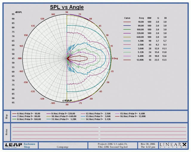

If your cabinet is at least 14.2" wide, you should be able to design separate upper baffles for these two horns.
JBL 2344a "baby butt cheeks" horn
100x100 polar pattern from 1kHz to 16kHz
H=12.6"
W=12.6"
D=6.5"
B52 Parts Express #299-2303 constant directivity horn
90x40 polar pattern from 1kHz to 18kHz
H=10.1"
W=14.2"
D=5.5"
