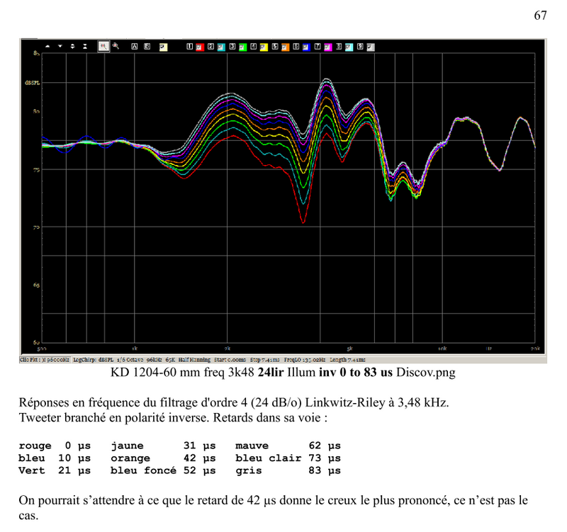

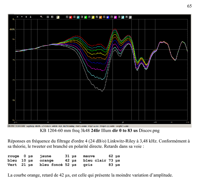

To my experience, it's not so. The reason is that in LR4 the drivers are not really in phase but have a constant phase difference of 360°.Classic LR4 should have a deep and narrow null, as well as steeper even-order typestrough
Here are two pictures of a LR4 configuration, the first one with direct (= non-inverted) connection and the second one with inverted connection. Various delays have been applied to the tweeter, with the idea that the deepest depression should give the best alignment. Drivers were ScanSpeak Discovery 100 mm and Illuminator 25 mm, crossover frequency 3.48 kHz, microphone distance 1204 mm. Determined by other ways, the best delay was determined as 42 µs (frequency response in orange color).

Unless you compensate the individual driver responses before the crossover is applied, you will not get the ideal LR4 response from each driver in the crossover region, and the sum will not look like the ideal LR4 sum or cancelation when one driver is reversed. If the crossover frequency is anywhere near the tweeter low frequency resonance and roll off, there is the added gain and phase response from that messing things up. That can be easily compensated for using a linkwitz transform to create half of the LR4 response using an active crossover. I'm not sure how to achieve that in a passive crossover. There is also the inductance of the woofer and breakup resonances that add gain and phase different than ideal to the woofer. If you look at the LR4 response using ideal drivers in the software model, you will see the sharp notch people are referring too. So an approximation to the LR4 response can be achieved in a passive crossover, it just takes a lot more parts than most people want to use.
The problem is that your drivers doesn't follows the LR4 responses enough in the measuring spot. If the drivers follow the LR4 slopes properly, then you can get a very deep reverse null if the drivers acoustical centers is in equal distance (or time aligned) to the mic position.
I would like to see people doing the same kind of experiences as mine.The problem is that your drivers doesn't follows the LR4 responses enough in the measuring spot. If the drivers follow the LR4 slopes properly, then you can get a very deep reverse null if the drivers acoustical centers is in equal distance (or time aligned) to the mic position.
The distance between the drivers axis was 120 mm. As already said, the distance from the front face of the loudspeaker to the microphone sensor was 1204 mm. The microphone axis was halfway between the drivers axis.
The crossover frequency being at 3.48 kHz, the tweeter main resonance at 500 Hz has a negligible effet on the response.
For use (listening music) I always include transforms on mediums and tweeters to avoid the effect of their main resonance on the responses of the filters. Just Linkwitz did in 1978.
LR2 reverse null is not shallower at any degree (why would be?), but wider than LR4.What xover order? Classic LR4 should have a deep and narrow null, as well as steeper even-order types; but LR2 will be a shallower trough.
