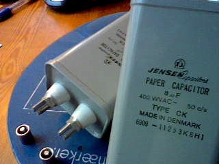

Thanks once again Alan. Well, now Lorian and I each have a pair of Ditton 44s, both with replaced speaker connectors, and now working very well.
Personally speaking, I'd like to replace the caps, because I think that the cost is justified by the potential improvement.
I know that electrolytic caps, and probably other types too, have an insidious degradation, that is hard to notice, but when replaced after 40 years, should take the speakers a leap back up to original spec.
From what I read, the mids and treble caps (C1, C5 & C6 on this photo) are much more critical for quality polypropylene caps, as they are on the + side of the drivers, filtering out the bass, whereas the others are on the return from the drivers and so can be served with electrolytics without any degradation of sound whatsoever. Is that about right? I interpreted that from this quote I read:

Good to hear it is sorted. nice to know I was on the right track when I said it could be a short, just targeting the wrong spot
If you want some polyprops that should do the job without breaking the bank you could look at jarcars polyproylene caps They also have a range of electros suitable for crossovers for the larger values
They only have polyprops up to 10uf, but that will do you for most of the values you would need. certainly in the mid + tweeter section where it is probably more critical. (A bit under 13 pouds for 2 X 10 and a 4.7 would get you pretty close to your 25uf one (tolerances aside).
The big electros in the low pass I'd personally just leave as electros... will start getting expensive to replace them with film caps! There are caps available in film up to values close to that big but they are VERY expensive

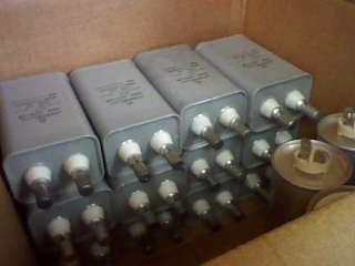

Also, I have a question: Can these bass return caps really be 72uf? They are so small, physically! Is that a realistic value? I thought it might be more like 7.2 or even .72 considering the physical size.
Assuming that they are indeed nonpolar electrolytics then for 72uF 50V it is more than reasonable that they are that small IMO That is the main (only?) advantage of Electrolytics over film caps, they pack a lot more capacitance into a given unit of size!

Caps only have the sellers company name written
Relabelled, noone knows where they come from
Well, the only cap I have used is 100uf, on mids highpass
Dialectric is possible the cheapest
Ofcourse there are better caps
But I guess they are ok, and cheap
How good they are, I dont know
These NOS pios I got fore free
Unfortunately all 8uf
