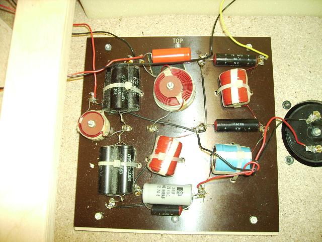

This continues from the feed about the celestion ditton 44's on this forum.
I bought two crossovers for the speaker that went, but both gave me the same result - much reduced volume and a highly distorted signal. Powered up individually the cones and tweeter seem faultless.
Q - Is there any other component in the cab that could have failed and has misled me to think that the problem lies with the crossover?
Q - Am I just plain unlucky, and I've tried to replace a buggered crossover with two equally knackered ones. After all, they all date back to 1970, as old as I am!
I will take the boards to be tested, but if they are gone, then my dilema is how best to replace the caps and components that have failed. Will a straight swap with modern equivilents be a sonic lottery.
There is a snap of the co here and on the previous thread.
Thanks to anyone with the patience to lend a hand 🙂

Do you have a multimeter with capaicitance and or inductance settings. All the inductors should be fine. The capacitors can be measured. This will point you in the right direction.

After 30 years, the caps would have been the ones to go - they dry up...
It would be an idea just to measure everything, then compare to a schematic or something to see what has died, then replace what has.

Dry caps are having reduced capacitance, but usually are NOT producing distortions, I think... More likely, that this crossover is simply wrong connected, what produces the low impedance load to the amp, which produces the distortions then... 🙄 Connect directly the one more speaker to the amplifier, parallel to this crossover, and check, wether this speaker wil be undistorted... 🙂

1. Speaker wire and amp output checked with another speaker. Tick
2. Speaker connectors bypassed by taking speaker wire straight to crossover connections. Tick
3. Drive units individually tested to work. Tick
4. Solder joints wetted to ensure clean joints. Tick
It is completely befuddling. 3x crossover boards, non that work, all wired in correctly, no question. If, as has been said, caps going doesn't produce this effect, then what the hell do I look for? The coils failing? On all 3x boards?
The logical thing, for me, is to question the solder and possibly the wires, because it has the sound of a dirty negative return that lets only the faintest of a circuit, hence the tiny whisper of distorted sound.
Tell me, what is the sound of a completely failed capacitor? Are failed "metalised" caps going to sound the same as failed electrolytics? Some of these things are dated 1969 - 1971.

I forgot to mention: I assume there is no other electric part in the speaker enclosure that could have been faulty, e.g. fuse, volume control etc...
replace ALL the capacitors
Lorien, and Lucas ,
most, perhaps all, of the black capacitors will be now useless,
and likely also the orange capacitor,
and perhaps also the white capacitor - other than PYE as I cannot see clearly what type it is.
You will be wasting a lot of time testing these capacitors.
Disconnect them ALL from the other components, then measure the DC resistance of the Inductors to find out if they still have electrical conductivity.
If all are conductive, and fairly low DCR, then they will almost certainly be OK.

Thanks Alan, you are a diamond for that. Now...
I feel like a complete klutz, because....
I just noticed that on the back of the speaker, on the outside of the cabinet (and we were working entirely on the inside) is an aluminium information plate on top of the plastic terminal mount, causing a perfect short circuit.
I feel like a complete moron. Problem solved. I only realised because I went out and bought another pair of these for myself this morning, and whilst replacing my terminals, I saw the plate, and instantly knew. Otherwise, we could have gone on for an age like this.
It wasn't apparent to us because on the inside, the mounting plate is plastic. So, so dumb of me! Thanks for all of your help. I will be replacing my caps soon enough, but it's no longer urgent.
