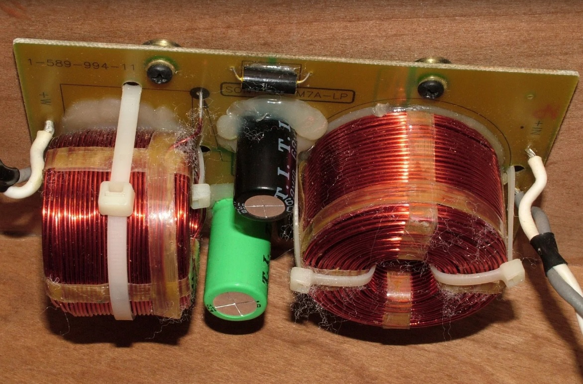

I'm not holding my breath on the capacitor fix. Old electrolytics hold their act together even after 30 years in my experience.

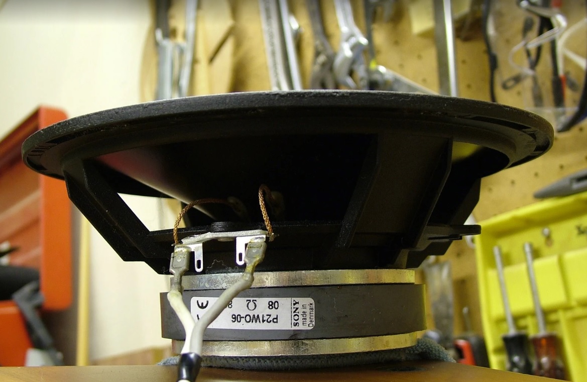

Whatever Sony currently call that bass, it's either a Vifa P21WO or it isn't. "A rose by any other name would smell as sweet..." as the Bard of Stratford put it. 😀

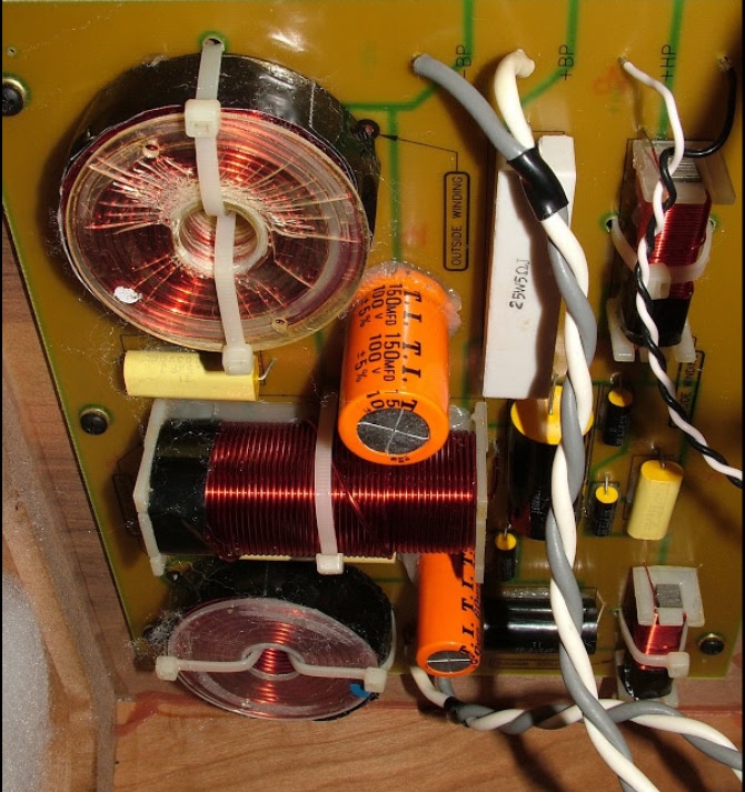

I'm not holding my breath on new caps being the solution either. I do have a cheap capacitance meter and will measure the old ones after I desolder.
I do believe the bass crossover is 24dB/octave already though as I thought I read that somewhere and it does use two caps and two inductors.

Regarding the bass driver and it's a close relative to the Peerless 21WO - I don't know for sure, but I did see that someone had a unit with the aforementioned Sony branded bass driver with part # P21WO-06, so it seems likely they're related in some way.
I notice that the Peerless 21WO is also a 8ohm driver. Do they make them in lower impedance versions and would using a lower impedance driver (4 or 6 ohms) result in more bass than the original 8 ohm?
The Bass inductor will probably have a significant DC resistance being air cored and built to a budget, and also could be measured for inductance.
I found a cheap inductance and capacitance meter invaluable when trying to assess crossovers.
I have replaced a bass inductor with one with lower DC resistance in the past with pleasing results. Subjectively sounding much better to me!
So if I could get an inductance meter to verify the value and measure DC resistance, my goal would be to find another indicator with the same inductance value but as low resistance as possible, tight? And do it for both inductors in the crossover.
Stay with air core options or would iron core options have less resistance? If so, am I giving up anything significant by going air to iron core?

Lowering DCR in a coil is not in and of itself a good thing though.
Sometimes that is part of the baffle step compensation, at least how Troels and I do it. In other words, I carefully slect the DCR, as opposed to going with the lowest.

It's a case of swings and roundabouts on the air core versus iron core argument!
I would favour air core wherever possible. However, to obtain large inductance with low resistance requires many turns of thick gauge copper wire. This means they're expensive!
An iron core gives the required inductance with fewer turns of wire which can therefore be thinner for a given resistance. So iron cores can work out cheaper. They can also saturate at high current levels, leading to audible distortion.
Unless you want to buy more expensive, lower resistance air cores, I would stick with the ones you have.

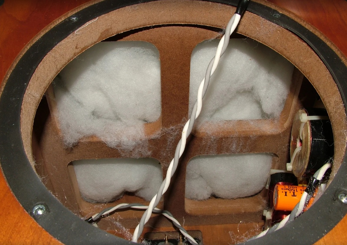

I removed a bale of stuffing (see pic) from each speaker. It was really packed tight in there. I need to check, but I'd guess there's still about two similar sized bales still packed behind each woofer, so I took about ~1/3 of the stuffing out and the chamber is still filled with stuffing - just not nearly as tight.
There's also a chamber below the bass enclosure filled with this stuffing as well - see pic with the four open areas that allow you to access the chamber. I didn't check to see how tight it was stuffed in there and just left that alone for now.
Also, the midrange driver has its own isolated enclosure behind the driver, but the chamber around that isolated enclosure I believe also has some of this stuffing around that.
In any case, the bass really does seem to have improved significantly! If I had heard them like this when I first tried them, I probably wouldn't have noted any lack of bass.
I'll still recap the bass crossover electrolytics when I get the new caps in, but I would say my fundamental problem has been largely addressed. Thanks guys!

Are there any guidelines or rules of thumb to help me zero in on an optimal amount of fill, or is it just a matter of trial and error?
If you have stuffing near the driver It lowers q more (reduces bass thump basically) than when It's further away, so best to try and keep It as far away from the driver as possible. Some say It's best to have some on the opposite wall to the driver to try and stop reflections from coming back through the cone but this obviously depends on the crossover frequency and slope (how much midrange Information the bass driver Is producing)
Stuffing should never be tightly packed IMO. I like to make sure there Is some at the top and bottom of the enclosure but It really Is best to experiment.
Once you're happy with the amount of stuffing you can weigh It to make sure you have equal amounts In each enclosure.
Back in the day of Edgar Vilchur's Acoustic Research speakers, the stuffing used in closed box acoustic suspension (which uses a heavy cone with a powerful motor, almost a reflex driver, and the air spring controls displacement in a very linear way) was hugely heavy and nasty glass fibre.
The theory says enough stuffing effectively makes the box 25% bigger. But there is a limit to how much you can add before it makes things worse. In my experience, stuffing near the driver makes it sound congested.
Nobody fits heavy stuffing any more with closed box. A bit of foam lining the walls and a bit of BAF fluff in the middle. It does more for the midrange really.

Stuffing near the enclosure walls should be high density.
Stuffing in the middle of the enclosure should be lower density (tease out the BAF wadding).

I took out another 1/3 of the stuffing, so now there's only 1/3 of what was originally in there, packed near the walls and away from the driver. I can't say that it's obvious w.r.t. the difference between having 1/3 and 2/3 of the original stuffing in there - only that both are far superior to having all the stuffing in there.
When the caps come in, I'll recap the crossovers and add some stuffing back in. I'm not confident I'll be able to tell when I've reached the optimal point, but I'm pretty pleased with how they sound now compared to when I first got them, so it's all good.
