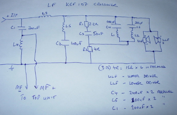

This is my first post on diyaudio. I have been tinkering with hi-fi for years, but I confess, I am no expert. I am here to seek help from the more experienced and knowledgable on this forum.
I'm posting in this thread, as I am looking at any possible changes to the 107 crossover, to compensate for removing the Kube out of my system. You have to wonder if Kef missed a trick with these speakers by using op-amps ( NE5552 ) ala Kef Kube to perform EQ . I realise it's an important aspect of a loudspeakers interaction in the room, but the Kube in my view is a sonic disaster.
I went to the trouble of bypassing all except one I/V op-amp in my Sony SCD-1 ( please have a look at this site, this guy talks sense http://www.lampizator.eu/ ) only to have to plug into the Kef Kube with average op-amps and a "Made in China" cheap style AC supply to ensure the correct in-room response.
I am tracing through the crossover in the 107 to see if any compensations have been made. I half expected to see that the LF section would have some attenuation via L-pad resistors, but it does not look like this is the case. Perhaps the MF unit is attenuated less than it otherwise would be ( 96db sensitivity ) ? I've not got that far yet, I've only looked at the LF section so far.
I have attached the 107 Low Frequency Crossover circuit diagram.
To me, it's an odd looking circuit for a LF crossover ( to what I've seen before ). On first inspection it appears that 2 notch filters are being used, C4/L1/R2 for 60Hz ( mains ripple perhaps ), and C5/L2/R2 for 150Hz.
Any assisatance on this would be very much appreciated.
Also, Is R1/C3/R2 for impedance stabilisation ( Zobel ) ?
I hope this saves time for others, I asked Kef for a circuit diagram, but nothing so far. If anyone has a proper circuit diagram, that would be very welcome too. I will trace the MF/HF unit next, but does anyone have a schematic for this ?

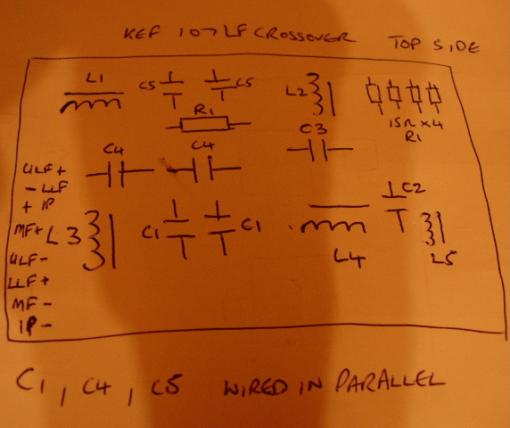

Attached is the LF schematic for the Kef 107
Now I have the inductor values I can work out the notch filters.
It seems odd to have 2 notch filters where the LF roll off is 150Hz.
My colleague told me that the lower frequency notch may be to filter rumble.
You'd expect this in a phono stage, but not in the crossover.
Perhaps I'm missing the purpose of C4/L1/R2 and C5/L2/R2 ( as in my drawn out circuit, not the Kef original )
I think the bass from the 107s are spot on with the Kube in circuit.
However, the Kube makes the sound less refined, but you definately notice a loss in bass balance without it.

Most of the complexity of that crossover is due to impedance
compensation, the 107 appears nearly a constant resistive
load to the amplifier. Arguably it is total overkill and not a
good idea, IMO maximising the impedance whilst minimising
to a degree the phase angles is the most amplifier friendly.
FWIW (seeing this is diy forum) it is quite possible to build
a 2nd order high pass filter with a Q ~ = 2 (max gain 6dB)
around the feedback loop of the power amplifier, assuming
the amplifier has the standard "op-amp" topology.
/sreten.

Thanks for responding
I'm using 805 valves from Meixing, so no op-amps. On first examination it appears to be a 2nd order ( 12db ) crossver, with impedance stabilisation circuit, and notch filters.
Isn't the LF rolloff set by L3 ( - L5 ) and C2 ?
L5 in parallel is a small inductor coil ( subtracting from the series inductor ). I maybe wrong about this. I was wondering if Kef used the small inductor L5, to reduce the inductance on L3, just to use a stock value that they had an abundance of. Who knows their thinking ?
I know that the Kef 107 crossover point is 150Hz.
I think that R1/C3/R2 acts as impedance stabilsation circuit,
and C4/L1/R2 and C5/L2/R2 are notch filters.
I'm thinking of ditching the impedance stabilisation circuit all together, and seeing how the amp reponds to the Kef B250 behaving in a non-linear response. I guess Kef don't have this luxury, they won't come to my house and see how my amp behaves when they're designing their impedance stabilisation circuit.
I think I understand what's going on in this crossover now.
Here is what Stereophile wrote about the 107
So I would expect to see a resonance notch filter somehere around
20Hz, right ?
Not all all. Either Stereophile didn't get the chance to look at this crossover, or they were fed some BS by the Kef Marketing department. This reminds me of their so called speaker/crossover matching and having your serial numbers on file .. ;-)
The service people at Kef, know this is BS too. They never asked me for the serial numbers when one of my drivers blew, and all the crossover values are the same.
Hand picked capacitor values, possibly, but I think not ..
L3 / L5 and C2 set the LF-roll off at 122Hz ( 6mH + 1mH and 240uF )
I worked out that the LF crossover with 7mH and impedance of 4 ohm for 2nd order Butterworth would make C2 at 220uF.
This would have made the crossover 128Hz
Maybe Kef had a surplus of 240uF values in stock, and I suspect that the use of the 1mH L5, is to get the desired crossover cut-off Fc.
Actually it makes little sense, why not just use a 7mH coil, as they have for L2.
The MF filter of 200uF and 6.4mH sets the high pass at 150Hz which goes off to the MF/HF unit.
L1/C4/R2 ( 33mH / 480uF / 4 ohm ) is a notch with resonance peak
at 38Hz.
I'm confident this is the free air resonance of the Kef B250. I can't find the specification for this unit anywhere .. HINT .. HINT
Anyway, it's not 20Hz ;-)
L2/C5/R2 ( 7mH / 200uF / 4 ohm ) is a notch at 128Hz
R1/C2/R2 is the conjugate loading or impedance equilisation as commonly known.
Having dug out one of my old audio design books and read up on amplifier / speaker stability, it started to makes sense. The second notch is at the crossover point.
I agree sretan, this is overkill.
I like that they are going for a flat response, but with a roll-off at 128Hz, you have to wonder if the second notch is a step too far
I think that Kef have tried to make the speaker load seen by the amplifier as purely resistive. As you say, this has it's own problems with phase shift etc..
I wonder how many other crossover designers use a second notch at the roll-off point
Here is an updated drawing I made. The Kef original is not the best quality
Rather than the guessing that is going on here, perhaps I can fill you in on exactly how this network was designed.
In refering to component functions I will use the component nomenclature used in mwaters10 latest diagram, as this is easier to read than the supplied KEF drawing.
First, the impedance compensation (conjugation) is for the purpose of flattening the speakers complex impedance curve before adding the low pass filter network. The bass system utilizes a coupled cavity bandpass configuration, the by-product of which is an impedance curve that reacts very badly when trying to drive from a passive low pass filter. The upper impedance peak of the system is very close to the desired xover frequency. Without impedance compensation it is next to impossible to design a low pass filter of the required caracteristics without suffering big response irregularities and/or severe dips in the input impedance.
Therefore full conjugation of the equivalent circuit of the loudspeaker is employed. Since a coupled cavity produces a double tuned impedance characteristic, similar to a reflex system, then two branches are used to compensate this, components L1 - C4 and components L2 - C5. Additionally C3 - R1 compensate the voice coil inductance, and R2 the voice coil resistance. This configuration is an exact dual, placed in parallel, to the equivalent circuit.
So, it's main function is not to make an easier load to the amplifier, but to make an easier load for the network.
Under no circumstances would I advise that you ditch the conjugation components.
Now, L3, L5, C2. These form a low pass filter, but a notching low pass filter (C2 and L5 producing the notch at around 330Hz). Because of the long length of the port in the coupled cavity, there was peak in the response of the vent (the vent being the sole output from the system) just as the acoustic response was rolling off. The notching low pass filter compensated for this peak, so that overall the filter plus speaker, rolled off as a fourth order acoustic response.
As for driver and network component matching, I cannot attest to what is done these days, but in my time we measured every driver that was built and sorted them into tight tolerenced sensitivity bands.Then we would draw up a matching table for how to match bass, midrange and tweeters together from different sensitivity bands to insure the best overall system responses.
The computers that were used for design were the same as for production measurement, and were located in the same room. At any time I could glance over and see how close the daily production was to the reference driver, and I could exctract that data and input it to my design programs if needed.
Records were kept of all drivers and their sensitivity tolerence and the serial numbers of which systems they went into. Whether service continued to use this info for subsequent replacement I cannot say, but the information was certainly available.
For the xovers, all inductors were wound in house. Design engineering would specify how many turns were needed to wing the inductors into specific 1% tolerence bands around the nominal value, so we made inductors over a +/-10% tolerence band.
We then measured and sorted the capacitors and resistors into 1% bands from initial incoming of 10%.
This then gave us a stock of components all sorted into 1% tolerence bands. We would then look at the network design, all of which was done with computer optimisation algorithms written in-house, and perform a component sensitivity analysis. We would then deliberately perturb, one by one, each capacitor by 1% at a time, re-optimise all the network components and draw up a compensation table that told us how to pick the components values to match together to get back to nominal response for the network.
This allowed us to use components from all the tolerence bins, avoiding the very high cost of buying tight tolerence components.
These are the tables you see all around the network on the KEF
drawing.
Next, the KUBE itself.
Yes, the system was designed with the KUBE as an integral part of the overall bass alignement. You will definitely get an odd bass response if you don't use it.
Yes it is full of opamps, and I know that these don't measure up to modern types.
If you are into doing so much modifications, the best route would be to convert the system to bi-amplification and then insert the KUBE only in the bass amplifier chain. This would avoid any of the concerns of the sound of the KUBE throughout the mid and treble at least.
Unfortunately I don't have samples of these KUBES any longer, otherwise I would measure them and offer a suggestion of how to build a better version.
Hope this gives you all a better idea of what went into the design of these systems.

Fair play to you AndrewJ,
It was the first time I looked at this crossover , I think my guessing wasn't miles away , but you are absolutely right, the reasons for the upper impedance peak of the coupled cavity bandapss design was not fully understood, nor the notch at 330Hz.
I had already realised by the time of my last mail that the impedance stabilisation circuit was necessary and would not work well without it ( forgot to mention) .
Thanks for taking the time to look into this.
Your insights into the Kef design and their processes is very interesting and your explanation of the crossover is very helpful
In many ways the 107 design works well, but and as you rightly say, the bi-amp option and upgrade of the Kube makes perfect sense.
As for Kefs' matching, I'm being cynical, but most people would want their speakers matched within a certain tolerance. I'd expect it to be part of normal process, who would think an unmatched pair of speakers was a good idea ?
I have to admit that Kef have always been a good company to deal with, and their service department are still pretty good, in comparison with most modern companies and their annoying automated voice mail systems.
One thing that does surprise me is the absence of resistors ( L-pad ) in the MF crossover.
I expected the B110 MF unit to be a higher sensitivity than the B250.
Do you think is it possible that the crossover for the B110 and T33 is
matched for sensitivity only when the Kube is in circuit ?
Do you think the MF/HF units sensitivity could benefit from being attenuated when the Kube is not in circuit ?
The MF/HF drawing is coming next ..

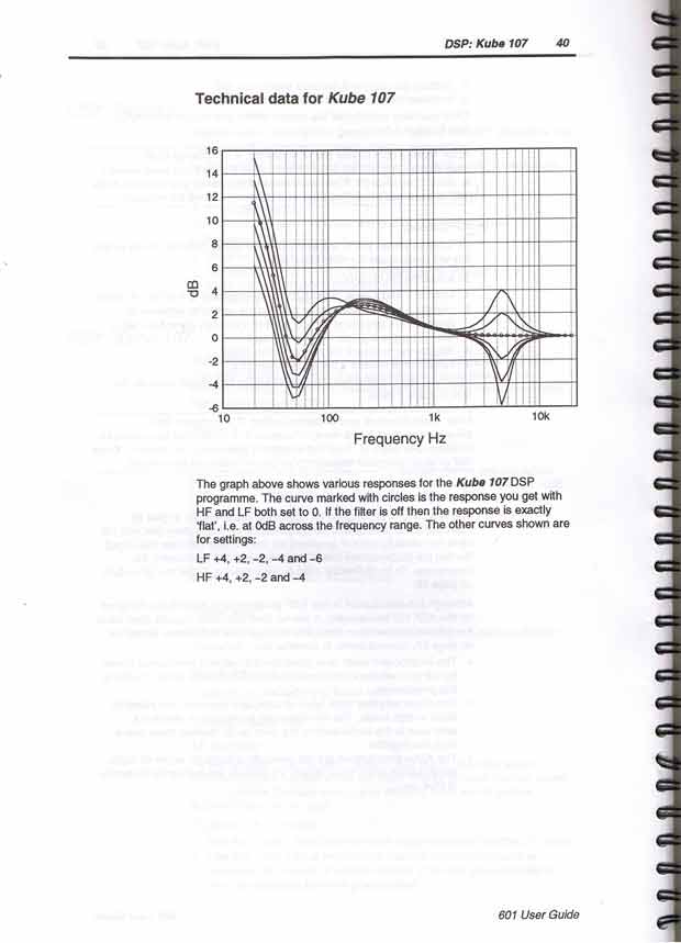

The diagram in the 601 manual shows a mid-band shelf drop that isn't there in the Kube 200 emulation. I'll post it up..
Obviously it is based on the 107/2 Kube with LF HF Contours rather than the Extension, Q-Factor and Contour controls of the previous version. Does anyone know if the resulting curves are much different?
To correct myself, looking at the Kef diagram this time, all I need to do is cut into the tracks before C7, C8 and L5 (using the Kef nomenclature - and not named on mwaters10's diagram) and have the MF/HF input enter there?
