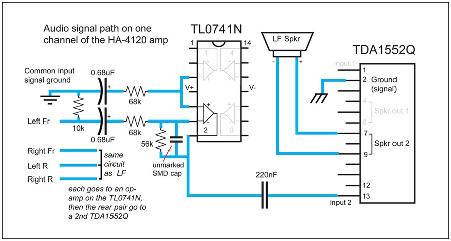

It is an old 1990s Volvo car amp - 4 x 20W (#3533004 or HA-4120) - works ok and would be fine for the tweeters. It is very simple - not much in there - a pair of TDA1552Q which are 2 x 22W BTL. There is a transformer, but the supply voltage to the amp chips is not increased from the supply amount of 14.4v.
Attached is a circuit diagram of one of the audio signal paths in this amp - so it can be assessed regarding changing caps for high-pass - I tried to make this image using an online circuit creator, but this screwed up so I just drew it offline. It is one channel, but all four are all the same obviously. Though - I do 'get' that the best option would be a pair of active crossovers...

You can measure the DC voltage on the negative signal line to see if it's 0v or something near 6v. The signal line should also be very near 0v but leakage through capacitors may let it float slightly

What is the 20w/ch amp that you have.

For that circuit, I think I'd simply insert a 3000pf cap in series with the positive signal input and work from there. I can't say whether that value will definitively give you what you want. You could go with a higher value if you don't need so much filtering. This should be for about 5000Hz. Someone should correct me if this is wrong.
