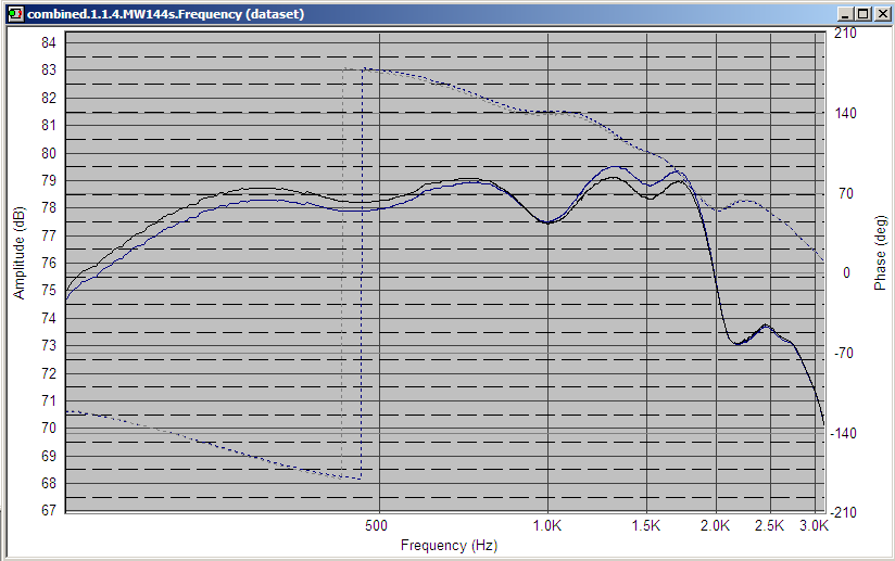

personally I would say that the L3 would make the biggest difference (which may be still quite small) if the DCR value is changed. It is part of a notch filter, and my experience with notch filters has been that they are much more sensitive to component variations than other areas of crossovers.
Given that, I just simmed one of my crossover inductors (in a 1.3K notch) with an increase in DCR from the actual 100m ohms to 300m ohms, and it resulted in approximately 0.5 db change (less cut) in the notch, and a bit lower overall spl at frequencies below the notch frequency (due to the higher DCR).
Attached a picture showing the variation. Note that these sims are very accurate. Blue is the higher DCR.
Second picture is with the normal values for the notch, but the DCR of the series coil increased from the actual (black) value of 117m ohms to 300m ohms.
