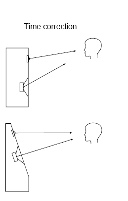

You can say there is a phase relation with the xover alone, but this is not the case because you have real drivers. (That's a common mistake). Also phase changes in frequency. You will have to measure the phase for the drivers and then simulate it with the xover. If you can not do that (measurements) for the time being, we can have a (very similar/other/parameters) speaker drivers simulation with your posted xover. Don't forget distance (between center of drivers/angle) is also important in this case for time alignment (see graph).Hi guys,

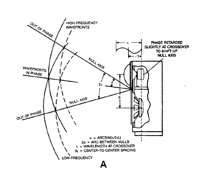

Always nice to know. Congratulations for your career. I was most introduced to the subject by Wayne Parham (...and his nulls).Nice picture attached. Hmmm, looks familiar.
David Smith
Designer of the JBL 4430
(Sorry Dave... my favorite is the JBL 4350B)
Too big, I always wanted a pair of 4315s.
Here is where the diagram originally came from:
Improvements in Monitor Loudspeaker Systems
David
