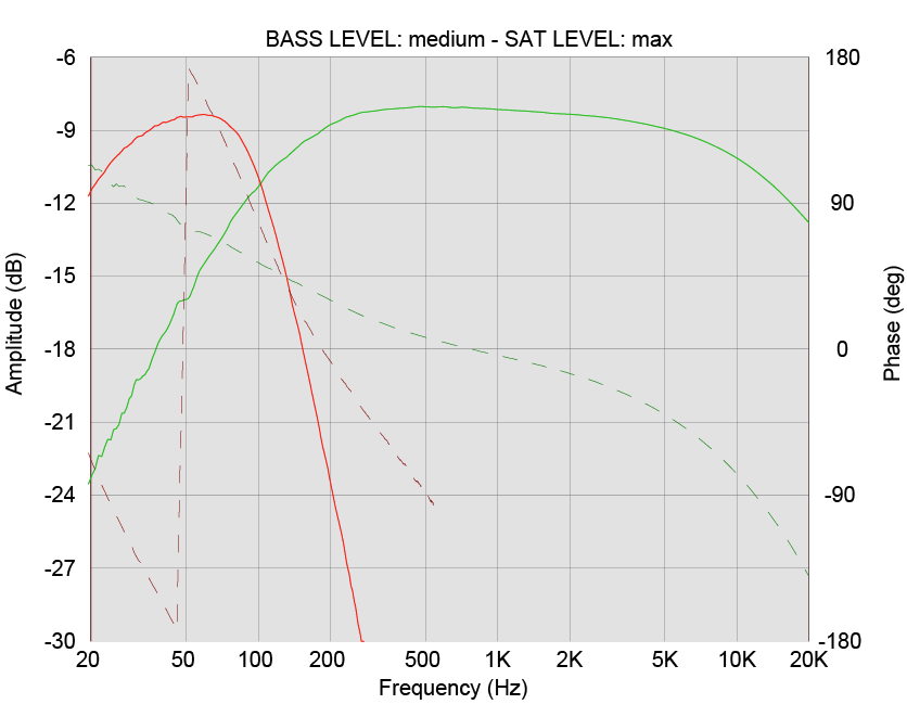

AIYIMA A03 Class D 2.1 Amplifier TPA3116D2 Bluetooth 5.0 2x50W + 100W 4 Ohm
I measured an older version of a similar amp some time ago, it was "AIYIMA TPA3116 Subwoofer Amplifier Board 2.1 Channel High Power Bluetooth 4.2 Audio Amplifier Board DC12V-24V 2*50W+100W".
the bass low-pass on that amp is 12 dB/octave (2nd order). it seems the output is inverted (180°) for correct integration.
the satellite high-pass is 1st order (6dB/oct),
there is a switch on the amp board that enables the stereo output to be high-passed or not (fullrange output to stereo speakers).
measurement was done with sat-high-pass enabled, treble on minimum, bass level medium, sat level maximum (only one channel was measured).
by the way: crossover frequency regulation only affects subwoofer-low pass frequency on my amp!
Thank you! This was the answer needed here and for the next one who has similar question. When looking at the phase and SP graphs it seems not so bad as I thought it could be. Phase is rotating on the same direction and can be set quite close on overlapping area until it drops out of hearable range. Should just choose some better model of these amps and give a try. As with sub it is plain simple position question to adjust timing later on.
