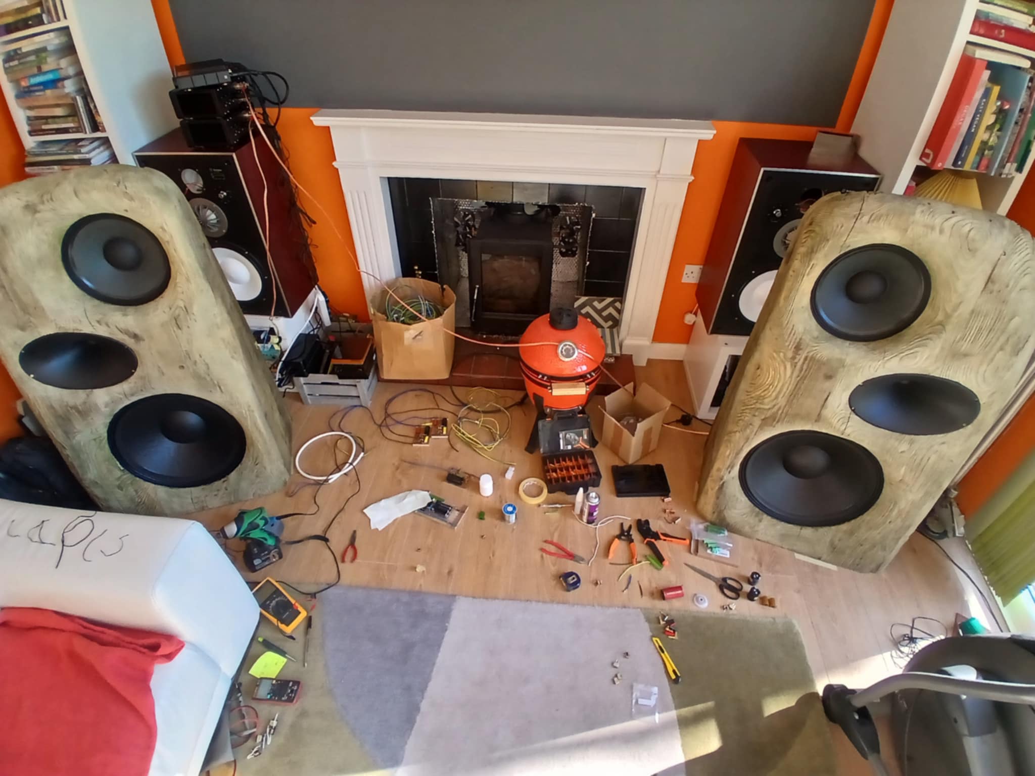

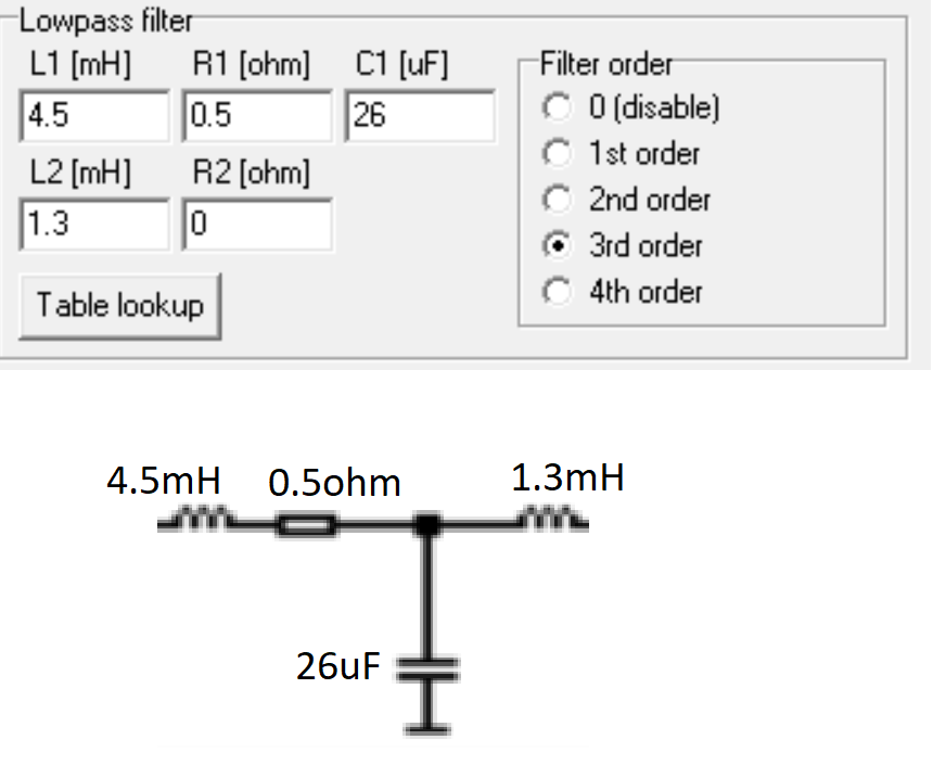

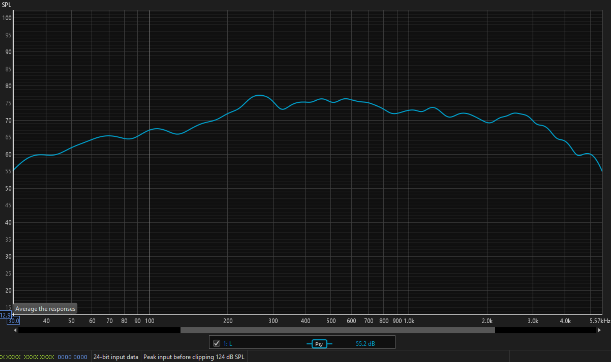

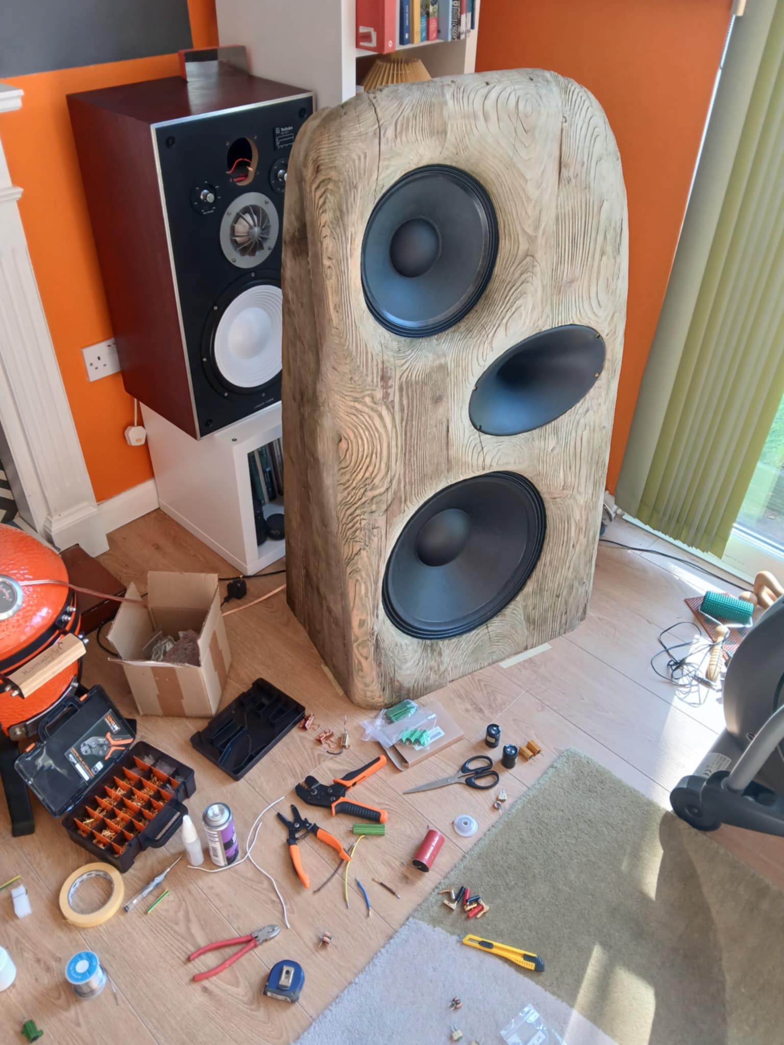

So I am trying to build my first speakers, and I got stuck (obviously) with no idea why predicted crossover and real implementation is way out of acceptable range?
I will attach program I've used and response graph and photo ,of loose and glued implementation. I do hope for help. Thanks in advance

Sorry, couldn't see reply. Sure its sounds horribly wrong. Without crossover no issues, with crossover REW says ~108 distortion, and sound extremely bad...
Even just inductor of any value(toroidal) sounds horrible.

It's not easy to guess what's going on there but those inductors are not the right type for this. Not only are the cores the wrong material but common mode chokes will be limited when wired the wrong way. It's possible you're shorting the amp with the capacitor so I'd stop using them like that.
Magnetic cores for speaker inductors must have a gap to have minimum linear behavior.
These toroids don't seam to have a gap. Do they have?
They get very non linear and will saturate very easily without gap.
I'm in favor of using iron/ferrite cores, but with air gap or the core being just a rod.
In addition, you need to know how much magnetic flux density you are applying to the core to make sure it is below the saturation level.
For ferrite, something below 0.2Tesla and for iron core below 1Tesla. The lower the better.

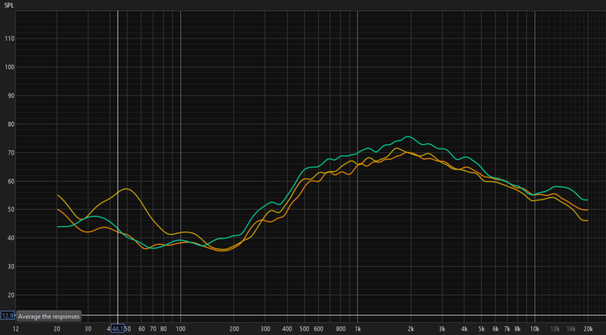

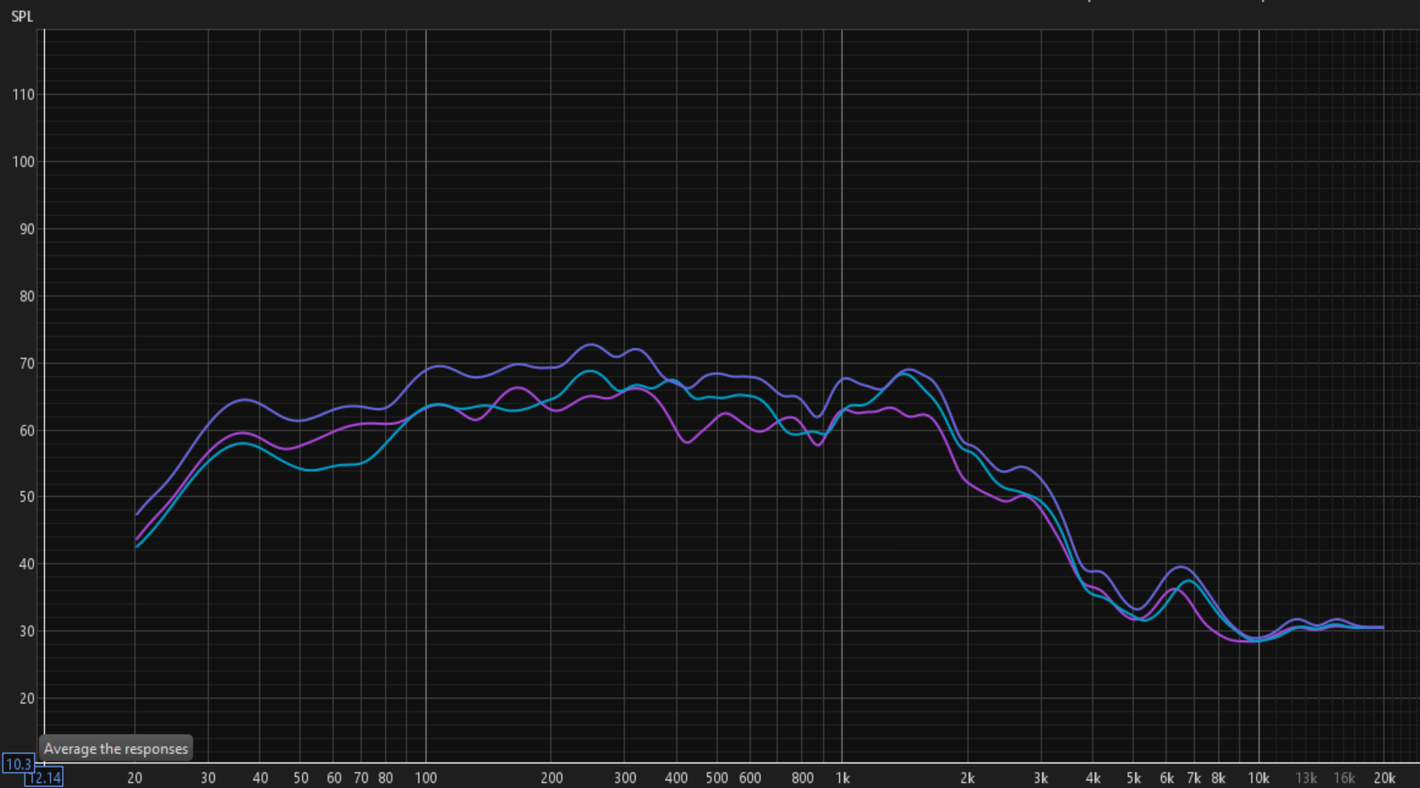

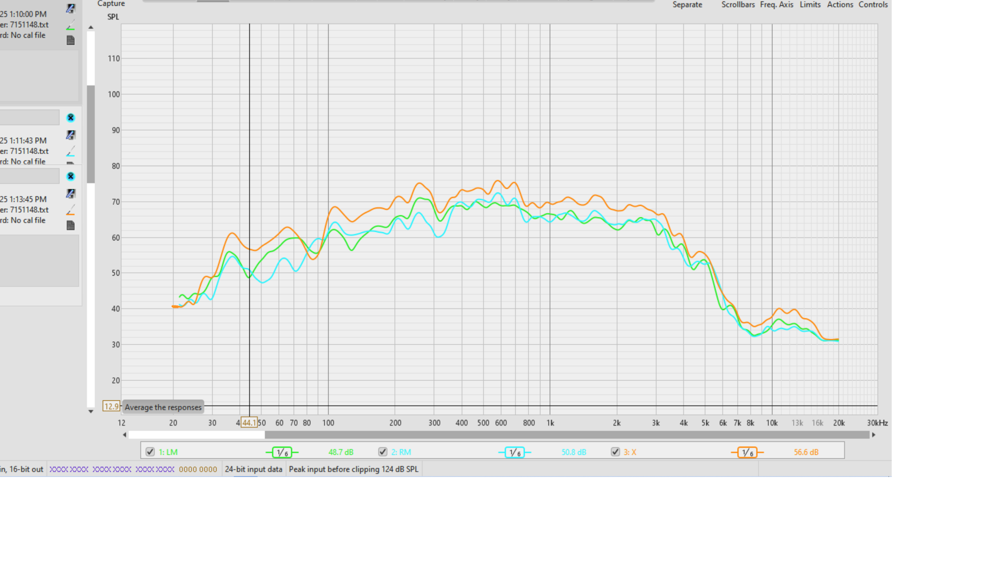

Here are REW measured Tweeter(Left - right - and both), same mids and woofers. Have ZMA files available.
I have bought all equipment needed even to try to accomplish this.

The dip down towards 200Hz is not there without the crossover (post #3) and this doesn't make a lot of sense. I don't want to confuse two things at once but is this an open baffle design?
I wouldn't judge this until you have the crossover and room positioning sorted, so hang in there..
Yes, it is open baffle designe. I get a dip at 200hz if I leave mids in same polarity, but if I switch it gets gone. I can upload how it looks in same polarity. Also, I had room resonance at 35 hz, which would spike up all low frequencies to one 20db higher than rest spike, and I have tamed same with tuned low trap. Interestingly enough, now I don't have spike on ordinary boxed speakers, but I still get bigger low output on open baffle, and I think is good.
I have measured maybe three days in a row proper baffle placement, found nice continuous curve for midrange, but when I measure tweeters now - separately each chanel is perfect, but stereo gets bumps at 12k and 16k. Why is that? I thought it's too high to influence each chanel 2meters apart, and horn loaded...
