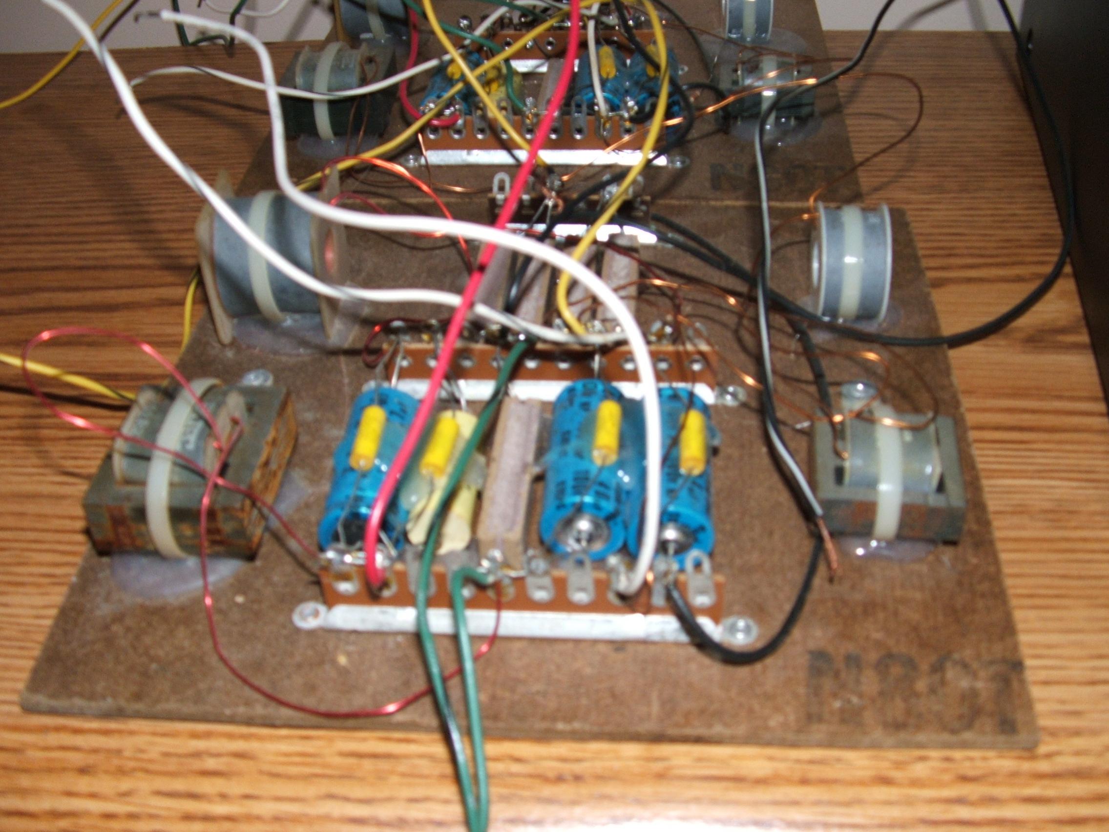

Your choices are to get an amp that can handle 4 Ohms or less or work with 8 ohm drivers and crossovers. The speaker drivers are what's dictating the impedance, not the crossover. The crossover is designed around the impedance of the drivers.
For example, in an 8 ohm, 2-way design that crosses over at 2000Hz, it will have different value crossover components (capacitors, resistors and coils) than a 4 ohm design.

Your crossover is passive, high-level. It goes after the amp and before the speakers.

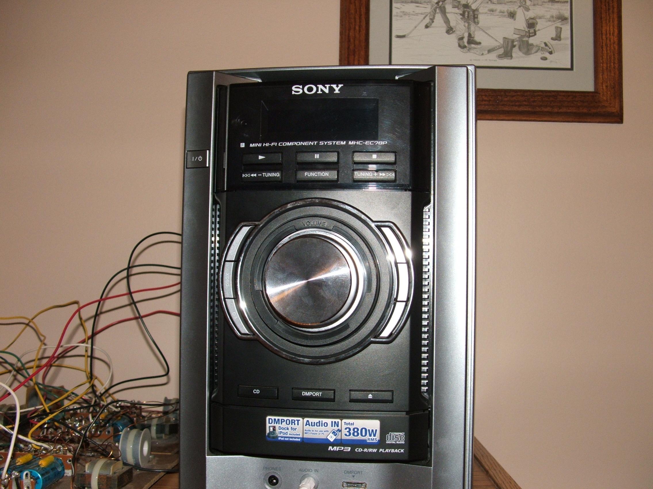

The crossover is not your problem. The amp is your problem. It can't handle the current of a low impedance driver(s). It over heats and goes into protection.

You're not listening to what people are telling you. The problem is not the crossover. It is not 4 ohms, it is designed for 4 ohm speakers, that's what the rating of 4 ohms is. Also it is an off the shelf type so while it may work, it isn't designed for your specific speakers so it's not ideal.
What you need is an 8 ohm load to your amp so if you get two more of these speakers, you can wire them in series to get that 8 ohms. Otherwise you will slowly wear out your amp if you continue the way you are.

The simple answer is that you do not want to use 4 ohm speakers with an amp that is only capable of handling an 8 ohm load, you will damage your amplifier.
The first picture is my current crossover. I used this with my old setup. it is 8 ohms and works with only my tweeter, but not my woofer(which is 4 ohms). i could keep this crossover but i want to use my woofer. The crossovers i want are 4 ohm, 2 way. It would take the main channel on my amp and convert it to woofer and tweeter. The tweeter measures about 6 ohms which is the minimum on my amp, and works with the old crossover(made in 1980). It would also work with the crossovers i want. If all fails i can sell those 4 ohm woofers and get the dual 4 ohm version and use old crossovers. But thats not what i want to do.
The second picture is my amp. Which is around 100 watts per channel RMS. I really like this amp due to the iPod docking and features.
The third picture is just what it says on the back about use 8 ohms. And PLEASE dont tell me about it saying low frequency cause i have tested it and it full range.
