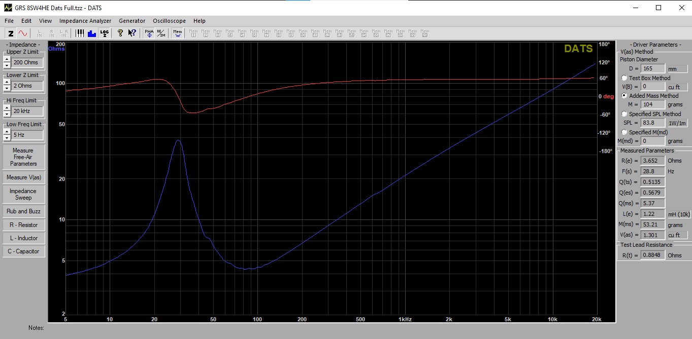

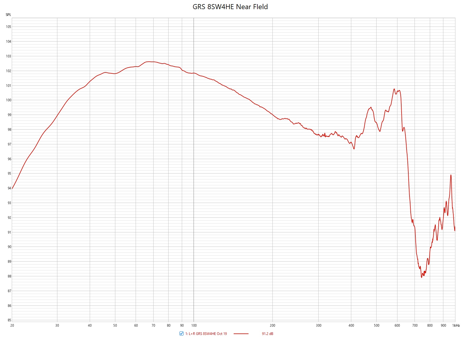

Just pulled out a GRS 8SW4HE driver and measured it.
DATS with measured T&S:
Near field sweep:
Totally dead from 700hz and up, could hear it go.
But that 400~600 range could be possible? Maybe? Kinda rough?
Crossing with this planar (PT6816-8):
Right around 500hz? 600hz? Doable?
I know the sensitivity doesn't match, but could pad the planar back down to flatten it up.

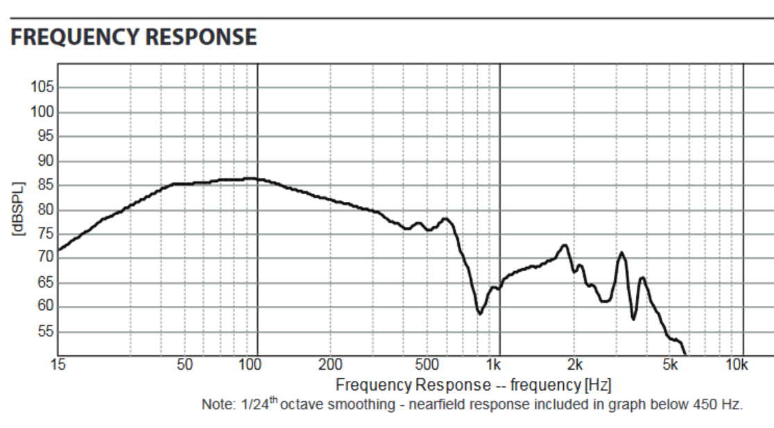

The work was already done for you the manufacture response graph clearly shows no response to 700 HzThese are fun little drivers, if I could get them to work with a 500~600hz crossover....
(I actually have 2 of these sitting in boxes doing nothing, I could test to see if they actually make it to 700hz... be right back!)
most of that is dictated by the voice coil inductance around 2.7mH
To have more upper bandwidth it would need to be way lower more than half for a 4 ohm coil.
Perfect example is the 4 ohm SD270A-88 the inductance is down to 1.1 mH which is why it has more bandwidth.
Inductance of voice coil creates a low pass filter in all drivers.
Even in a simple model like WinIsd it will include electro mechanical behavior in the transfer function.
In this case if you entered the inductance in you driver data in WinIsd the transfer function would even show the
highend roll off. Of course the actual real world response is shown with the datasheet or measurement. WinIsd wont predict cone response.
It is only transfer function of the theoretical filter of the driver. I dont think your models showed roll off because inductance ( Le) was
not entered
Anyways -3dB is close to 120 Hz where as a sub 100 to 60 Hz is completely normal crossover.
It simply will not work and as mentioned the inductors would be incredible large and expensive.
wont work, needs midbass driver. Easily fixed with proper woofers for a 2 way

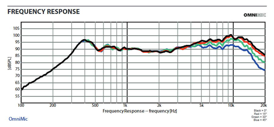

While the manufacturer does publish something, thankfully, I'm used to it being very different when measured when it comes to budget GRS drivers. Fun cheap drivers, but the publications are not close I find. I measure other drivers that are pretty good and they are very close to their published spec. So I just wanted to confirm what the cheap GRS was doing.
Updated in previous post. Pretty similar response. The T&S are a bit different as expected, but not in a useful way. Still, good to know what it is actually doing there.
Agreed with what you're saying, I'm just seeing if it's possible to stretch this little driver to 500~600hz. I could hear it audibly and measured it. If it were indeed possible to cross this driver, two of them at 500~600hz with the planar mid, I would try it. I have them, so why not? I can cut some holes on scrap just to see how it looks on a baffle width.

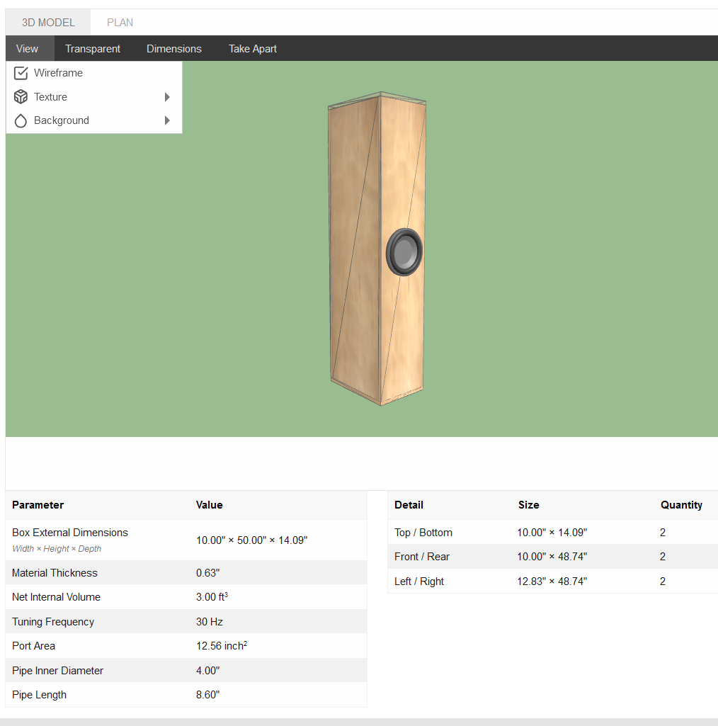

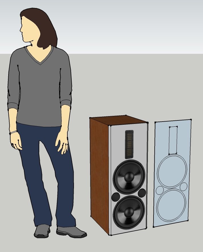

Thanks, interesting!Basic concept only. Tossed in graphics for fun.
Mainly to see if 12 x 31" tower form factor size is ok
Form factor only, drive locations and port will likely change.
I was thinking taller, to take advantage of some lovely oak slabs. Planar, 1 woofer in the front, 1 woofer opposed in the rear (dual opposed, cancel vibrations internally), 1 port in the front. Keep a lot of baffle area showing to show off the lovely oak slab under some epoxy.
Very best,

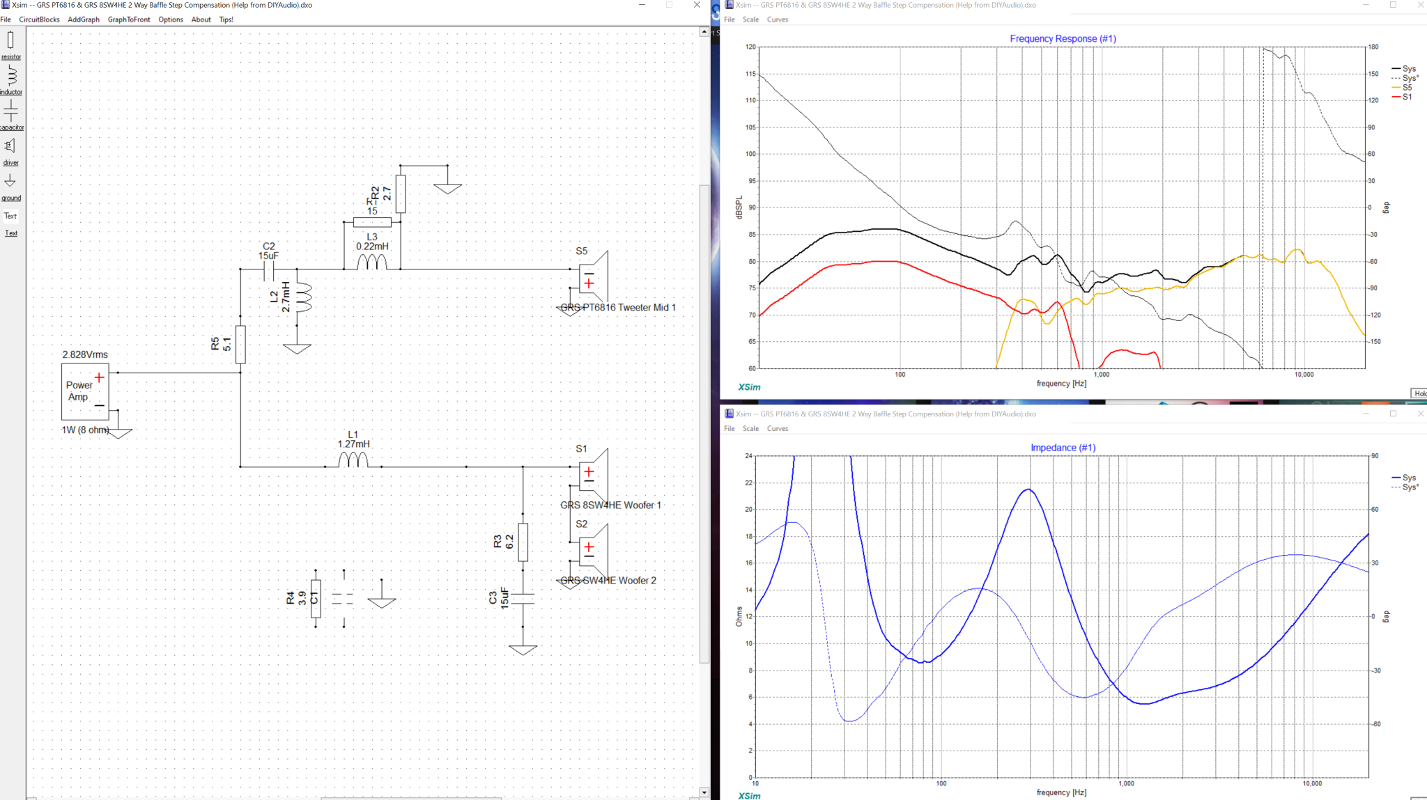

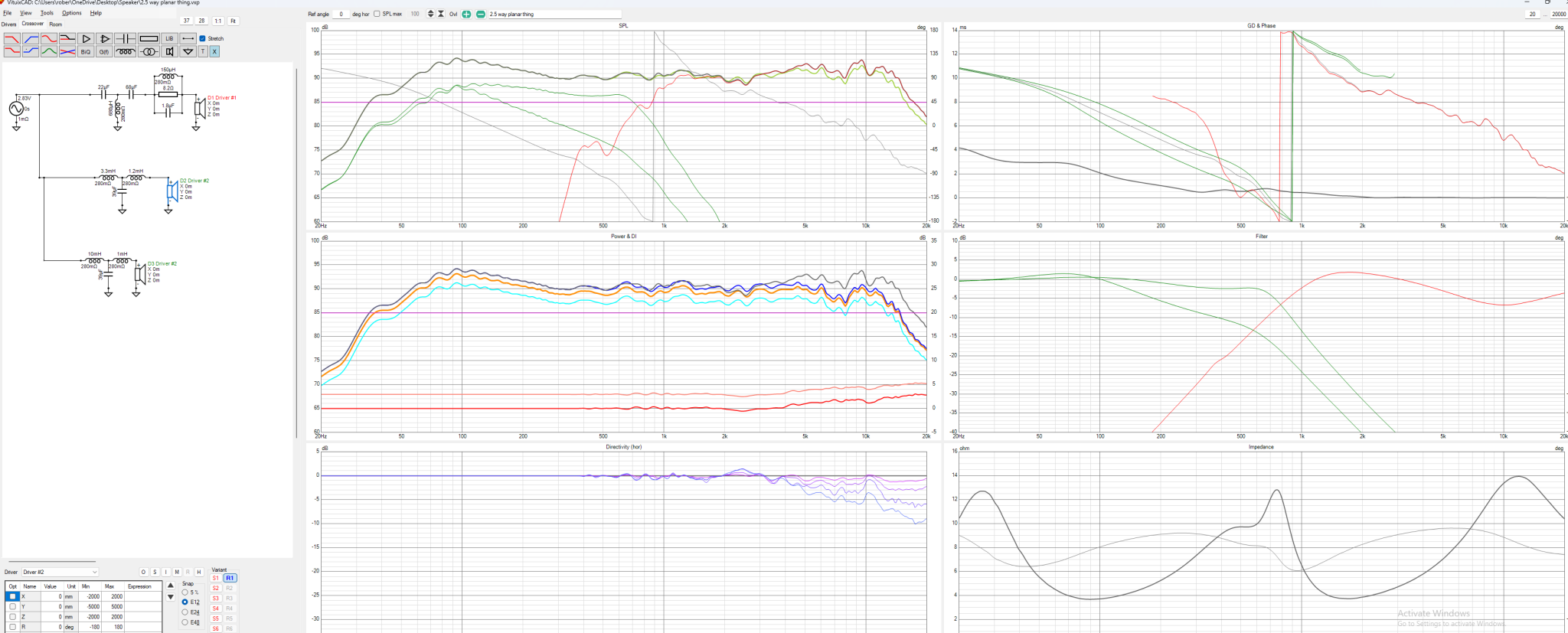

Just a quick whirl in Xsim:
It's not pretty. But it looks functional as a starting point perhaps.
Any glaring mistakes?
Totally doing this wrong?
Ditch this driver?
PT6816-8 x 1
8SW4HE x 2 (in series)
Xsim file attached for play.

Understandable now you already have the drivers.
But no it is rather horrible, not trying to sound mean either.
It would just not sound good at all.
The baffle response hasn't been modeled either, but that is the least of your problems.
No worries! I'm happy to be told frankly that its bad so I can easily just shelve them again and move on. I bought them a while back, lovely little drivers, but finding that they're only ever going to be subs or blended with full range drivers at much lower frequencies like 100hz and will require low pass filter as no passive crossover will handle it at 80~100hz. I'm ok with hard love! 😀 I appreciate the frankness!
I can now move on back to 8's or 10's woofers.

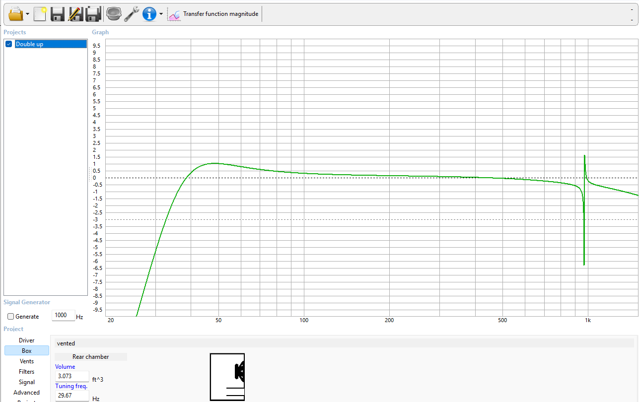

I second the 2.5 way. 2 RS225-8 woofers should play plenty low, and still be able to reach up higher to make the crossover a bit easier. The "knee/bump" just below 500hz is a pain in the butt.
The WinISD model is with a single 3.5inch port.
Example:
Very interesting, thanks for the models, that looks pretty smooth. This is a huge speaker for only getting to 40~50hz though. Hrm. Will have to ponder on this.

And have that actively power whatever sub drivers I want. Could go sealed. It has a +6db boost at 30hz. I could model that and see if I like the results on some sub drivers. Or go for bass reflex and peak it around 30hz and use that too.
This would be much easier. No crossover. Just involves more electronics and requires pre-amp out from the source, so it would always need an AVR or stereo amp with pre-amp out for subs, etc. I'd probably always have such a thing, but, I just like the idea of not needing it and could work on basic analog. I could also use plate amps that have high level inputs and outputs too, to bypass that electronics need. That would work. It would just require a ton of cables running around. But it is an option...
Very best,
So, thinking about it at work instead of working 🙂whistle:☕) I guess I could do both of these things to make a complete full range tower.
Planar wideband crossed to a woofer at 600~700hz with a 2 way passive crossover. I'll just match similar woofer sensitivity to the planar. Single driver can probably work here, 2 if I need more sensitivity. It just needs to get down to 100~120hz, but could go lower like 60~80hz range even. Though probably 100hz to be realistic and keep it sealed so there's no phase mess to deal with.
Then put subwoofer drivers in with their own plate amp (or external amp, more likely) and low pass filter built in. Can push this to 25hz or so instead.
2 way tower with integrated active subs in each one.
Very best,
Very best,
Hrm,
So maybe pair these in a 2 way around 700hz:
https://www.parts-express.com/GRS-PT6816-8-8-Planar-Slim-Tweeter-8-Ohm-272-128?quantity=1
https://www.parts-express.com/Dayto...Power-Midbass-Driver-8-Ohm-295-636?quantity=1
Take that to about 100hz sealed. Then integrate active subs in the same enclosure with its own low pass filter to avoid needing huge passive crossovers and stuff.
And then the rest of the tower can be sub drivers and active powered separate with its own low pass filter. Either plate amps or separate outboard amp, either way, simple. Sort of answers all the problems.
It's not the same as a wide band planar on its own and woofers, but it's close.
Very best,
