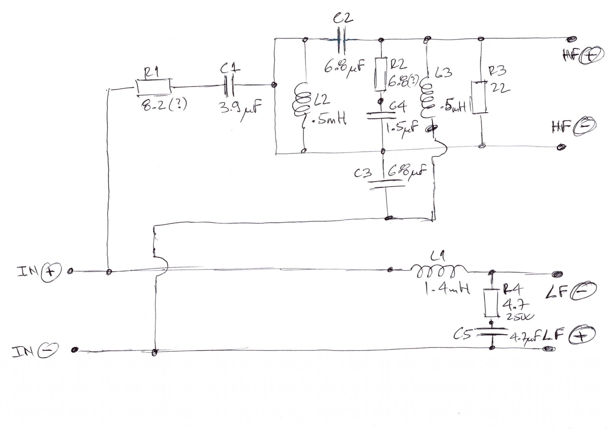

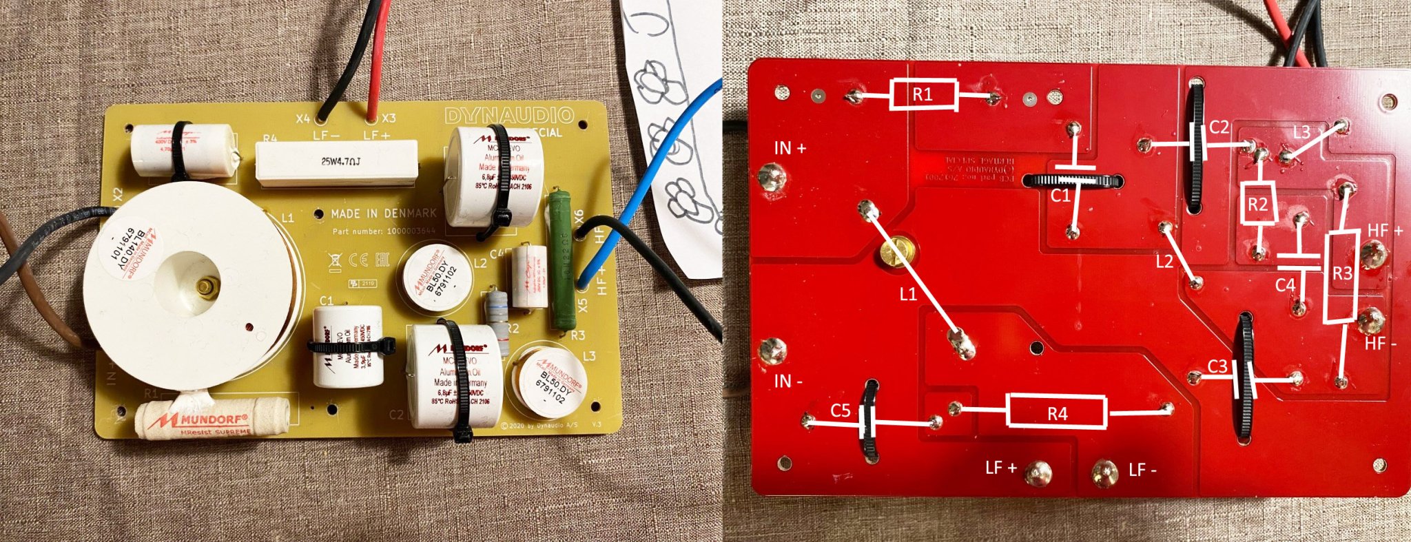

Hey guys I was wondering if someone could draw up this crossover for me - much appreciated! I would like to do some mods to the crossover to tame the tweeter a bit.
Thanks in advance.

I have also attempted to draw the crossover - see attached.
My recommendations for you, to tame the high frequencies, would be:
1. If you also use the streamer, invest in a low-noise linear power supply. Use low-switching voltage CPUs (laptop CPUs). The latest NUC11 with an i7 CPU is perfect. You could run it at a very low frequency, but you'll still be able to run an excellent DSD modulator at 256DSD in HQPlayrePro... whatever suits your needs.
2. Replace the C1 with copper-in-oil Mundorf cap. If you like the improvement, the next step would be to replace the C2 with the same type of capacitor. If you still like what you hear, replace the C3 & C4. Somewhere along this path, you'll hit the sweet spot. You could also try the silver-in-oil type.
3. The last option would be to increase the value of R1.
Good luck. Let us know what you decided, and the result.

Yeah... jump from MCap Evo Oil 3.9uF 25 x 27mm to MCap Supreme EVO SilverGold Oil 3.9uF 46 x 34mm. (bummer, they do not make Supreme copper in oil anymore.. why?????)
You could potentially if you wanted... install the MCap Supreme EVO SilverGold Oil 3.9uF vertically, so that it rests on the surrounding L1, and then "in the air" the C1 would connect to R1 <- which you'll also have to lift one end off the PCB. It can work...
So, instead of R1 and C2 being positioned horizontally & connecting together on the PCB, they would be positioned vertically and would connect together in the air. The C1 would rest on L1, the R1 is sturdy... the whole thing wouldn't move much. You could also use a bit of Blutack just between C1 and L1.. while evaluating the result, and once you are happy ->, put a bit of silicone.
Of course, this would void the warranty.

Well, not really. There is a huge difference between aluminium foil and silver foil sound.
One of the reasons I suggested moving from aluminium foils is because... the copper or silver in oil will sound much better.
I think Aluminium foil is probably the worst choice for that Esotar. Even copper in oil would sound more tamed, spacious, and extended.

All the inductors are still unknown here: "BL140" and "BL50" simply indicate us their wire diameters and don't tell us their part values!
They seem to be custom builds for Dynaudio.
Also a L1 = 1.4mH for a 4Ohm woofer and C1 = 3.9µF with an 8Ohm tweeter don't give a reasonable combination for a 6dB crossover in my view.
Many variables.
The tweeter 8 ohms gets added to the first resistor to lower the frequency.
The tweeter resonance impedance peak would extend that further.
The baffle step might make this dip usable.
The woofer impedance rise may stretch the response.

I bet that 1.4mH is actually 1.8 - 2.2mH. Those 0.5mH should be a bit more 0.7 - 1mH.All the inductors are still unknown here: "BL140" and "BL50" simply indicate us their wire diameters and don't tell us their part values!
