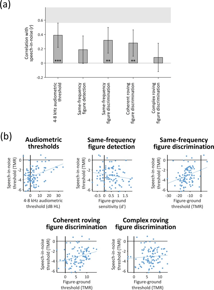

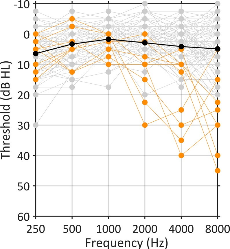

When we talk about thresholds of audibility for one person, it means the level at which that person can hear a given stimulus 50% of the time.
When we talk about thresholds of audibility for all humans on earth, there is no way to measure all humans on earth. The best we can do it to try to make an estimate which is average value at which (usually for people with normal hearing) someone is expected to be able to hear a given stimulus 50% of the time.
The other type of auditory measurement is the Absolute Threshold of Hearing, which is defined as above, except for it applies to single tones only. That's because when tones are combined they interact in the auditory system in such a way as to give different numbers as compared to single tone at a time measurements.
"The hearing threshold is the median value for otologically normal young adults. Consequently, 50% of subjects have a threshold which is more sensitive than the median and 50% have a less sensitive threshold"
https://www.sciencedirect.com/topics/biochemistry-genetics-and-molecular-biology/auditory-threshold#:~:text=The hearing threshold is the,dB below the standard threshold.
Images above taken from: https://www.ncbi.nlm.nih.gov/pmc/articles/PMC6856372/
EDIT: Another thing to consider is that the above type of tests are usually intended to measure limitations of the physical ear, and not the brain processing of certain sounds (which may normally be ignored by the brain as "noise.") In the case where brain processing limits signal detection, and a test subject can be trained to notice lower level test signals, then that's not necessarily a limitation of the ear itself.

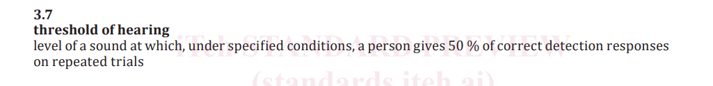

A brief excerpt thresholds from a well known reference on sensory evaluation is attached. It may be noted that the old intuitive idea of a threshold being a sharp cutoff point is often not the best fit to reality, and or for various reasons problematic to define. Modern scientific definitions should now be taking sway.
Also:
Definition taken from ISO 226: https://cdn.standards.iteh.ai/samples/83117/6afa5bd94e0e4f32812c28c3b0a7b8ac/ISO-226-2023.pdf

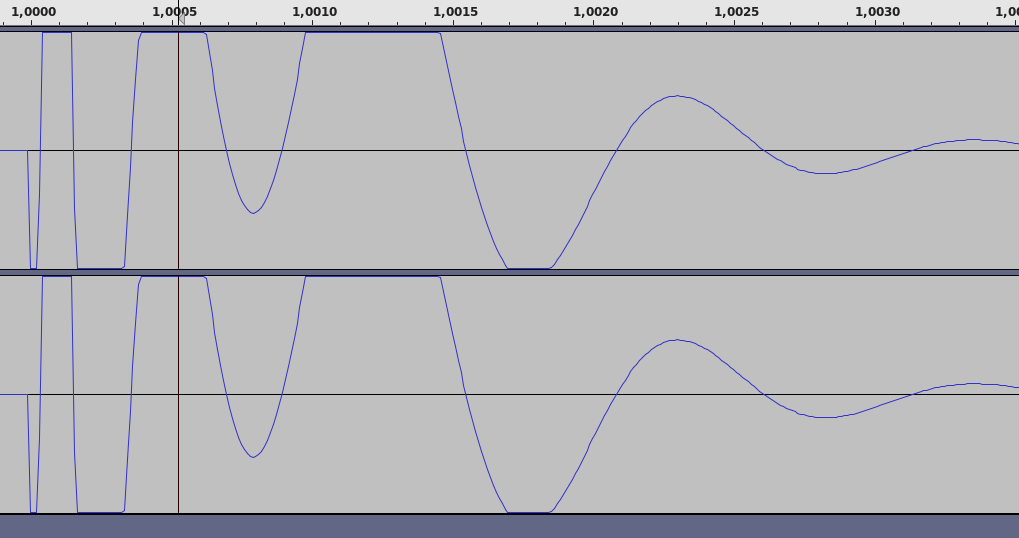

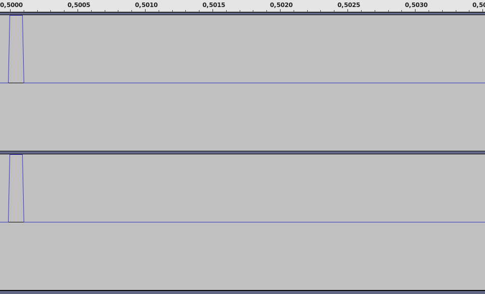

tried it on the laptop, cursorily I didn't hear differences at all.
what I notice is that it is a rather difficult/strenuous job for the analytical ear.
This is what happened:
Square_Impulse +20dB .wav
4 +20dB .wav

What did happen ? Maybe you could give a little more info ? I guess the first ones are the original rectangular pulse. But what do you want to show us with the second diagram ? What exactly did happen to the pulse here ?This is what happened:
Regards
Charles
I sent him the processed audio files for the rectangular impulse test so that he could play with them in Audacity. There is a description of each plot in a couple of words of text, just below the plot at the bottom left corner.
For some reason he added 20dB of gain to each one, so there is a lot of clipping. These are NOT the original signals from the test.
OK, thanks - that sounds reasonable. The temporal dispersion alone couldn't cause what is seen on the second plot.
