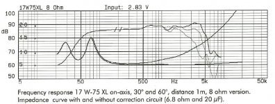

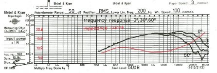

86dB, 5.1R DCR 8 ohm 6" bass and 90dB 5.3R DCR 8 ohm 1" tweeter? 15-20L box. Port about 2"x4". Bit of stuffing.
Looks tidy enough response. 5.1R/20 Ohms impedance at 10kHz on bass, so Zobel is 6.8/20uF by my reckoning. You could apply a notch around 5kHz on the bass, but that is component heavy. Attenuation on tweeter will be about 6.8R for 6dB.
How hard can it be? But I would use Lojzek's idea. I am sure he simulated the speaker. He knows Dynaudio stuff. All this 6dB slope stuff is just audio hoey. Doesn't work like that anyway.
