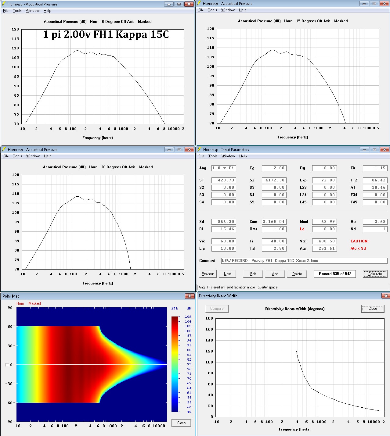

EarlK: Thanks for the info and the suggestion to get a USB microphone. Based upon the attached Hornresp sim (thanks Karlson3!), it seems that I could use a higher crossover than my intended 500-600HZ. This sim, combined with the frequency response contained in the RH SD1800 cut-sheet, would indicate that the combo would work at a 750-800HZ crossover point. My concern about the FH1/15C combination was that it wouldn't go high enough to crossover at a higher frequency, but the sim seems to indicate that it will. The RH SD1800 drivers will work better at that frequency as well. Do you think that, given the acoustic roll-off of the FH1/15C combo, I could use a first order crossover on the woofer portion, and a second order crossover on the 511B/RH SD1800 portion, both at 750-800HZ?

This simulation shows that your 16ohm HF driver ( 108db ) won't quite keep up with the woofer ( when passively crossed over + EQed for some linearity > though it's most likely to be close enough in the real world ) .
You can't design crossovers without having the actual ac impedances of the drivers in the horns.
REW ( or ARTA ) with a simple test jig can measure these impedances ( & then export the values as a .zma file to be used within network simulation software.
