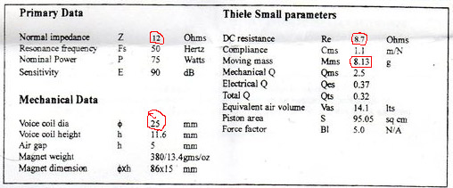

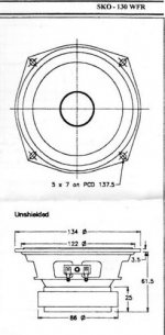

Yes I made there mistake too, that is 4ohm. I got the datasheet with these speakers when I bought them. Unfortunately, this was 4-5 years ago and I lost it. I sent an email to the seller (willys-hifi) , asked him if has the datasheet, once he replies I'll let you know, in the meantime, I'll keep searching for datasheet online.
Alright guys!
I found the 12ohm datasheet online! 😀
here it is!
If you want to download I've made a pdf: https://www.dropbox.com/s/7mwheqry4lif86s/peerless-sko-130b110-clone-12-ohmspairbrand-new.pdf?dl=0
here it is!
![814280-peerless-sko-130b110-clone-12-ohmspairbrand-new_zpsuk2qpwjs.jpg](https://i1360.photobucket.com/albums/r651/arminsalihovic/814280-peerless-sko-130b110-clone-12-ohmspairbrand-new_zpsuk2qpwjs.jpg)
![814281-peerless-sko-130b110-clone-12-ohmspairbrand-new_zpsjlck3kka.jpg](https://i1360.photobucket.com/albums/r651/arminsalihovic/814281-peerless-sko-130b110-clone-12-ohmspairbrand-new_zpsjlck3kka.jpg)

Accu,
by the impedance of your driver, one can only assume that someone
has messed with the figures to make it look like 12 ohm speaker unit
which apparently isn't. The font of the letters is obviously smaller than
original data. No way a 12 ohm unit would have 90 dB of spl half space.
edit: a 10 ohm version with 85 dB
http://www.peerlessaudio.com/prod_details.asp?id=104

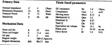

All a bit weird for the Peerless WKO-130! 😀
Very wobbly data. How did that happen?
Seems to me it's quite a well behaved 4 ohm 5" paper woofer. Nothing to do with 12 ohms.
Anybody want to sim it?
I get a guesstimate crossover a bit like the last image in 12L reflex. Be interested what you find. 🙂

Drivers are indeed 12 ohms with Re=10,5 but the datasheet is for a
4 ohm unit with numbers modified as already said. I suggest you download
this: ARTA Download and measure the impedance yourself. We could
guesstimate the spl curve of the Peerless being somewhat similar to 4 ohm
version with a reference level being somewhat lower than 85 dB. If you're
confident enough, you should measure SPL too. Read ARTA manuals.
