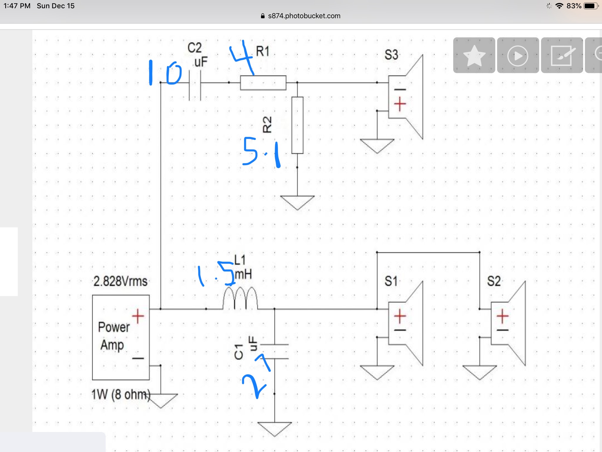

Crossover for 10” mtm
I’m posting this in response to Allen’s referencing of the speakers I’m building in another thread as an example of what can be wrong with a mtm! 😱
I'm building a $4000 speaker kit ... Which one?
Allen I’ll link the crossover for the speaker in question and maybe you can help me understand how to improve on it? Drivers are…..
https://www.eminence.com/pdf/Delta_10B.pdf
https://www.bcspeakers.com/en/products/hf-driver/1-0/8/de250.pdf
http://gpoint-audio.com/wp-content/uploads/2013/03/seos10.jpg
Good afternoon Bob, since you've chosen to pick that up I'll do what I can. It's necessary to know whether something can be done, or whether it should focus on smoothing what appears in the measurements. With what you've provided here I see some inconsistencies based on current information, and wonder how does the SEOS manage its vertical directivity (*). It's best that I keep this theoretical for the time being.

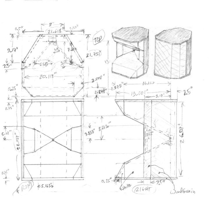

The first part of crossing is acoustic. The two Ms are producing an asymmetric radiation pattern. The waveguide needs to match this and at the same time keep the crossover frequency the same for vertical and horizontal. Unless this happens then there may not be a proper electrical crossover available.. There may be wiggle room if you can determine a reasonable compromise.
* Using conventional techniques virtually the entire waveguide design can be derived from these constraints. It won't be flat on the front. If you design a waveguide more narrow than another, but for working down to the same frequency, it will be taller and longer. Here is an example - Square Pegs

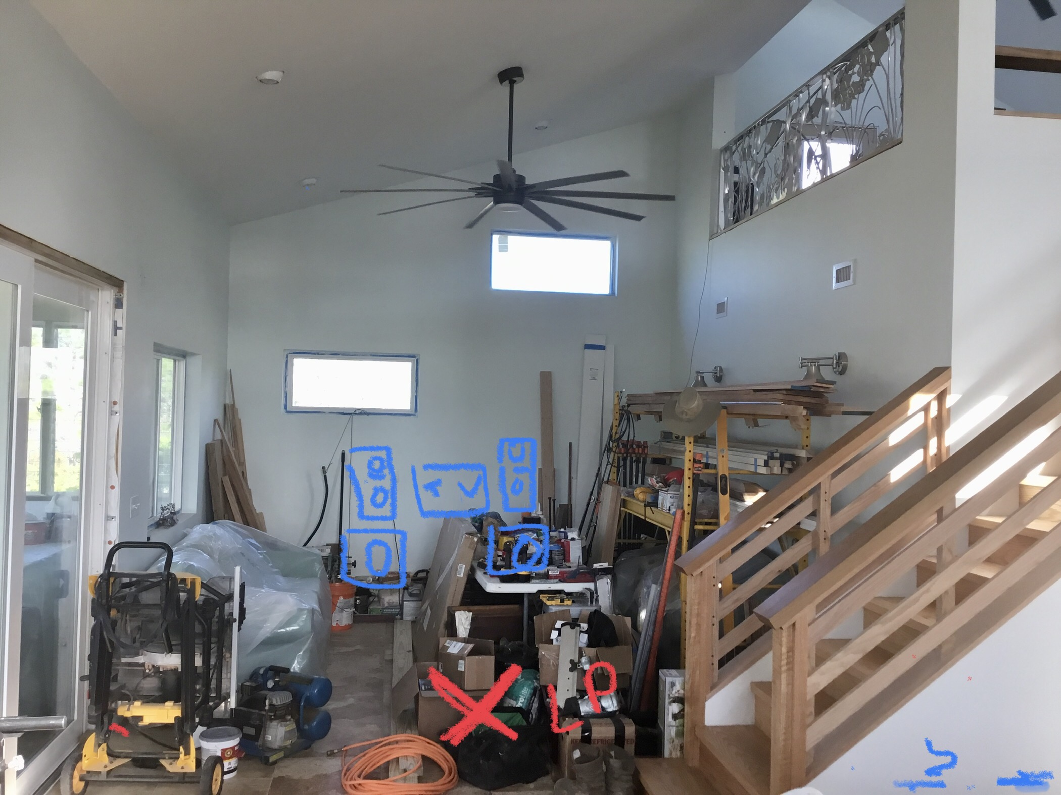

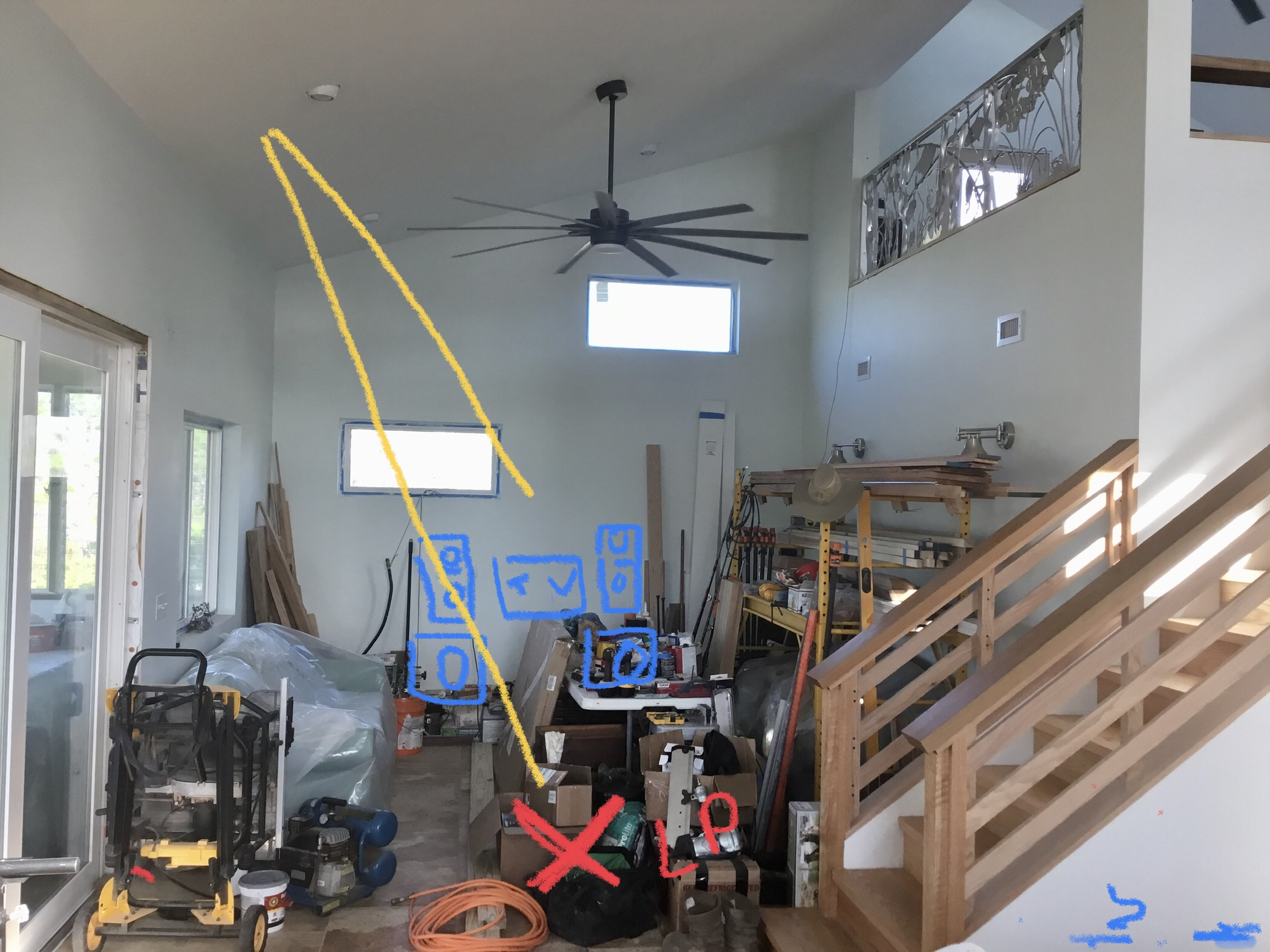

“It would be interesting to know the ceiling angle”
I forget the exact pitch of that roof but it’s roughly 22 deg.
Just measured more exact…..Room is 13’6” across front wall x 30’ to rear wall, 9’6” tall left wall, 14’ tall right wall (open to loft at top) then open to kitchen around the stairs. (See pics) don’t mind the mess….still working!
LP will be centered roughly 9’ back…..that will place rear wall 21’ behind listener.
Deal I made with wife is that I can do whatever I want with that front wall and out 30” nothing out in the room (subs etc), no room treatments. (Although I am in negotiations over curtains on the left hand window and a tapestry on the right hand wall) 😛

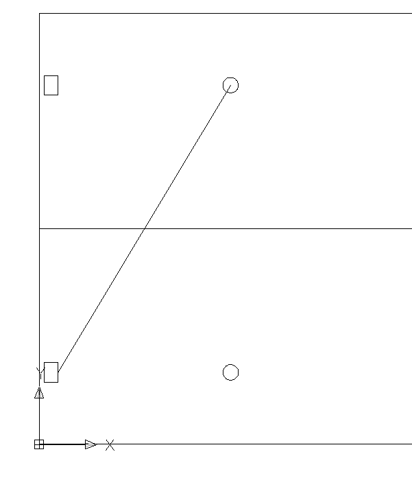

In any case, I meant the angle off the speaker for the reflection. If you put a mirror on the ceiling, which way is it looking at you. (Granted each side will be different, you're after the smallest angle of the two.)

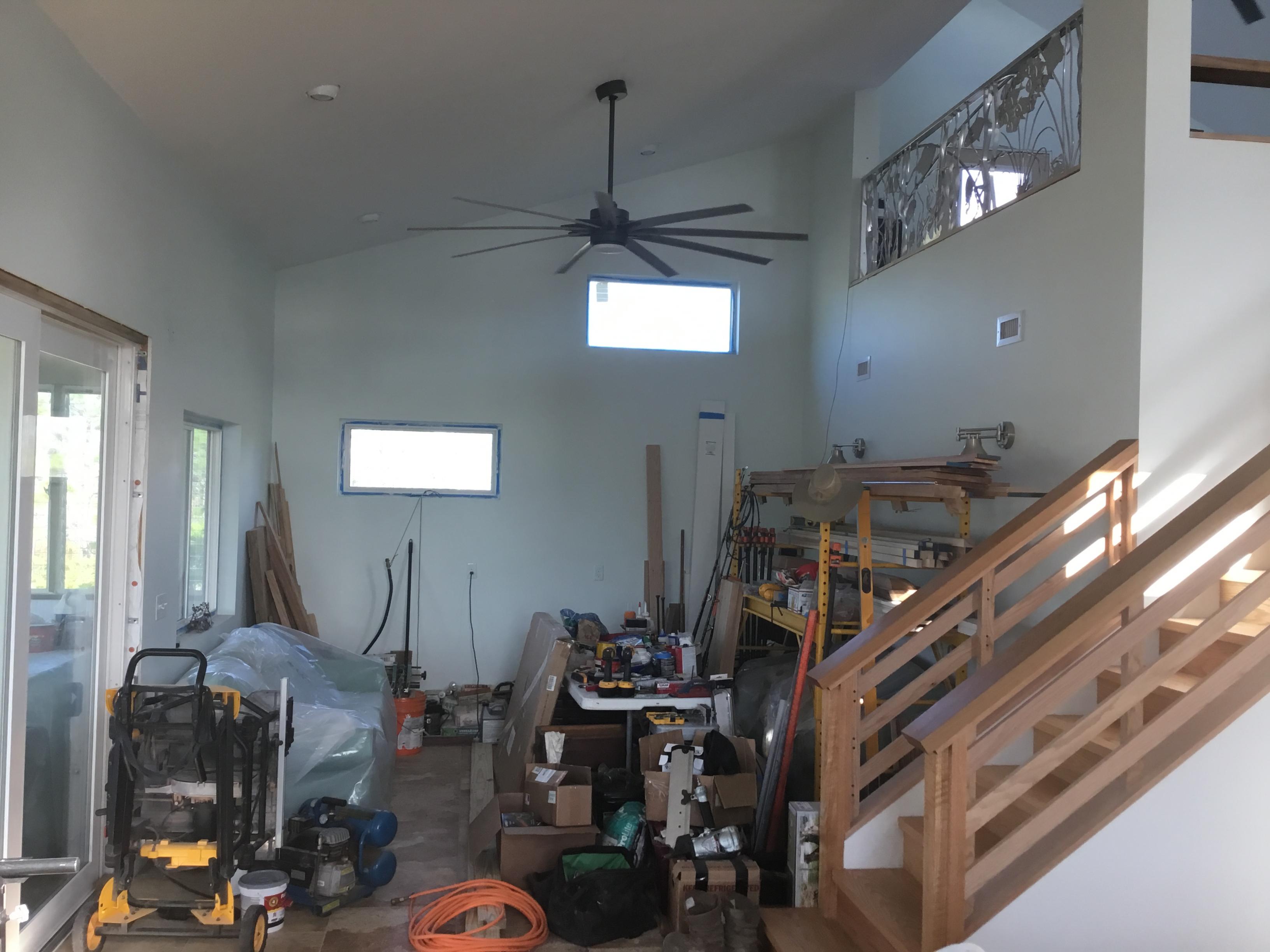

I think I’d only be able to ‘see’ the right speaker (if at all) in that scenario only if looking far fwd/left. Angle would be roughly 45 deg. Maybe less.
Edit….I know that looks more like 22 deg but it compressed by the viewpoint of pic
If your angle is 45 degrees, or even better 55 degrees then it justifies a standard 90 degree design, so it helps define the speaker you need. Another variable in this is where you put the speakers which is going to depend on other properties of the speaker and the room.
