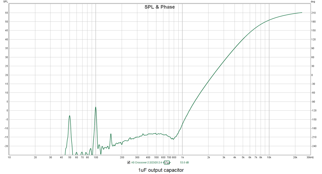

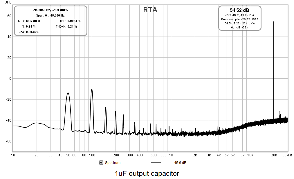

Amplitude vs frequency with 1uF output capacitor.pngRTA with 1uF output capacitor.png
According to the REW RTA plot the 100Hz is now 65dB below the 20kHz test tone and the 50Hz lower still.
Now I just need to see what's the lowest value of output capacitor I can get away with.
Trying a much larger capacitor was indeed the solution.
The filtering is done by the filter, the output capacitor doesn’t - or shouldn’t (thats bad design) contribute. The bigger your output capacitor is the smaller it’s resistance at low frequencies and thus the better it is at shorting out low frequency interference.
Yes. Noise deteriorates significantly with 0.1uF and is even better still with 10uF.

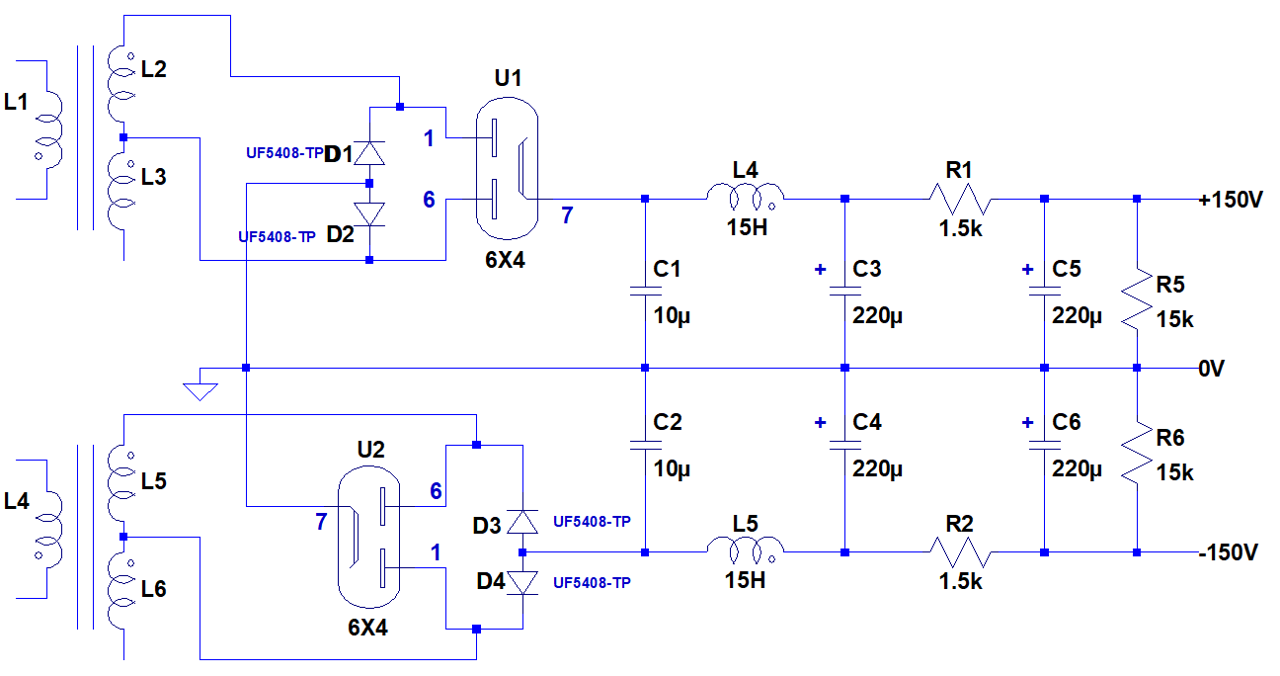

There's a 15H choke right under the filter board in the power supply chassis.

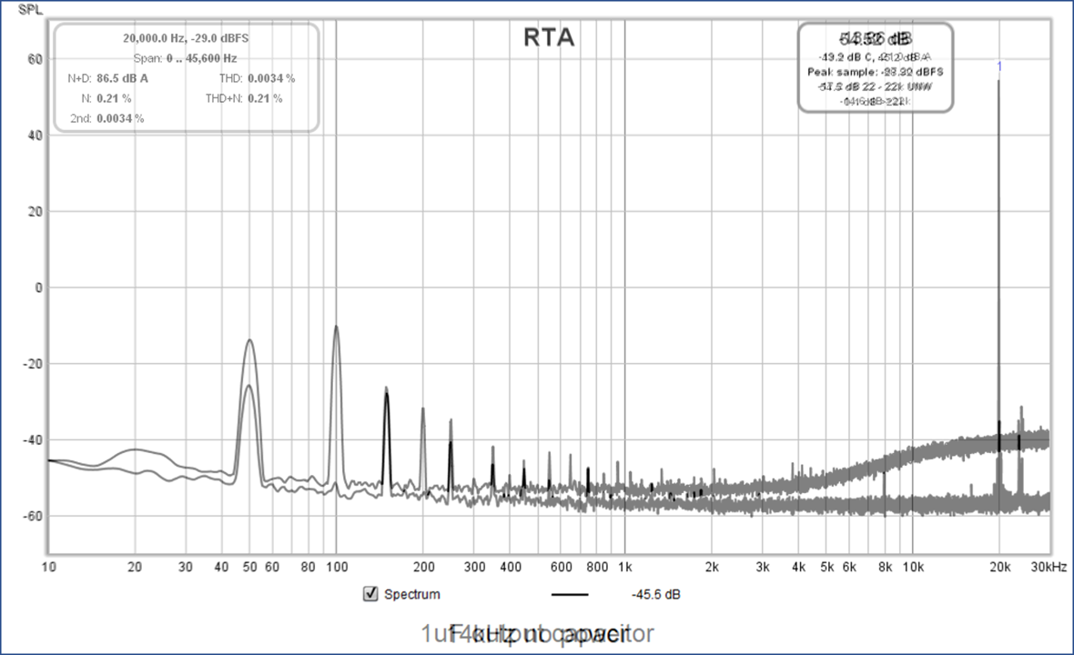

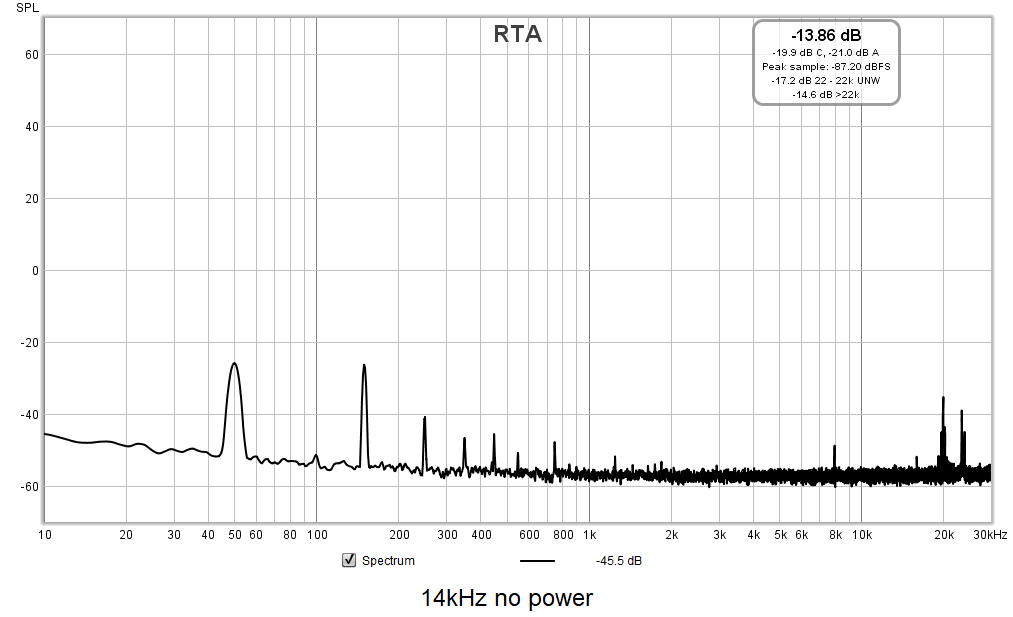

I've attached spectra with power off and power on.
Most of the 50Hz is environmental. 10dB to 15dB is contributed by the power supply.
All of the 100Hz is contributed by the power supply. 40dB or so.
150Hz is the same. 200Hz is the power supply.

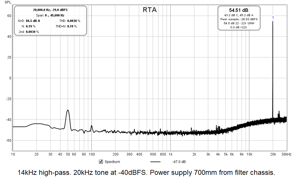

I wondered if that was generating the magnetic field - its should not as its just passing a constant DC current. I just wondered if you could move it out of the way just to test. The line output transformers are a bit 'old school'. There's a lot of stuff which is much better screened against magnetic interference. You do need the turns ratio as the 12ax7 will have trouble driving a 600R load at line level directly.
What a difference!

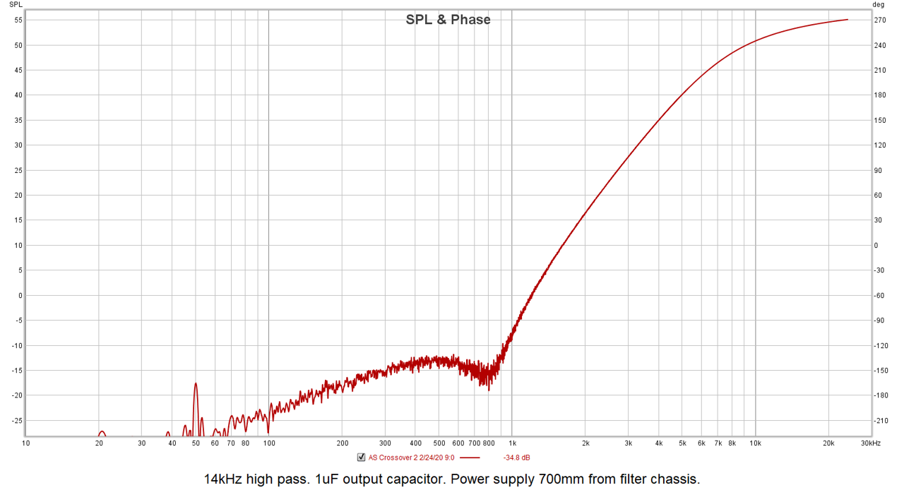

Moving the PSU chassis out from under and 700mm way (the length of the umbilicals) made a HUGE difference!
Amplitude vs frequency with 1uF output capacitor PSU chassis 700mm from filter chassis.pngRTA with 1uF output capacitor PSU chassis 700mm from filter chassis.png
