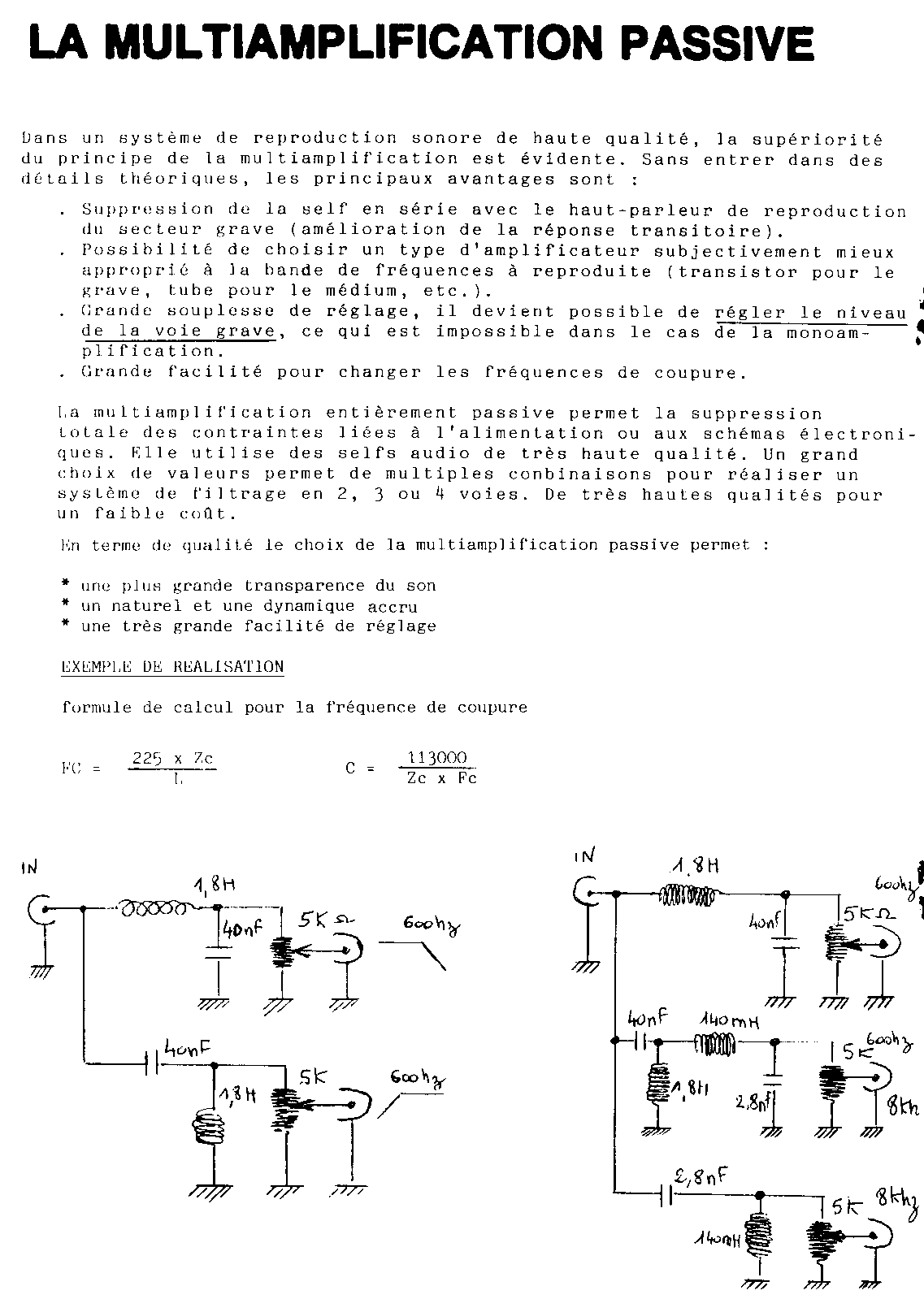

Hello,
This is what the French did some decades ago. It is kind of copied from American audio magazine dating from the sixties. Where they used peerless? adjustable coils. It was also described in Sound Practices magazine.
greetings, eduard
greetings, eduard
